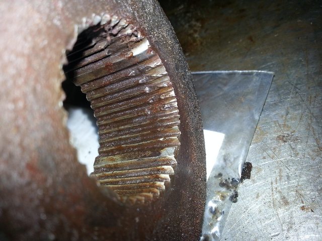

Shoot some WD down into the spline, if the noise stops, thats your issue.
Mind you, mine did not squeak, but it was always getting a misting of oil from my lower boost boot, but this is how mine looked. Very danger
