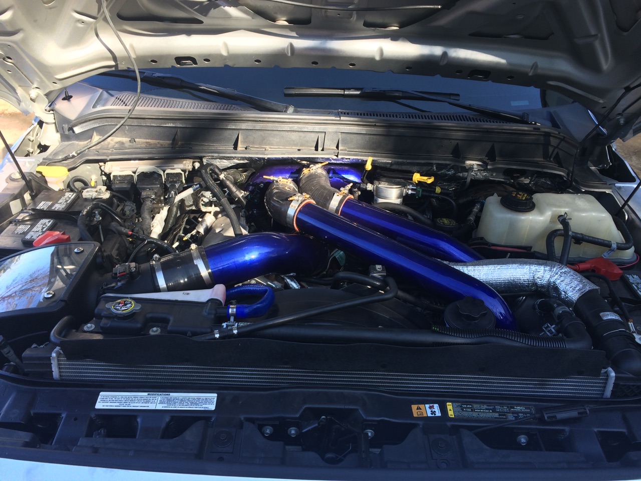

Our kits will be ready to ship next week. Direct as factory bolt on fitment with all the SX-E options in stock. We'll send out official release to all our dealers and public release as soon as the last piece of the puzzle hits the shelf.
HS-MotorsportsZane
Aug 8, 2013
469
A few pics of the new kits.....

I can tell you right now that a great deal of work went into insuring that our kit would fit the new turbos. We had to make physical changes to it to meet our fitment standards. Part of the reason that it has taken some amount of time to get it out.

It looks awesome Dallas! Can definitely see the time and effort yall put into this product!

I have the H&S Motorsports 369 turbo kit with H&S Motorsports dual fuelers on my daily driver. I personally think it's a great overall setup once your transmission relearns itself with the turbo. I've towed around 17k up some steep long hills in California with the setup and it does very well.
The kit itself was very well put together and bolted right up after the pain of taking the factory turbo out.
