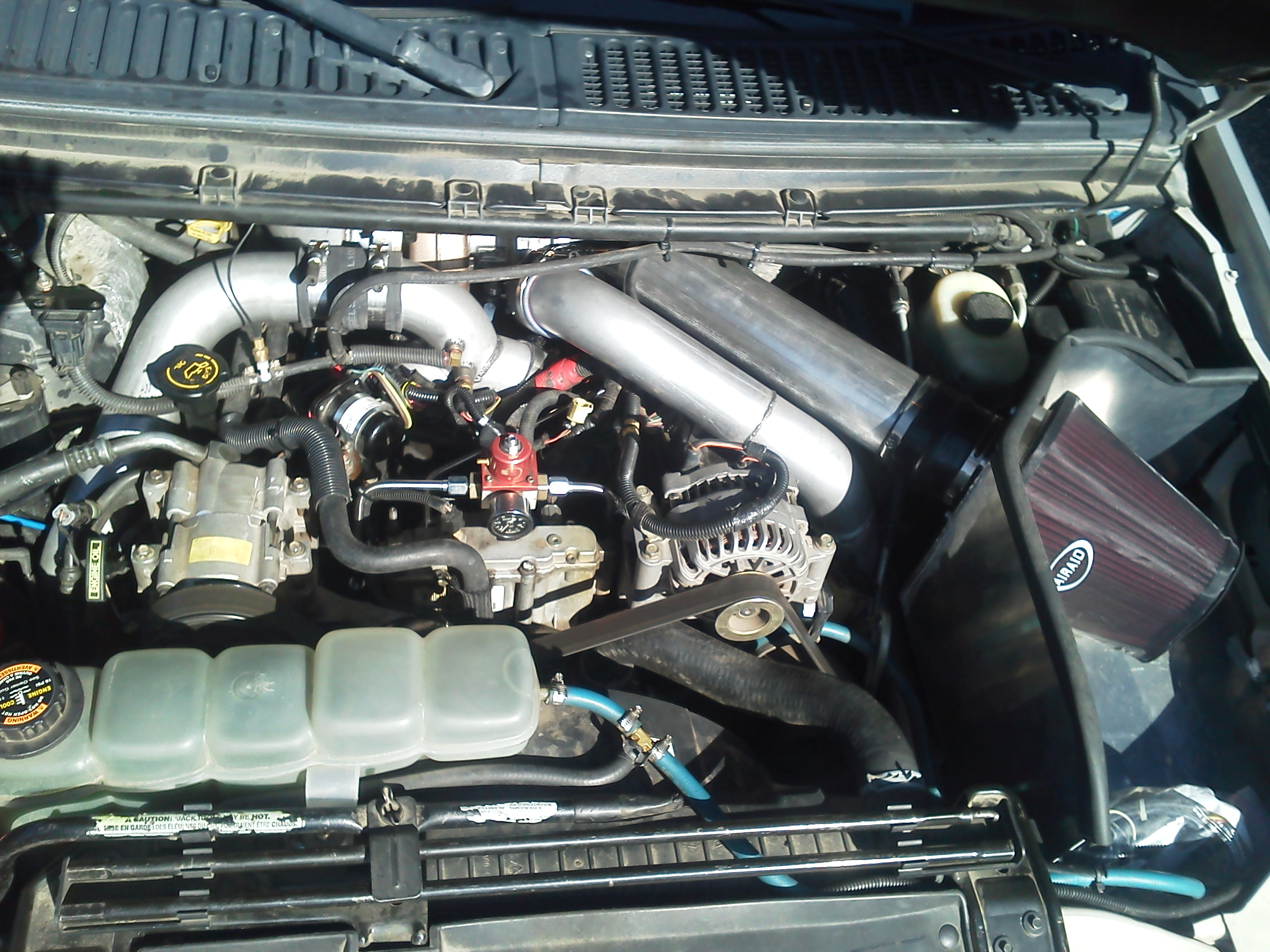

Justed wanted to say thanks for the great service and craftsmanship on the parts from Irate Diesel. Jake has been top notch to work with. The turbo with stock injectors is making 38 lbs of boost and there is almost no turbo lag at all. All I can say is after driving this truck for almost 12 years now it is like having a new truck again.
Irate Bell option turbo,T4 mount, head studs, uppipes, intercooler pipes, irate duel fuel filter kit,adrenaline hhop, stainless steel fuel hard lines with regulated return and fuel tank pick up mod. Jake contacted Cale from Tyrate Diesel for the tunes on the Tony Wildman 6 position chip. Also installed engine and intercooler boots from The Diesel Site. I fabricated the air box for the turbo install. Also have a pacbrake and msd digital propane injection on the truck with some upgrades to the 4R100 transmission.
Thanks again Jake.
Here is a picture of it installed

It is a S300 based charger with a custom high flowing compressor wheel. Was looking at a different charger but Jake talked me into this one and I am very happy with it. Jake told me it would be a match for what I was doing just amazed at how fast it spools. Egts have dropped 200 to 400 degree's depending on chip settings.
bigjake0524
217
This is the LASB turbo which flows 1200cfm. So it is a fair amount of flow over the standard 66 wheel that flows 1100cfm. We've been having very good luck with this turbo, it performs very well.
