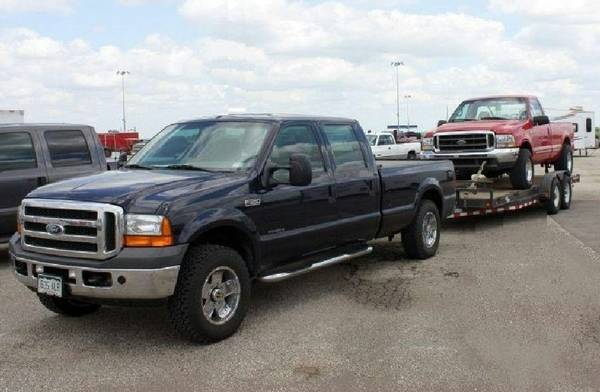

Hello guys and girls I just bought an 01 F350 CCLB and it's going to be my new tow pig. I am looking to get a little more pep out of it without going crazy like I had done with my 97.wanting want to have to worry about problems with it as it will be my DD. Any advice would be greatly appreciated.
