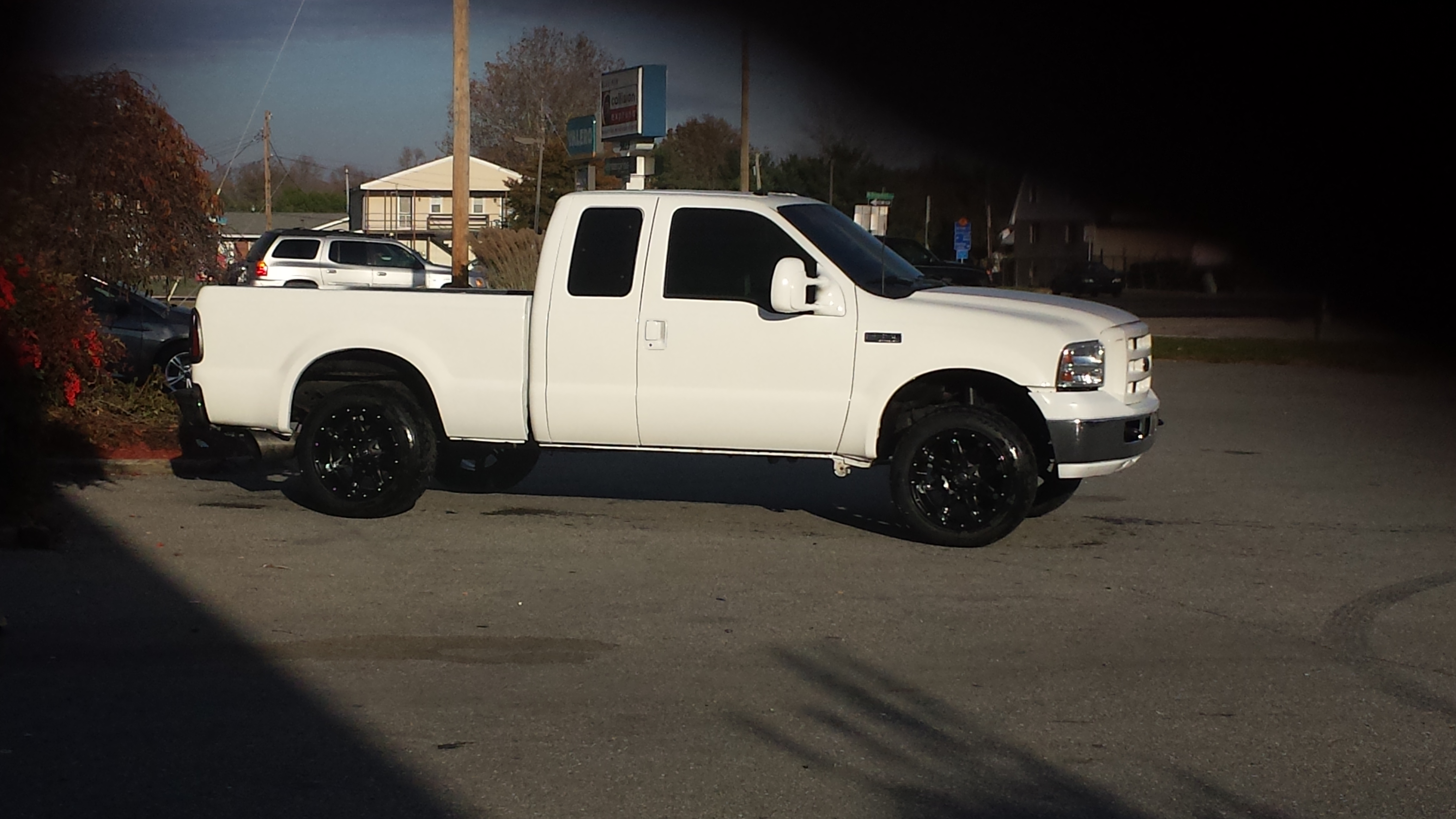

Attached is a pic of my beauty she was a teal rusty turd last year with no steering or glow plugs when I got it. Come along way new door rockers cab corners and paint
