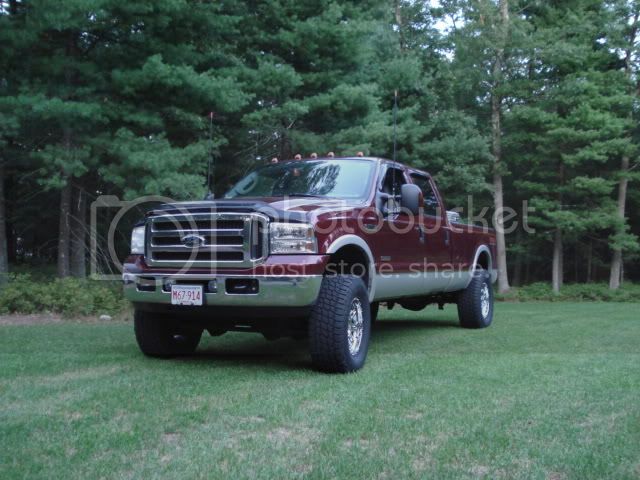

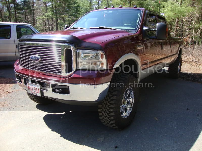

I would say its a noticable difference, not much but certainly noticable when its your truck. I must say I am much happier overall with the toyo's than the nittos, only got 40k out of the nittos and I am over 40k now on the toyo's and they have tons of life left in them. Plus I have gotten way more comments on the truck since the tire change.
Also my rims are 18x9 the width will effect how much bulge the tires have, the 325's had a good bit of bulge to them but never wore funny
Doesn't seem all that noticable in any pics but maybe these will help you out decide...
Best I can seem to do for pics
325/65r18 Nitto Terra Grapplers
35x12.5R18 Toyo MT's
Thanks Josh. The Toyo does seem a little more narrow, but I like the tread pattern on it a lot more. Really gives the truck a different look.
