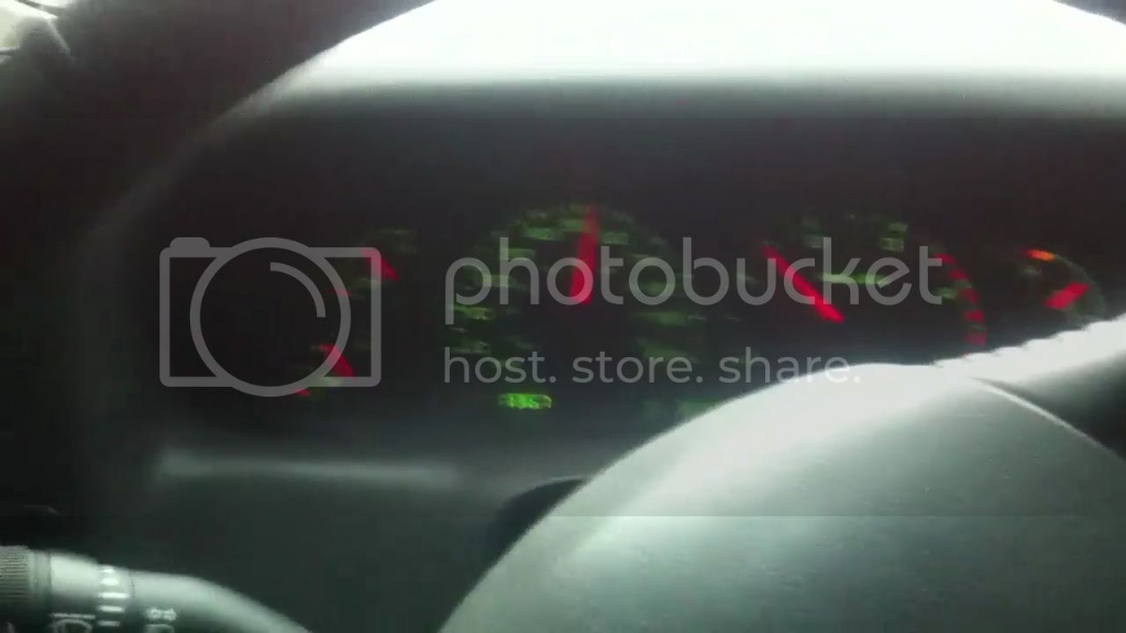

So yesterday I was towing a 16ft trailer loaded with about 3-4000lbs. I started getting a vibration and loss of power! I pulled over, turned off the truck checked the oil, all was good. I started back up and rode home no problem. Now today I'm driving with the trailer empty and it's wayy worse I vibration is getting worse, and I can't go much over 50mph. What's going on with this? here is a video maybe it will help.

no video... explain the vibration and power loss. Drivetrain or engine vibration? Did the motor start missing, dropping cylinders, etc?

The vibration feels like a motor vibration, sounds like it could be misfiring, but I've never had a car misfire, or drop a cylinder. As I drive around town under 50mph it's perfect, no issues. The power loss, is like as it vibrates, I hit the gas harder and the vibration gets worse, but I can't accelerate I just slow down. Ill post another video
