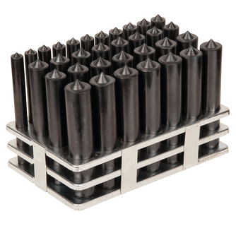

No issues with the OUO traction bars and Titan Tank.
Get yourself center punches so you locate the holes exactly. Good drill bits help also, not some HF crap.
