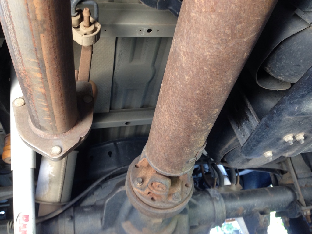

I have a monster k5la train horn and I don't want to remove the spare tire. The original plan was to cut the bottom of my tool box but I really don't want todo that sense it's brand newy. So I got to looking online and I found a separator kit that separates the horns from the manifold. There's the big space under the bed above the axle. So, my question is does the axle and drive shaft move enough that it would come into contact with the horns if I mounted 3 of the 5 trumpets there?

I thought about there but these are some high $$ horns and I don't really want them to be seen at all unless I show someone.

The only way to see them is crawling under the truck or sticking your head in the wheel well.

Nice shockers. They r loud as hell. One of my fittings just broke though so gotta send it back :/. I mounted mine in that same spot but did 2 and 2

I'll have to make a bracket once the separation kit comes in so I'll get a more detailed look. It's hard to get an idea trying to hold the horns up haha
