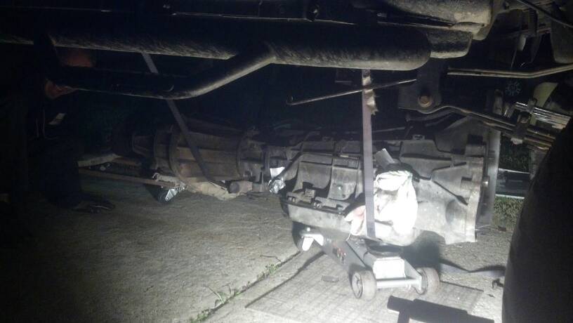

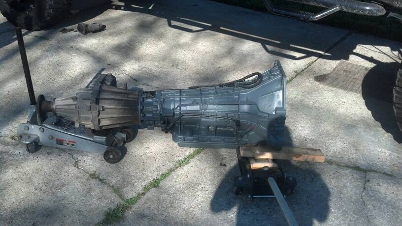

Well the tranny is 3 months out of warranty. After some ass chewing Jasper agreed upon sending me a new one free of charge. It will be delivered tomorrow. So tonight the tranny will be pulled. And vaca will no longer be postponed. Will post pics later.

Sent from down south.
