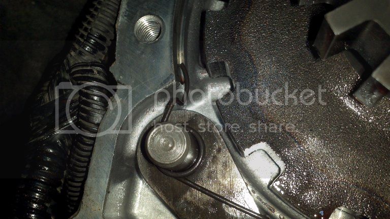

I dropped the case and out shot the pawl... The spring looked like it was broke on the one end, but it only fit into the case one way... I hope it went back together like this...
thanks again also
91turbogsx
1,554
Gardner MA
Mine didn't pop out. And I don't remember how the spring went in since I didn't really pay attention to it. Yours looks right to me...
