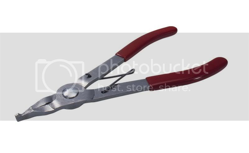

Hey Dave, what type of snap ring pliers would you recommend for those annoying snap rings with no holes?
91turbogsx
1,554
Gardner MA
Yeah. That'd be a lock ring plier. Should work for you if i'm envisioning the clip you are describing correctly.
