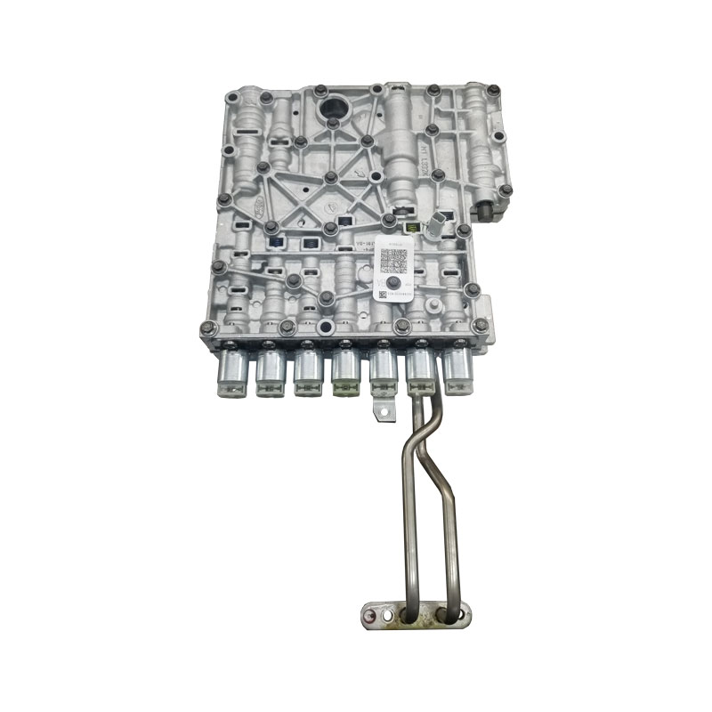

I have a 2011 f350 bone stock. Having issues with tranny it skips/hesitates going from 3rd to 4th gear. Does it hot and cold. Put two new batteries in it which seemed to have helped a bit but I’m still noticing it. Aside from the basics of checking the fluid level and condition any other ideas what to test? I do have access to autoengenuity, autel and forscan but didn’t see any trans related codes? I’m thinking maybe valve body? Any help is appreciated

Sounds like the valve body. Most times though they have a hard shift at town speeds.
If you have access to forscan do a trans relearn and see if that takes care of the problem. If it doesn't I'd be willing to believe it's the valve body/solenoid.

Well I did the reset and if anything it seems to have made it worse. Driving through town it shifted hard into second then slipped and rpms revved up before shifting into 4th. Any way to confirm it’s the valve body. Would hate to spend the $900 for it to be something else.

First, how does the fluid look and smell? I just went through a v/b issue. I had to pull mine and repair the 2/3 valve. It was hung open. No codes associated .

Reset the tcm and have been driving it. Seems To be shifting better the more I drive? Fluid smells normal not dark or burnt either
