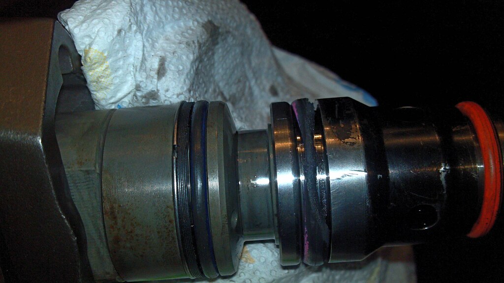

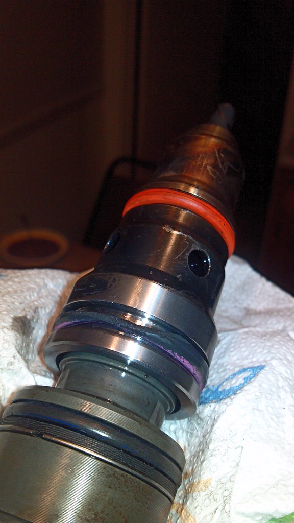

I used there injector o rings in my 7.3. Have 3000 miles on them and one is leaking. Thinking I caused it. Will know tommorow.

These have 3000 miles of mild driving and 2 dyno pulls. They are VR's
I have a set of Fords coming from RiffRaff to replace them. Also Autozone where I bought them is refunding them as well.
