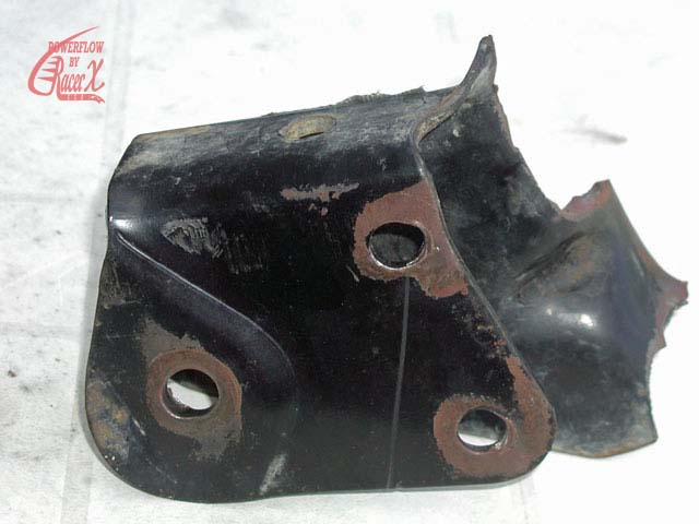

Below is a photo of an uncommon cause of vibration after it failed-- a D-50 axle bracket. :priest:
It would only cause vibration on certain roads. This one wasn't torqued to spec on the assembly line. The washer style bolt heads and nuts hid any visible signs of it being loose until the broken bracket was removed. Note the oblong holes and the wide pattern left by the washer style fasteners that hid them.
I think it's a good idea to check the torque on the axle brackets on the Dana 50 regularly. LOL :D :)
