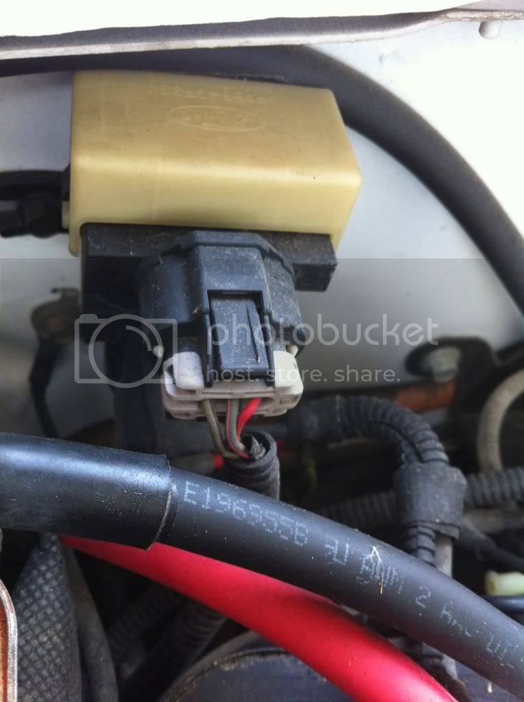

And these are the vaccum lines at the bottom of the solinoid. Plug the one with vaccum.

i have no leaks in any of the vaccuum lines. Everything works great when in 4x4...both the heat and A/C...no issues with anything. However if i did aquire a leak...i'm assuming i just plug one of the two lines that was pictured that connect to the 4x4 solenoid...correct? If so, i also assume it'd be the one that goes to the hubs? The lines that were pictured...is one line going into the solenoid and the other going out to the hubs then?

you would want to plug it before it goes into the solenoid valve on the fender
(that is the solenoid that varies duration and vacuum signal strength to the hubs to tell them to lock or unlock )
that would get all the unnecessary vacuum lines deactivated and avoid any future issues
A golf Tee and your done lol

ok thanks. I was gonna ask ya what would work best to plug the rubber boot on the line haha. Golf tee it is then lol. What would be the best way to test vaccuum to see which one of the two is the vaccuum line? Can i just unplug one and put my finger up to it and see if it sticks to my finger from suction? Assuming it needs to be in 4x4 tho when testing vaccuum.
G Racing
1,643
Southeast Texas
You can start the truck and unplug the the lines. You will be able to feel which one has vacuum on it. I would just plug both to keep crap out of the other line.

but it's the one from the vacuum pump going into the solenoid if you can see it?
but I like the idea of plugging both
