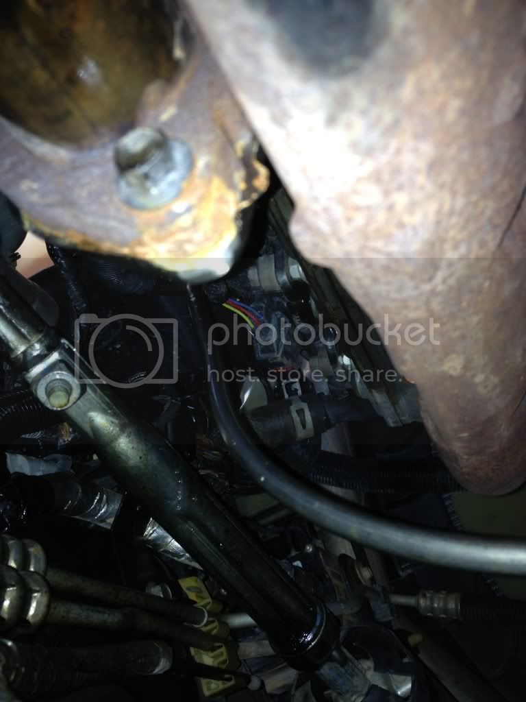

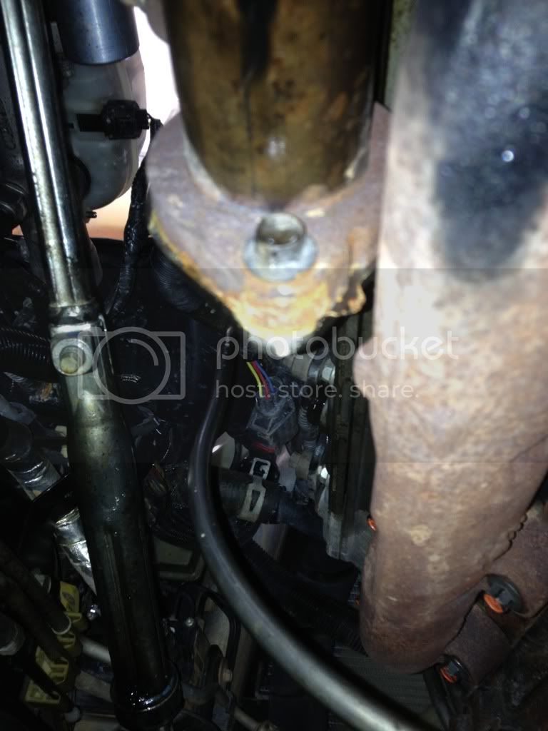

Little update
Did a full egr delete, polished elbow and CAC pipe, and a sinister coolant kit.
Now it's leaking oil from the bottom of the valve cover. You can see in these pictures. Directly to the right of the red, yellow and blue wires. Looks like a little rubber gasket of some sort. Likes really black in picture.
While truck is running its blowing smoke/light haze from that area. Looks like the same color as what's coming out of the CCV pipe I ran down the frame.
Also it's leaking coolant from the overflow from the fuel cooler. I sucked some of the coolant out and replaced with new, filled up to the sight glass. Any ideas on this one?
