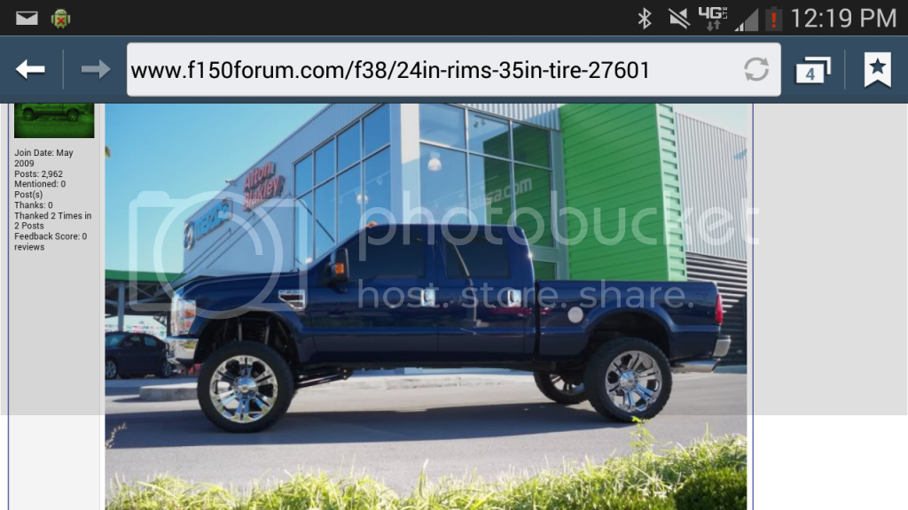

Hey guys, Looking for tire ideas in the 35" ish tall tire that will look good on a 14" wide wheel by 24" tall. Hard to find a tire in that size... Any pics on here of a 12.50 or 13.50 on a 14 wide? Wondering what can be ran that will still look good. a 35 15 24 would be the best option but may not be available..

I have the terra grappler now in the 315-50-24 but ide like a tire closer to a 35.. I really want to switch to an American Force wheel and the 14 wide just makes me creame right away! To the guy that posted the truck above, what tire is that? 35-24? The problem with even my 315-50 is that im not sure its wide enough for the 14s, plus I was thinking of something a bit more aggressive this time around.

The wheel isn't my problem, its finding the right tire! Seems like a guy has to run a 38"+ tire to get in the 14-15" wide sizes.. Why cant they just make a dam 35/15/24 lol
