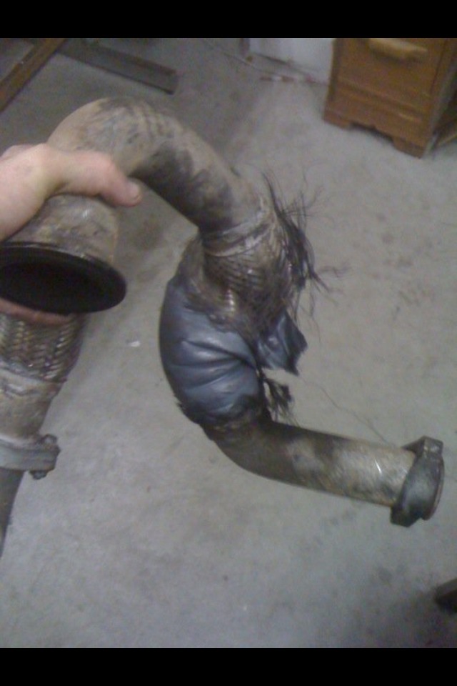

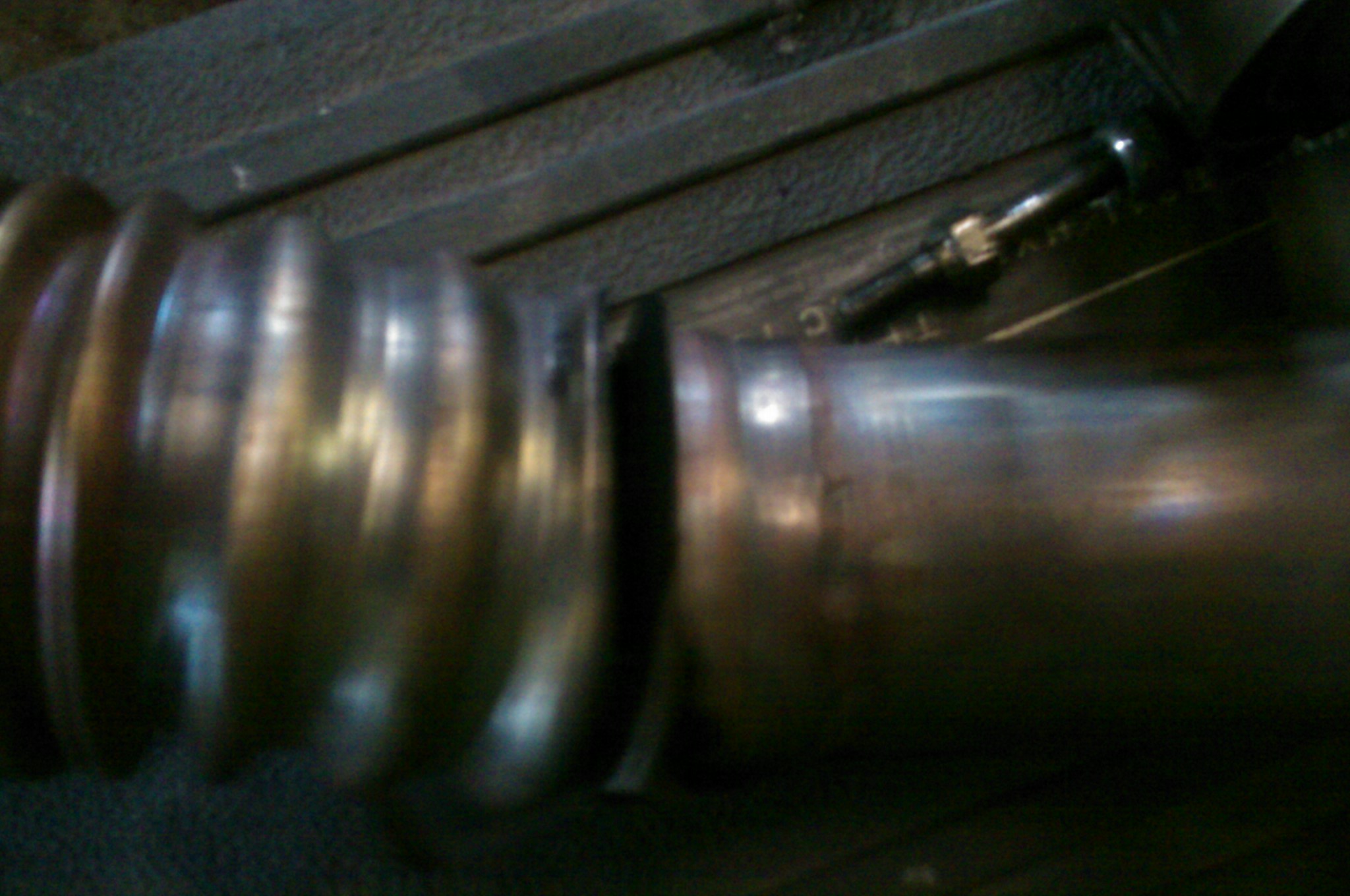

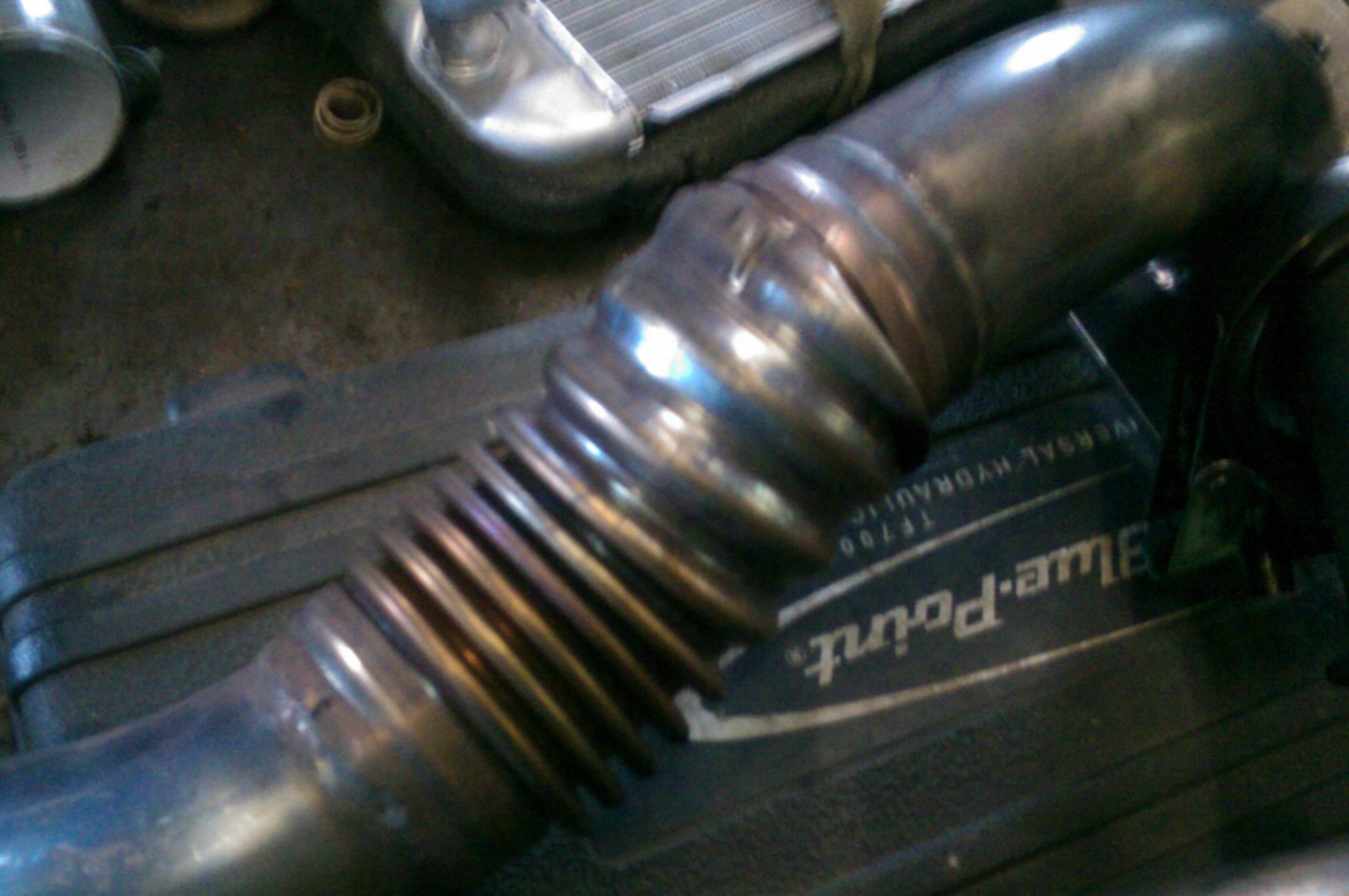

heres some pic of what happen

I dont like those style bellows, I'd redo them with better bellows and get a gauge on it before spending money and pointing fingers. that housing and turbine is a good match for that compressor wheel size.

They are triple breaded liners the old ones have held fine up to 55-60 psi but my quess is back pressure is a little high lol

good gosh! thats some serious heat and bp. never seen up pipes like that before but then again never seen hybrids run with that style charger either

Here's one I blew up a long time ago, that was a vibrant bellow. I built another set of up pipes with new vibrant bellows and haven't had a problem since, it could be that I'm not running the 430s anymore too LOL
It'd probably be a good idea to put a bp gauge on and see what its doing.
