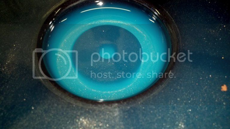

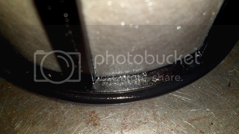

Everytime I change my fuel filter I have this debris laying atop the filter. Is this the fuel pump going out? I have awesome fuel pressure at all time.

Do you have a pre-pump filter in the system, or just the bowl filter?
If you have a pre-pump filter, have you cut it open to see if any of this is in it too?

No pr-pump. Have been putting it off. I might run the pump out of a bucket and drain into a bucket. See if it is the pump itself. Can't think of anything else that would cause these pieces.
TARM
2,439
No way to tell without a pre pump filter on there as that will let you know if its in the tank or the pump.
