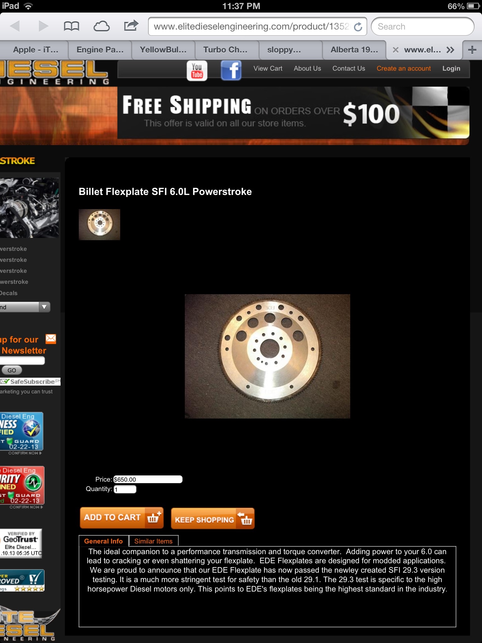

Here is what Elite's add says about it...
...gonna have to ask about the free shipping for all items over $100.00

That's cool and all but I'm one of those who wants to know what 29.3 vs 29.1 means? I tried searching for it on SFI page but got bored after a few minutes trying to find it and detoured to the forum. It's cool Elite's product is at the top in terms of SFI safety but I don't know what 29.3 means compared to 29.1. lol. Maybe someone from Elite can jump in here and explain that??
