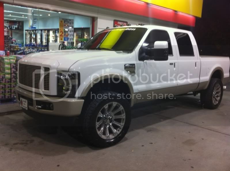

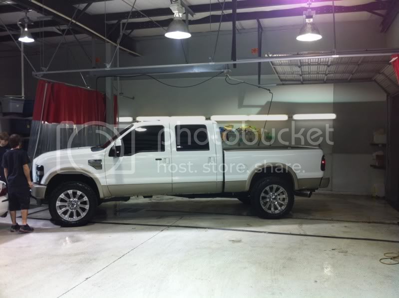

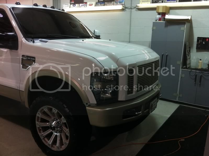

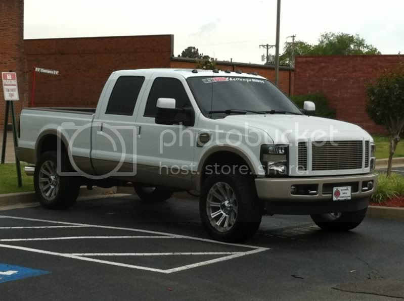

Found a sick deal on some 22x9.5 wheels with a -6 offset and was planning on running a 325/50R22 with them. Was wondering if they would rub on a stock height f-250? Thought I would check before buying...

You'll need at least one inch of lift up front and a good bit of trimming on the liners.
I have the same exact offset, wheel dimensions, and tire size with my current setup. I run the Icon TEI 1 inch spacer in the front and a stock 350 block in the rear.
What wheels have you found?
Below are a couple of pictures to give you an idea of what yours will look like. Unfortunately I cant find any shots of mine straight from the front or back to give you an idea of how far they stick out.
