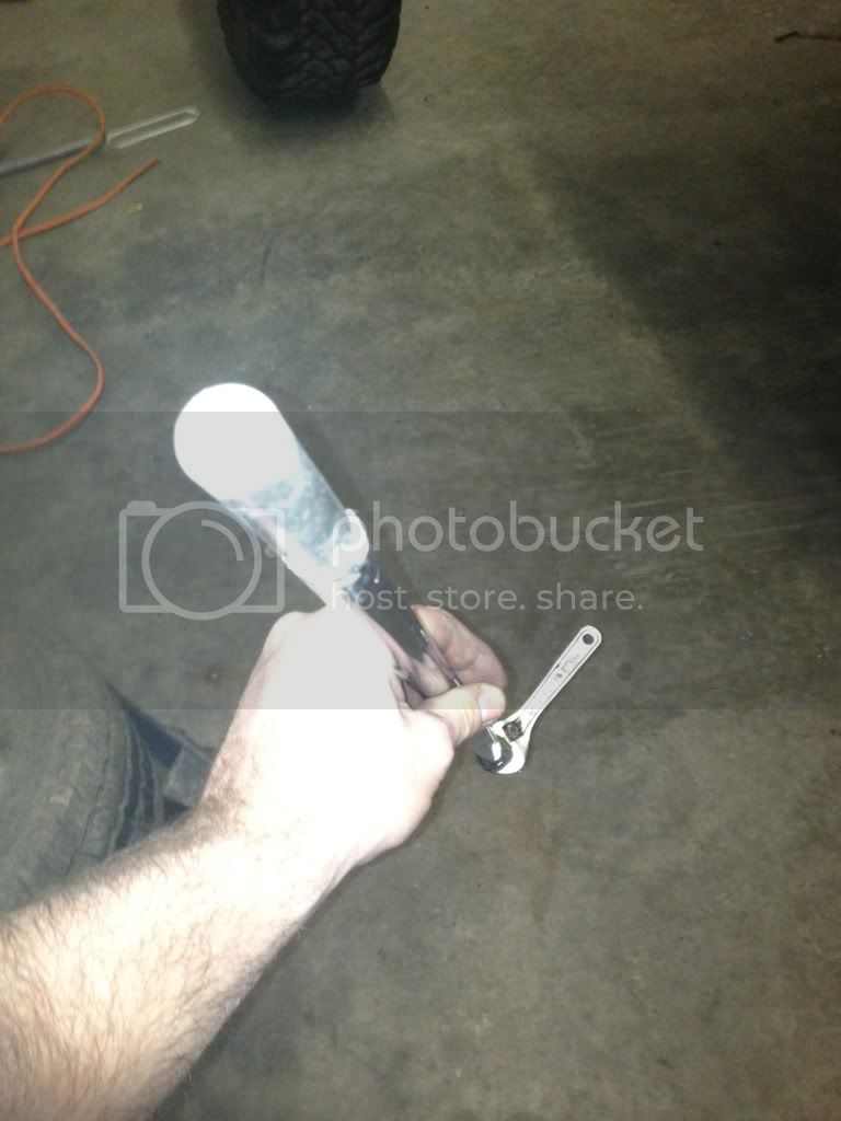

Welded the key in the glove box to a little tubing I had laying around and a broken small adjustable LOL .
edit Saw you didnt have a key. find a bud or another ford dealer.
