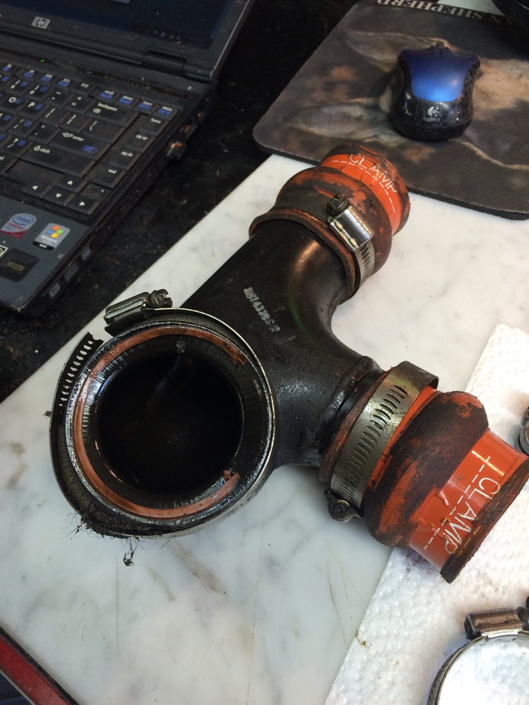

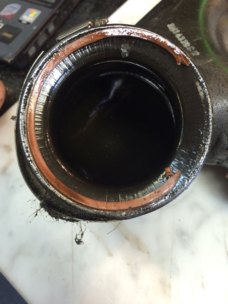

I took this off to replace the rubber fuel lines for the pump
And it looks like this small orange gasket is broken...
What is the technical name for this I want to see if the dealer has it in stock
Thanks

Dont know where you could get it i have one from my 97 its yours if you want it... But go get a pice of rubber the right thickness and cur you one out till you get the right one.

I guess I can make one ...

Turbo outlet o-ring.

Factory part is F4TZ-9E436-A. You could probably get away with using the oil filter seal for a 2002 Honda Civic 1.7L VTEC. It's a little thicker, but same dimensions otherwise. Cheers!

Thicker would be better.
The one I got from diesel orings or RiffRaff was kinda thin. Think it was a round oring vs the square cut.

I see your in CT try calling Gabrielli international in Milford I have picked one up there before or any ford dealer in the area will have it next day

You are the man, Patrick.... Always a solution! Where do you store all this info, like your hard drive must be so organized... lent out my spare to a local shop here in town and they where to replace it, I can now refer them to your info next time they call.

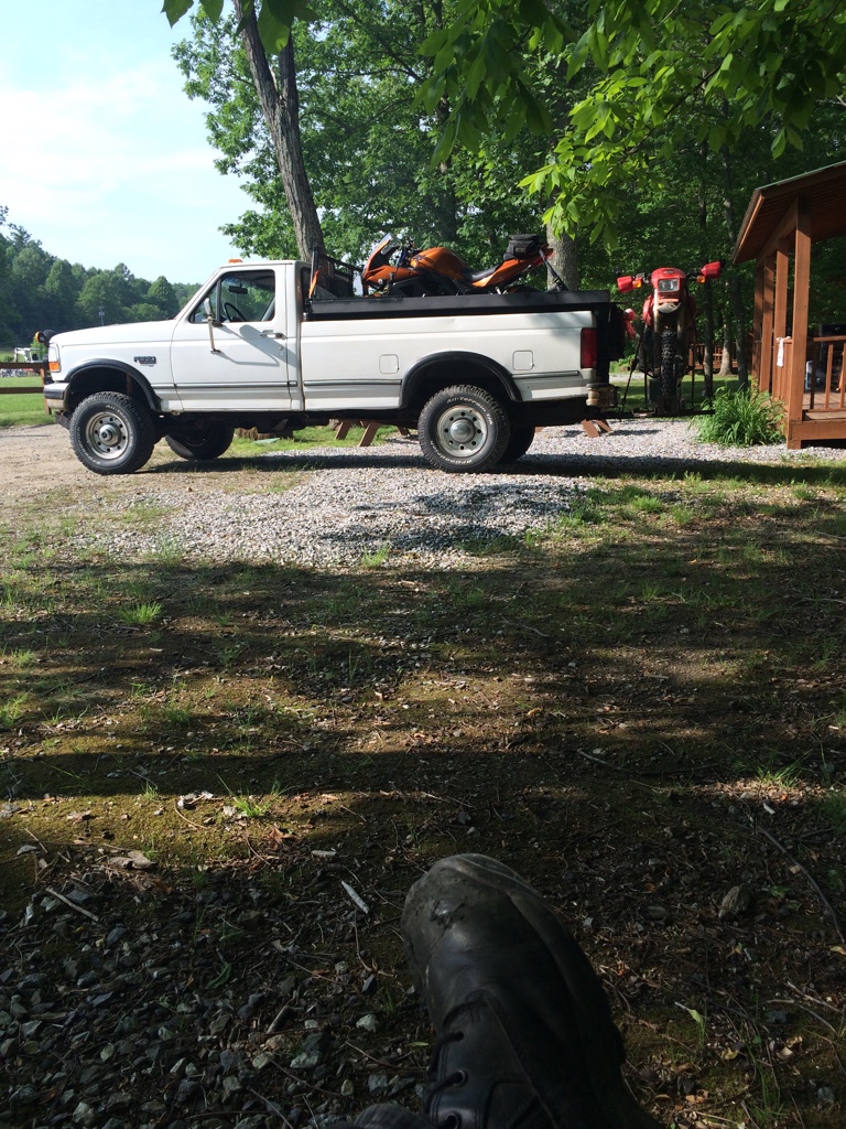

Just an update
I must have been leaking boost from that gasket being screwed up
I just got back from a trip to Georgia and back
The truck pulled like a raped ape... With two bikes in the back
Noticeable difference.
About 18 mpg.
For 2000 miles
