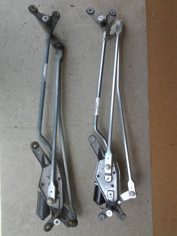

Finally got it replaced. New motor came with the entire assrmbly.... $150 shipped including $35 core deposit and return shipping. (Autofair Ford)
Haven't driven in the rain yet tho.
