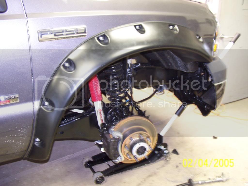

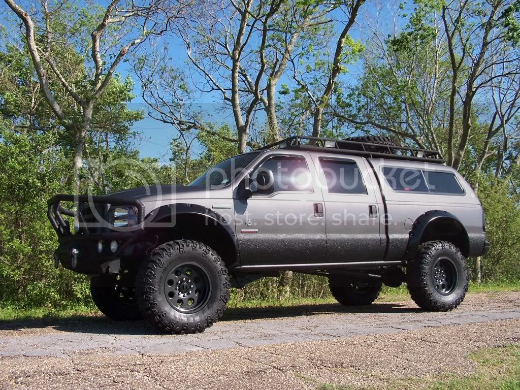

Here's what a 2005 F250, 6 speed manual, with 4.5" lift, Bushwacker cut-outs and 41's looks like.

That truck looks sweet and 40's fit with a 4.5" lift???

Thanks...and those are 41"s on a 4.5" lift...with cut-out fender flares
I don't think any offset will get 40's under your 8" lift....it's gonna hit the bumper, and the backside of the front fender
"rule of thumb"...for fitting larger tires
38" tire needs 8-10" lift
40" tire needs 10-12" lift
42" tire needs 12-14" lift
44" tire needs 14-18" lift
46" tire needs 16-20" lift
....and even then it depends on the quality of the lift(more wheel travel), and your style of driving(street queen or off-roader)

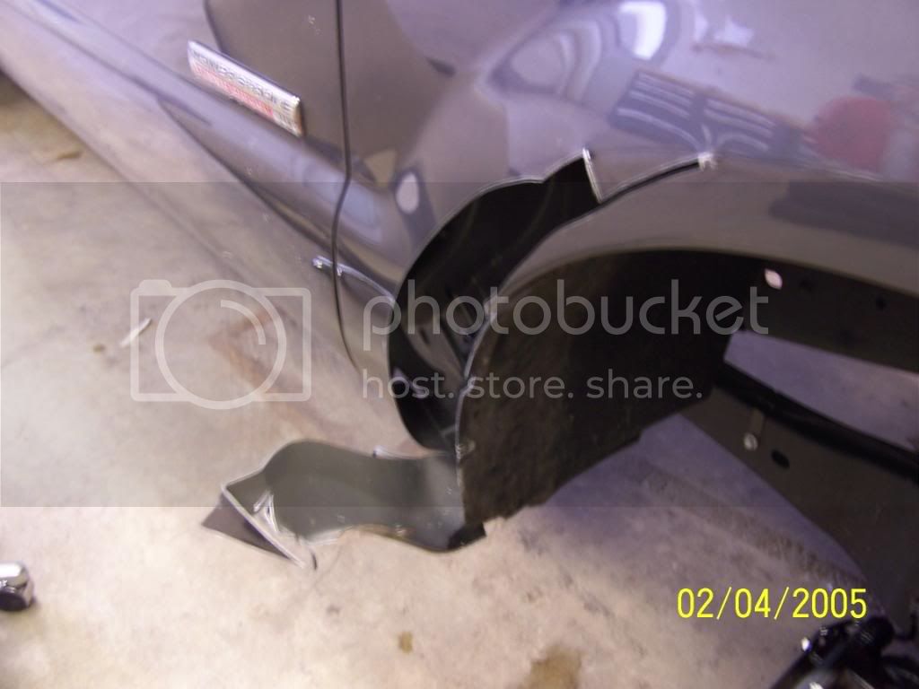

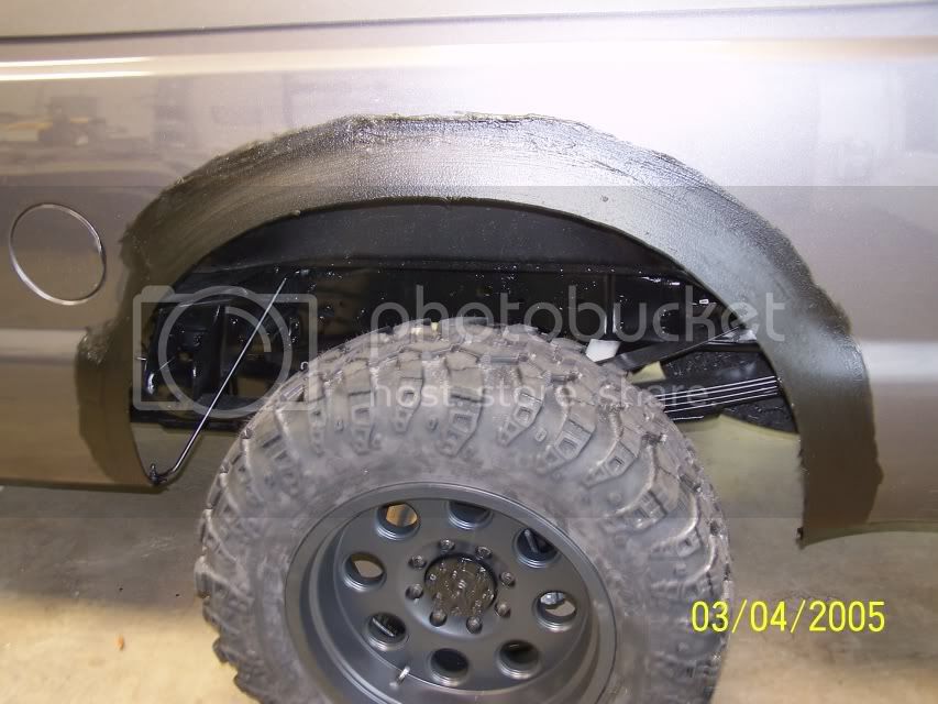

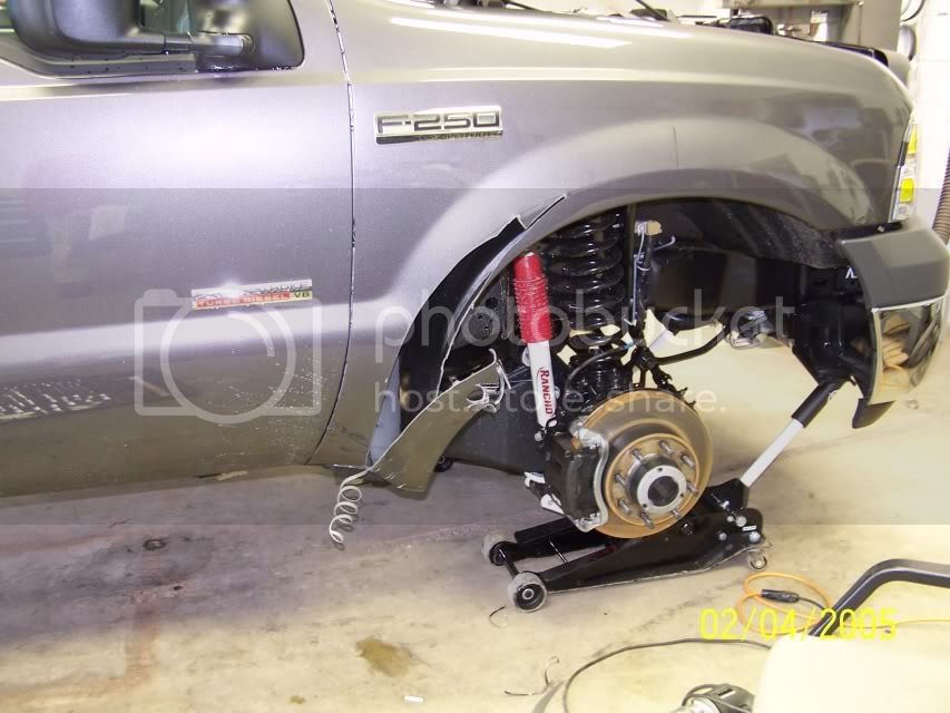

Yes..cut -out fender flares..means you cut..a lot..
Then I coated the cut edge with roofing tar...to prevent rust in the future.

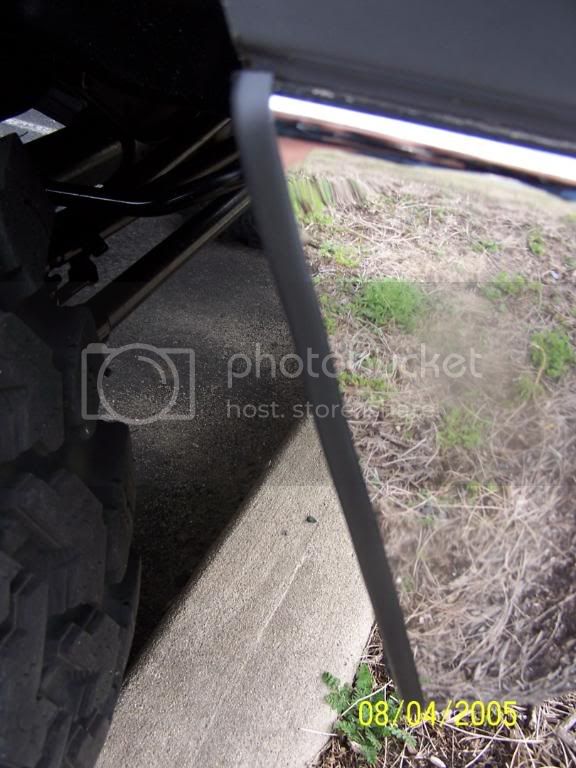

When I was on 36's and no lift....You Also have to trim the bumper...I sealed it, then I put door trim on the cut edge.
Done
