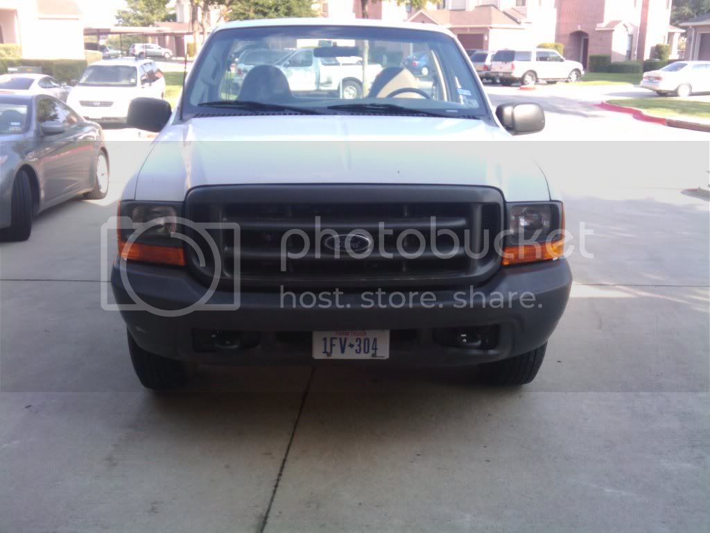

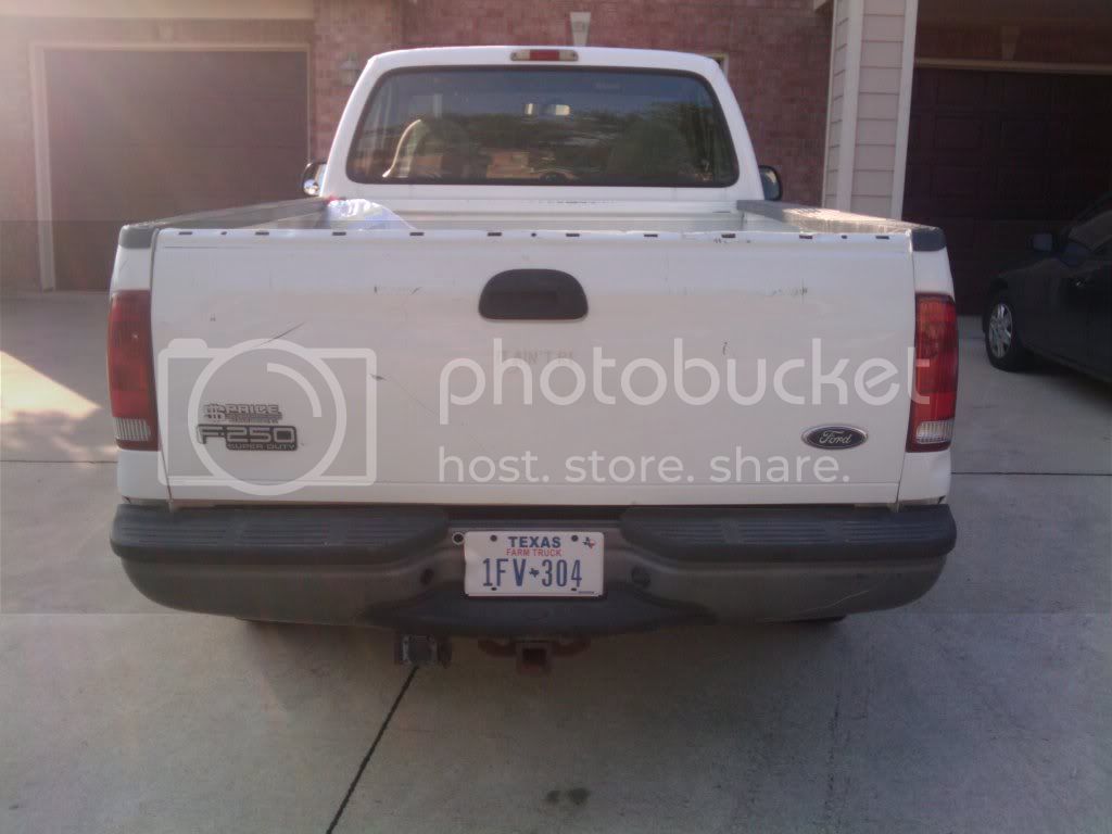

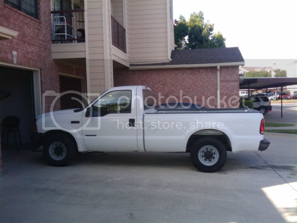

On August 14 (my 10 year anniversary) I bought this truck for $4800 from the original owner with 124006 miles and all the service records.

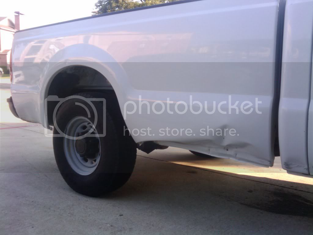

It had some rough spots

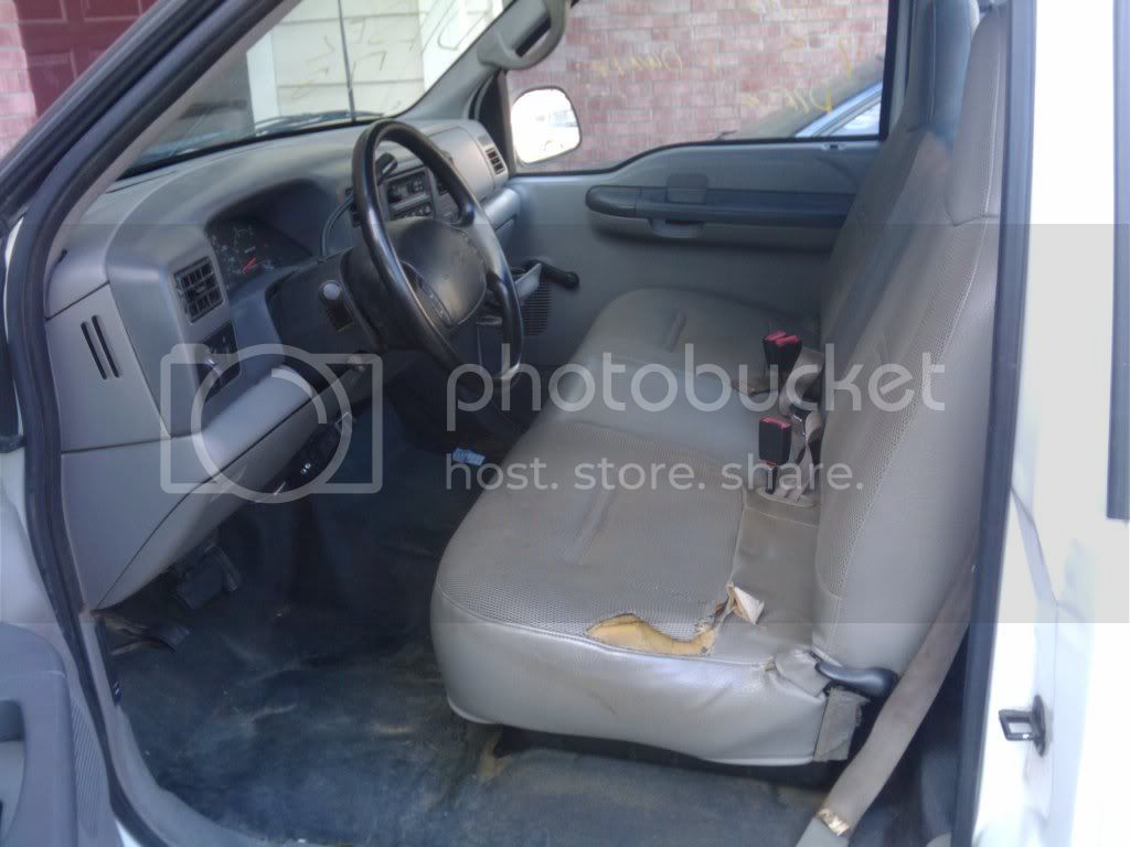

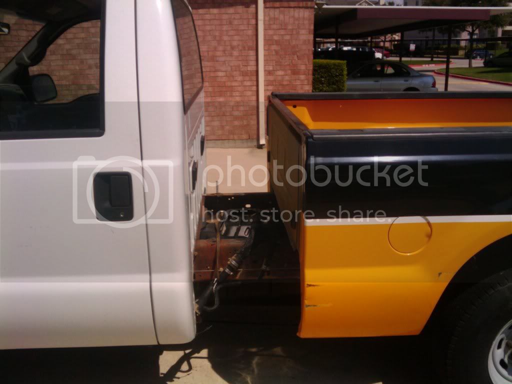

The interior.

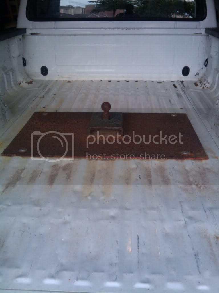

The goose neck hitch he rigged up when he retired the truck to the farm.

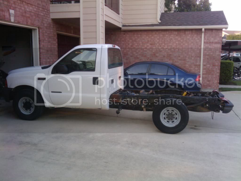

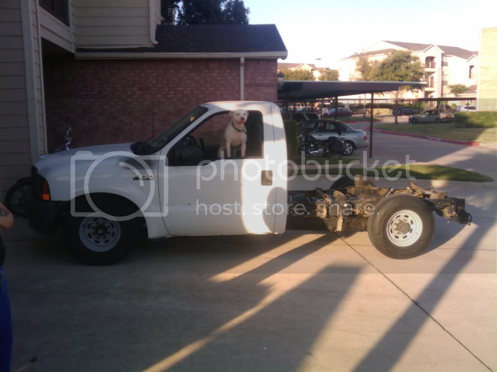

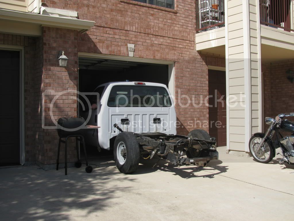

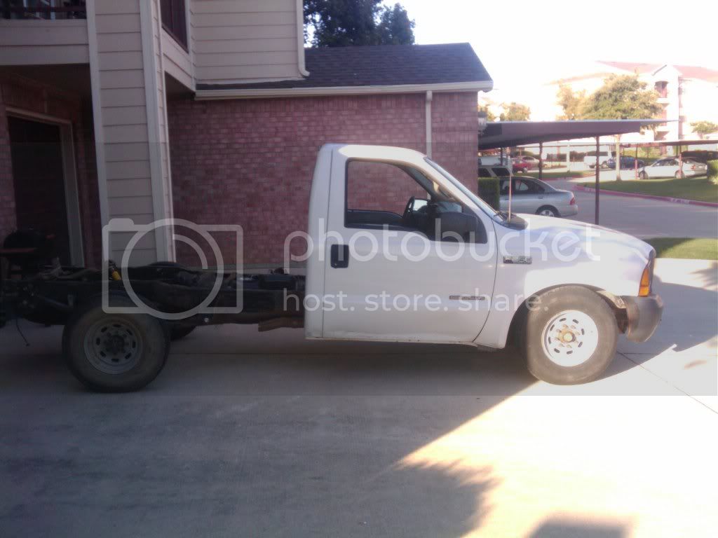

First thing I did was get rid of the bed.
Then cleaned it up a little September

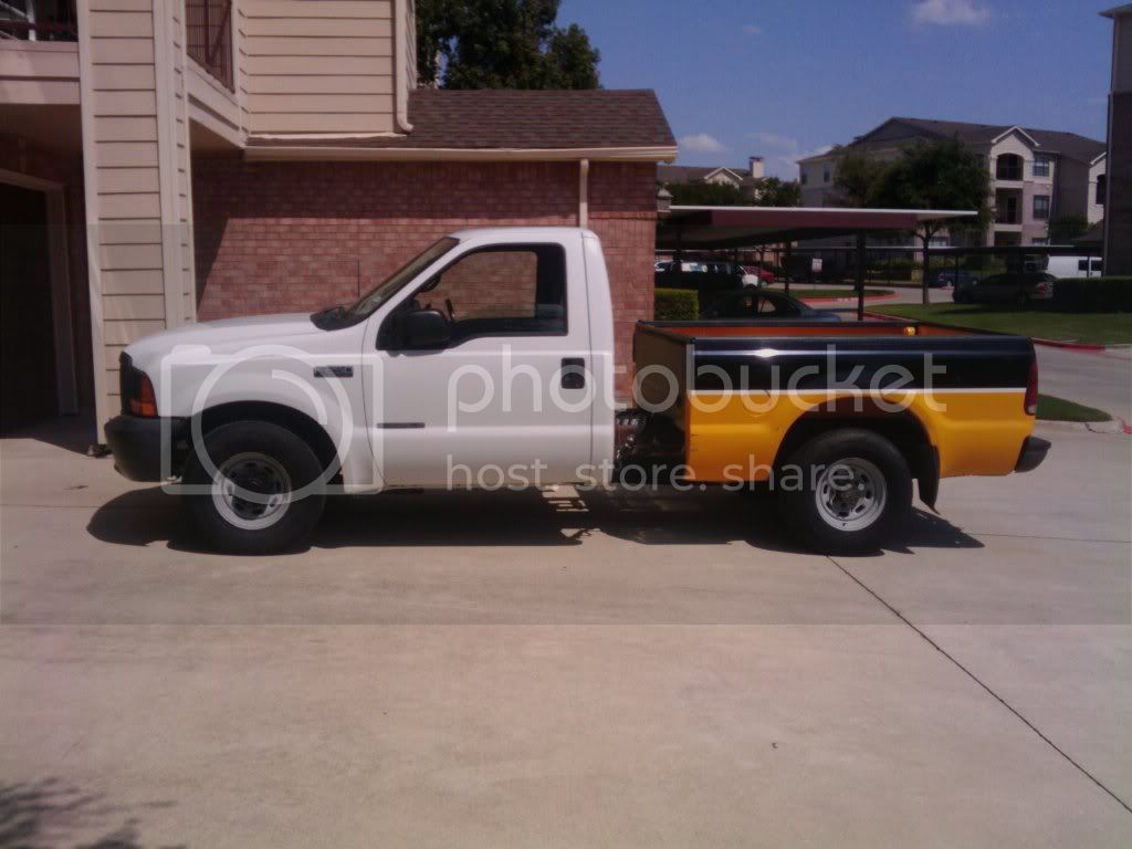

some of the things you find on farm trucks

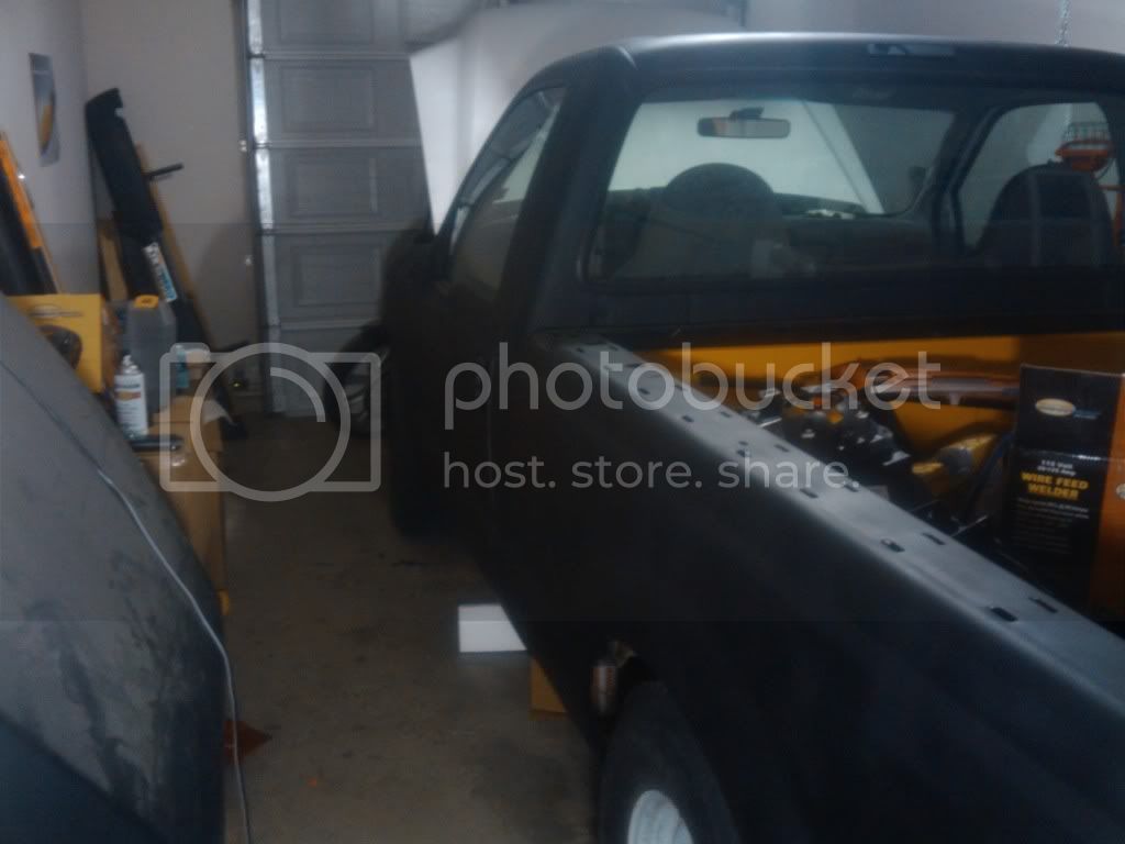

Found a good deal on a bed 75 miles away. I had no way to haul it so I did the next best thing
I rented an extra garage in the complex to store the bed in for a few months.

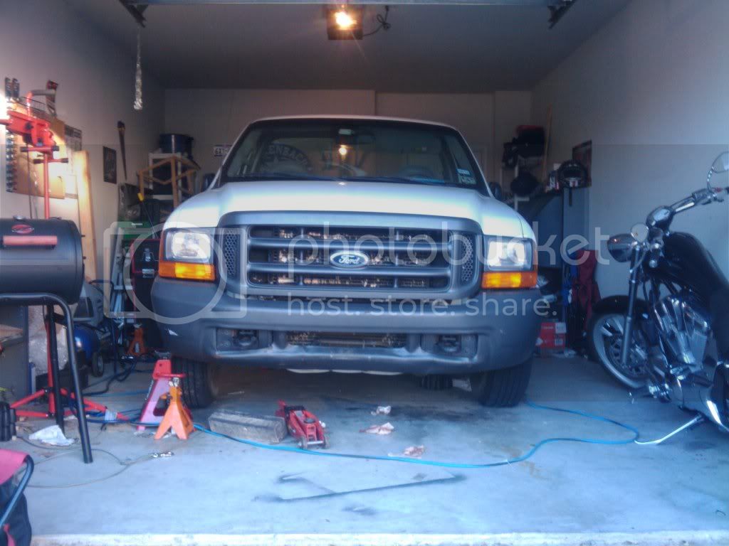

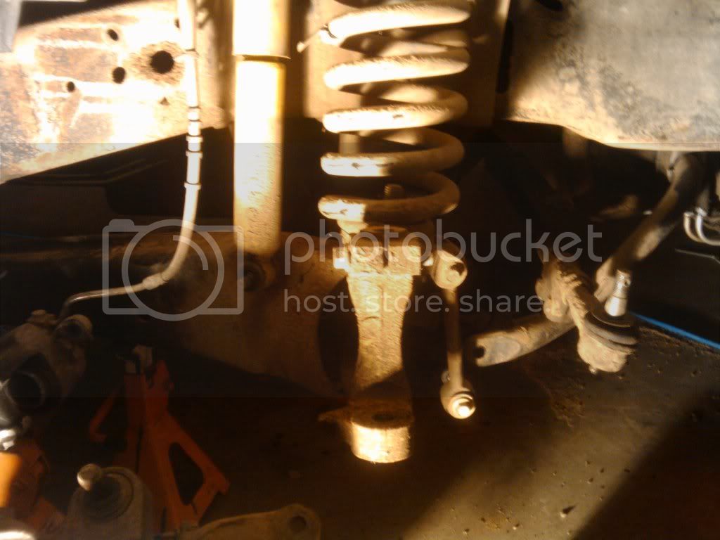

I started lowering it first so I could make sure it went straight before I cut it but after it was lowered.
Dream beams going in.
one side done

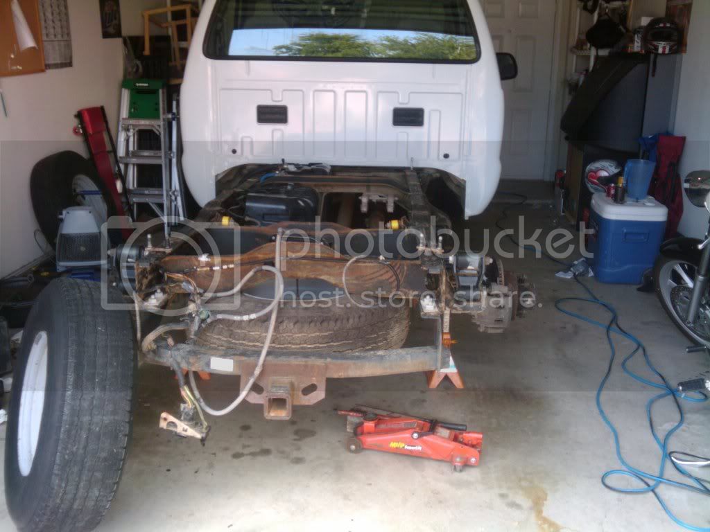

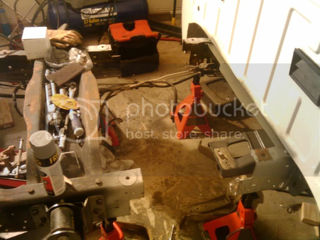

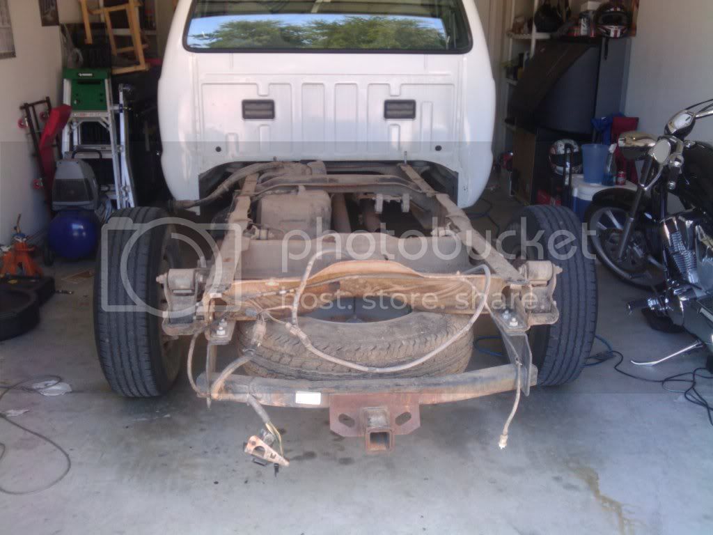

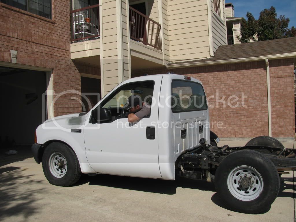

rear getting ready to be lowered.
all lowered

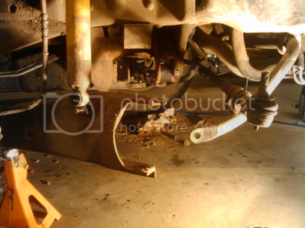

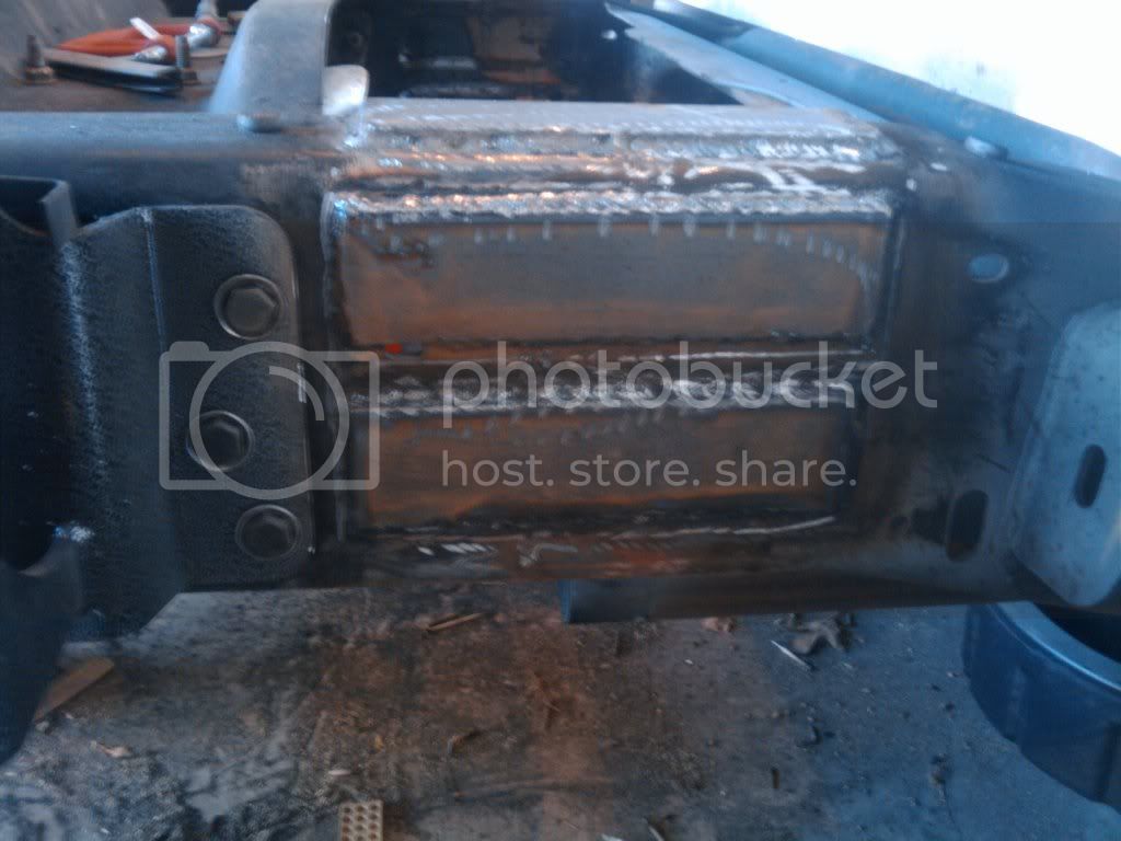

time to start surgery Oct 17th
cut
probably not the best way to do it or exactly how I wanted it but its done. I hired a welder to come over and weld it for me.

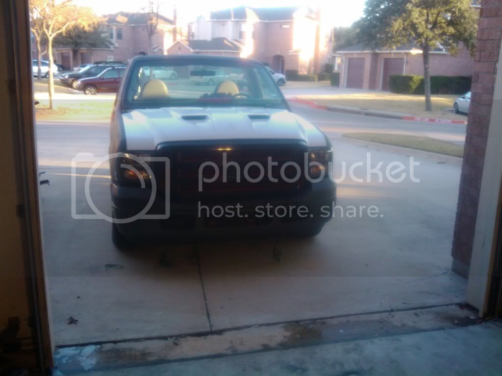

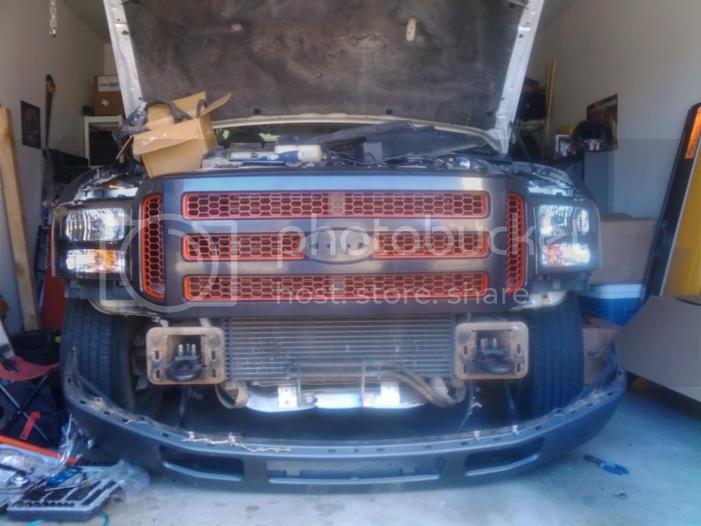

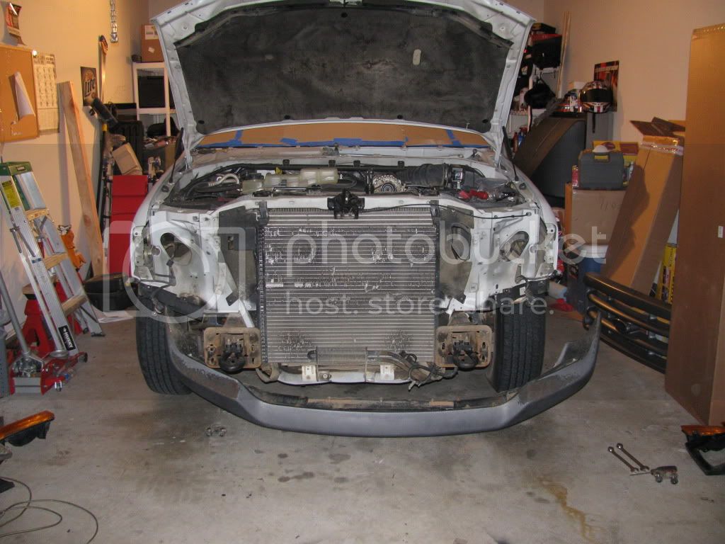

time to freshen up the front
bad pic but this was after I fixed the fins

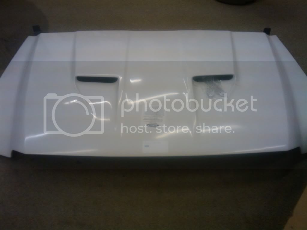

brand new Cervini's hood

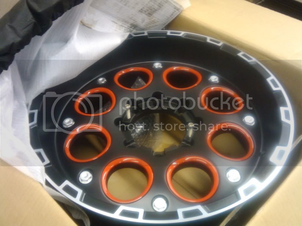

new ballistic wheels Dec 20th
Wheels are on just in time for new years.

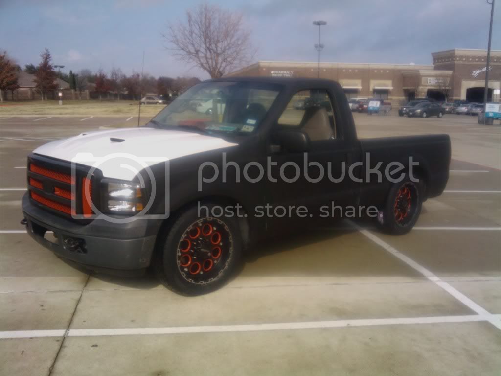

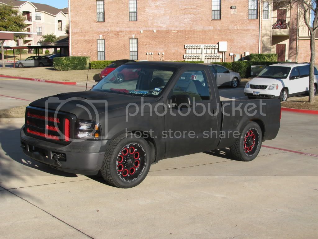

Not as pretty going as it is coming
Hood painted finally

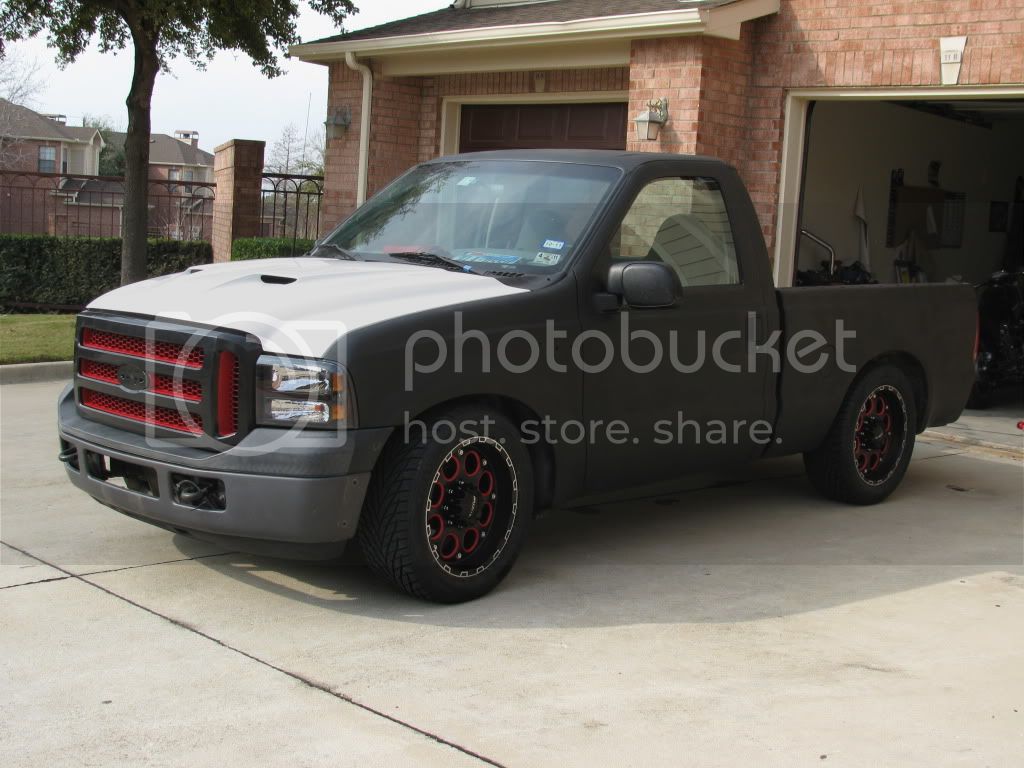

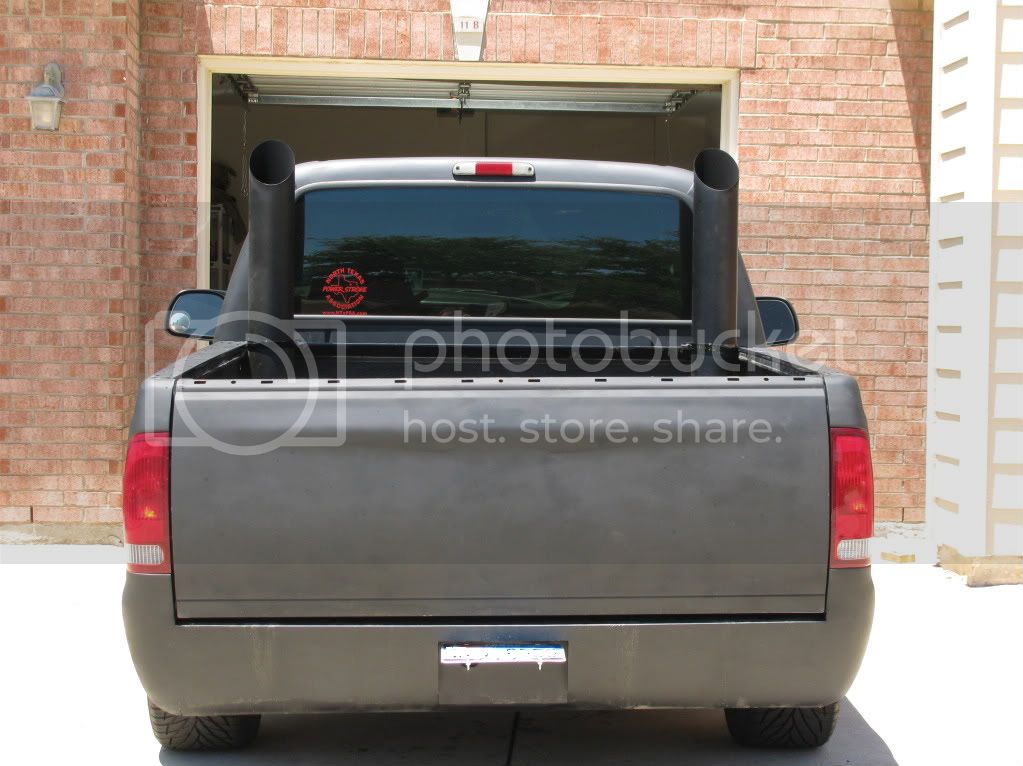

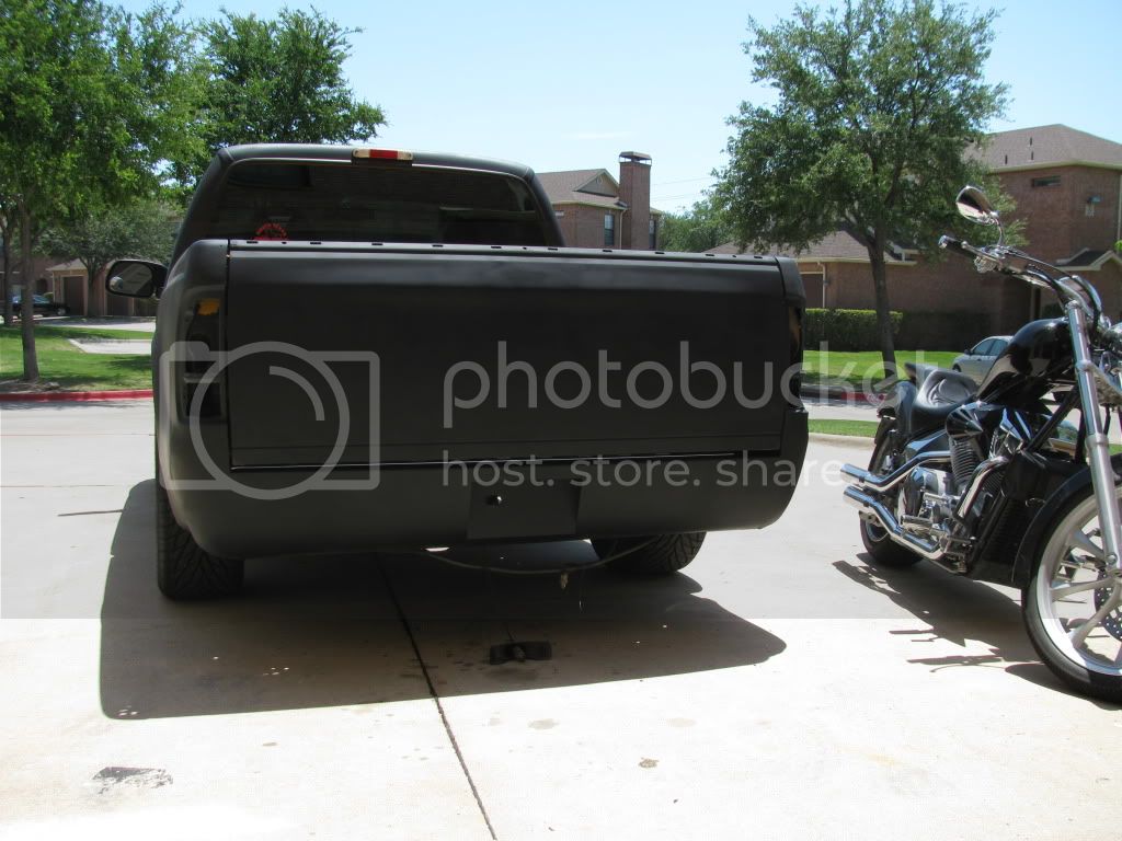

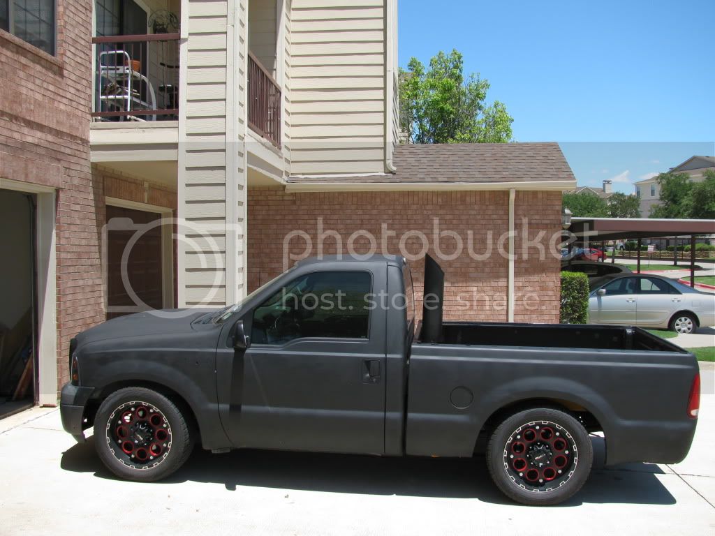

Got the roll pan from Grant Kustoms on finally. I ordered it in december and just got it put on a few weeks ago. Thanks Unbroken for pointing me to their direction. Also got the tailgate shaved.
No more yellow bed mod. Put in a herculiner. Thats the old farm truck plate. I thought it would be funny to throw it on for a pic.
Something needs to be adjusted.
