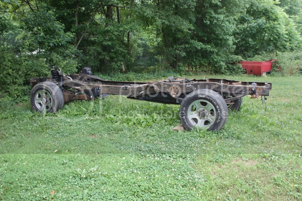

just picked up the rolling chassis, picked it up in georgia. haha it was a long way but an awesome trip. stoped at a few cool bars -THE BLIND HORSE SALOON- was awesome

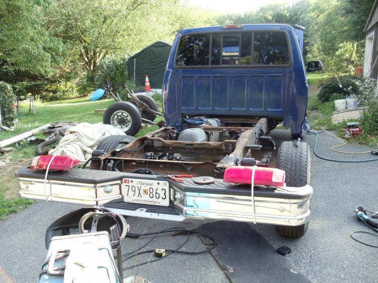

removing my bed to make things easier on me and so i can paint everything up with some POR 15 (i think thats what im gonna use). will also make it easier to make my exhaust!
Everything is out and only the rear is left!!
AND ITS OUT
got all the rivits out and removed the axle and also got everything else out

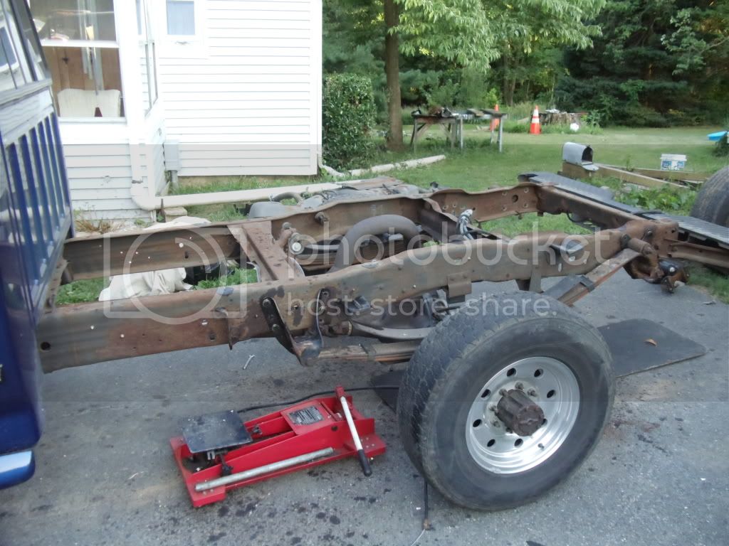

got the 05 rolled underneith and the front hangers bolted up. minus the center bolt hole which im gonna borrow A 5/8" reamer since the alignment was only a liitle bit off. the top bolts were a direct match and the bottom two were completely new holes. i decided to use my superduty hangers due to the fact my OBS ones needed to be replaced anyway
just another shot, backround- 87 ranger2.9 v6 5 speed and 1970 MONTE CARLO, my once dream car untill babys were brought into this world

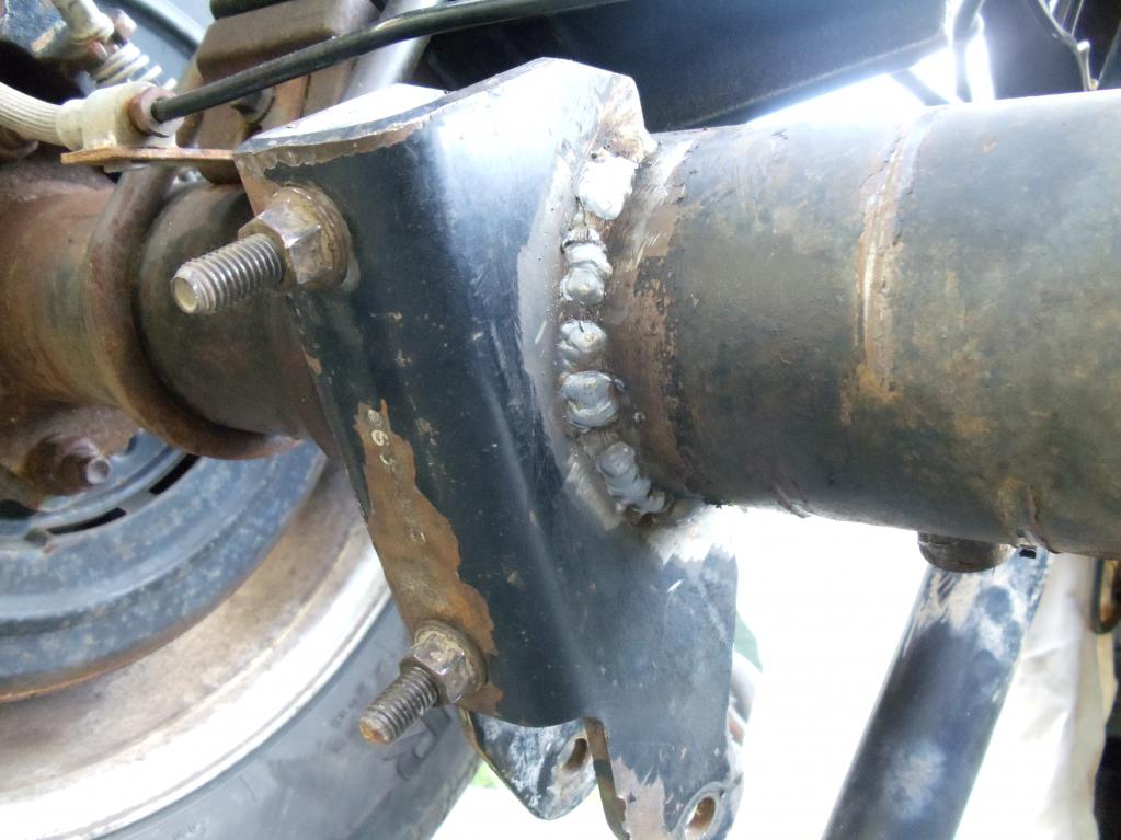

got some more progress done one the swap! got the orginal holes welded up and ground flat to make a new surface for the new superduty hangers, they were just slightly off and didnt want to weaken the bolt holes.

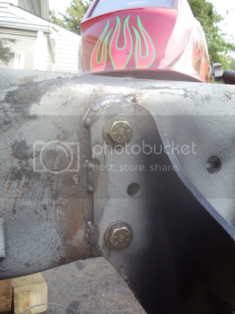

some more pics........ i threw a few stitch welds in the hangers, just because, really didnt need to but i just feel better that way if the bolts some loose or.... what ever i dont know. just wanted to

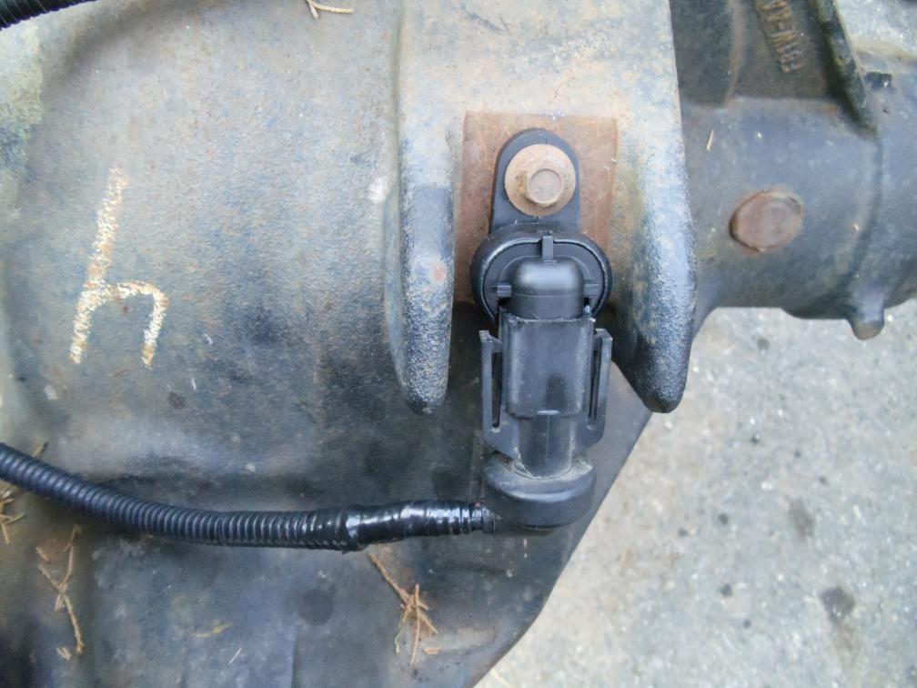

this was the sensor that gave me my problems. all good now. FYI the SD sensor will not work haha it has to be a sensor out of the stock rear
