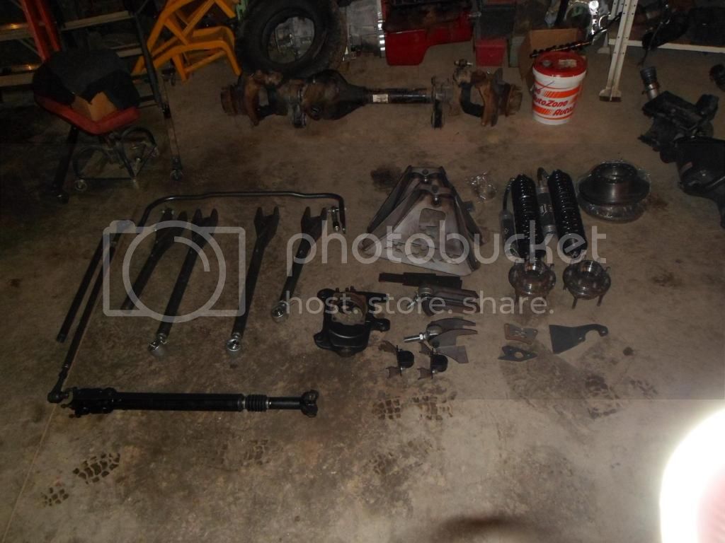

Four link parts supplied by XXX Traction:

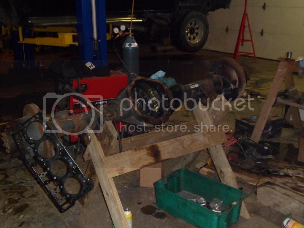

Rear Axle:

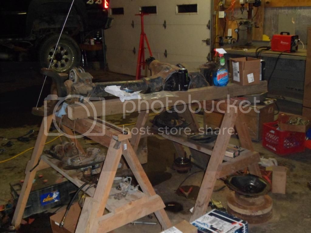

Front axle (and a bunch of random junk):
Rear Axle:
