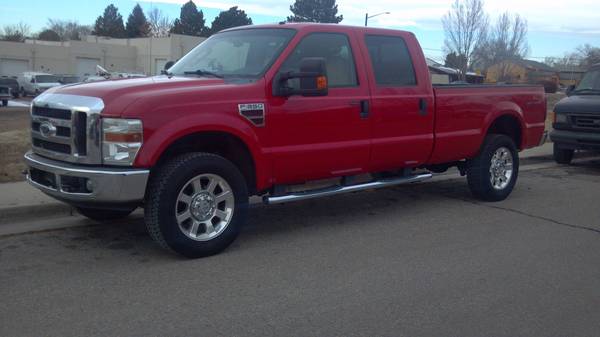

truck specs: It's an '08 CCLB SRW (build date 01/07) with SCT Livewire loaded with innovative tunes (usually the extreme street), No Limit IC pipe and elbow, Elite basic EGR delete, Flo-Pro 4" downpipe back no muffler aluminized exhaust, modded stock intake (has yet to move the filter minder even a little bit), 6" fabtech lift, fabtech floating traction bars, & 37" toyo m/t's.
^as I bought it
^as it sits now

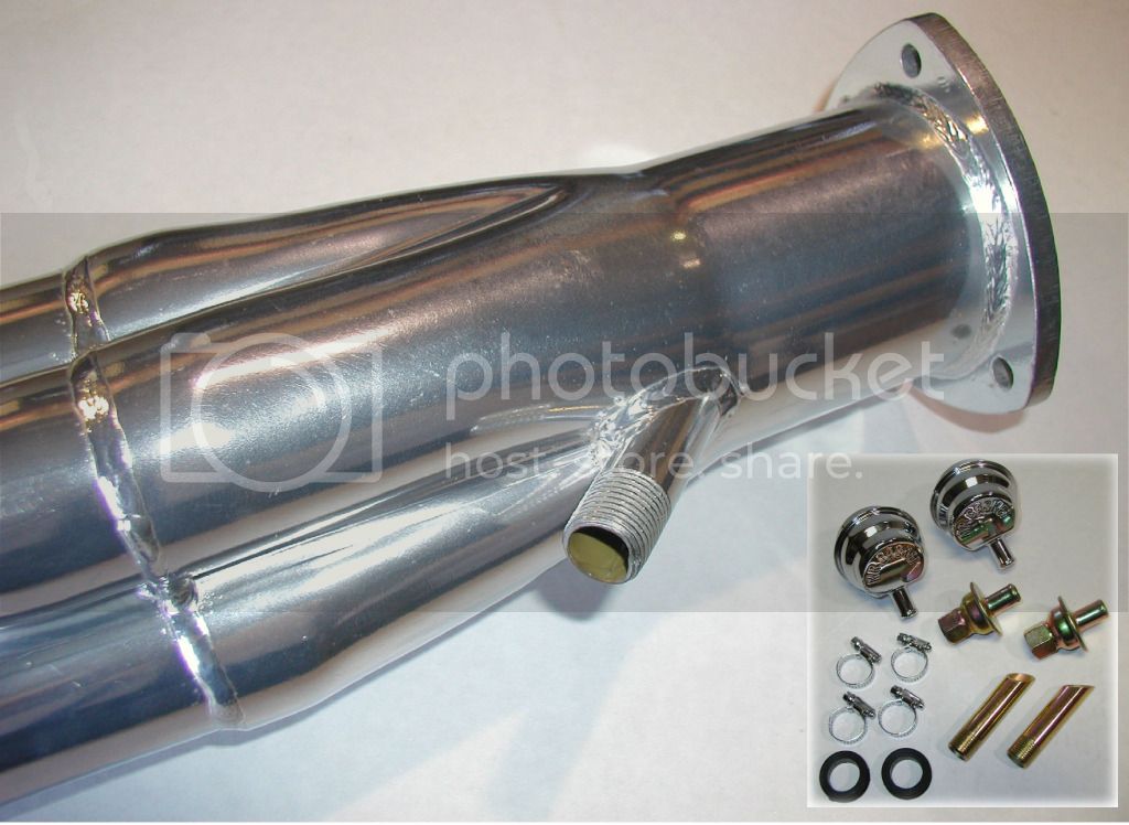

Great idea. Drag cars have been doing this for years with open headers. They even have a one way check valve so you can push exhaust back into the motor.
Kind of like these.
WoodBoy
1,894
Alabama
That is a pretty good idea using a check valve as preventative aid, but with the angle of the bung, and assuming all exhausts that this is used on will be free flowing, I would think it would create a vacuum before anything else
