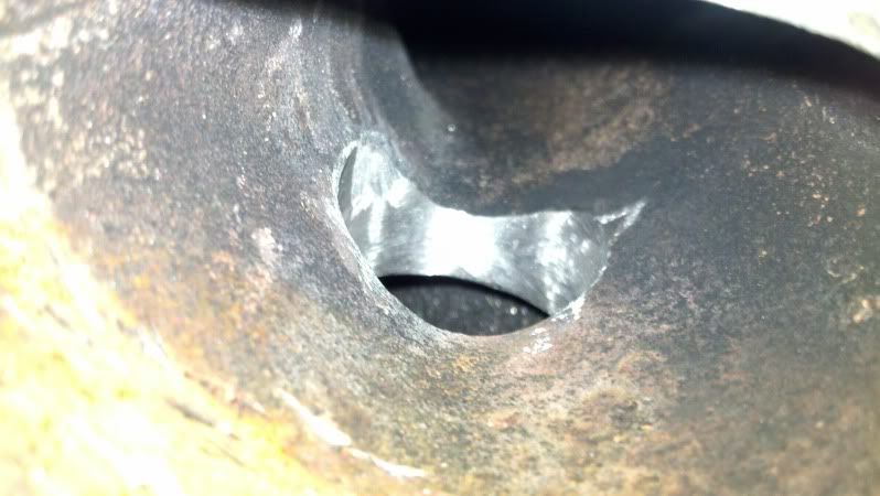

Just wanted to share these pictures. It's rough and I need to clean up the wastegate hole.
I don't have any numbers or impressions from this, but it seems like there's no way that it couldn't help. I think it'll be a great mod to do for the guys that are running the batmowheels and trying to make the stock turbo live with extra fuel.

I opened up the flapper hole a little, but I needed some bigger drill bits. I'm going to bring it to work and clean it up and drill the hole a little larger.

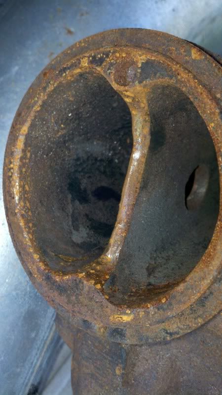

I was able to open it up all a little more at work yesterday...
Took a drill press and drilled the divider some more, and then cleaned it up and "sharpened" it a little...

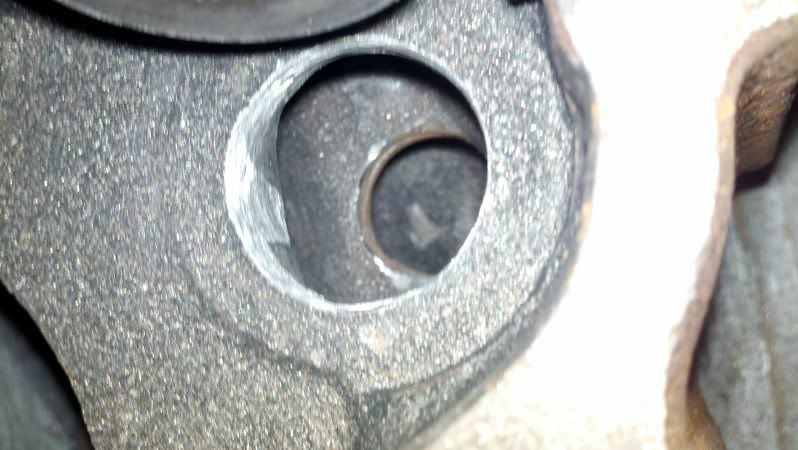

Then I opened up the wastegate hole to 7/8's... That's as large as you can go without the flapper getting in the way... Mine got a little scarred but I cleaned it up and it's fine...
Then I ported the hole with my Dremel and made it taper up to the flapper.
And there is the backside of the hole...

I honestly think that this will make for a better turbo than a 1.0 housing stock turbo... But that's just me. Once I get it on I'll know. But to me, it seems like I can have the best of both worlds... Neck-snapping spool-up as well as good top end, and that will be achieved by adjusting my wastegate spring tension and using either a boost or backpressure referance to open the actuator.
