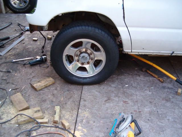

Started a thread a while back on psn, and finally got some more work done. I am using front and rear axles from an 05 F-250.

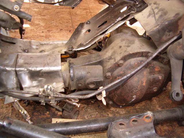

I want the van to look as stock as possible, so need it at stockish ride height. Which required hacking the hell out of the crossmember.

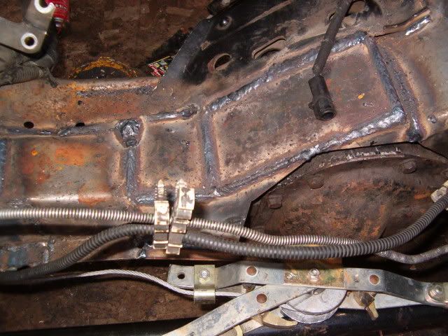

Got the crossmember back together with 3/16 plate. I tacked it all up, and had a buddy come over with a gasoline powered stick welder. Not my first choice, but couldnt bring the van anywhere else very easily.

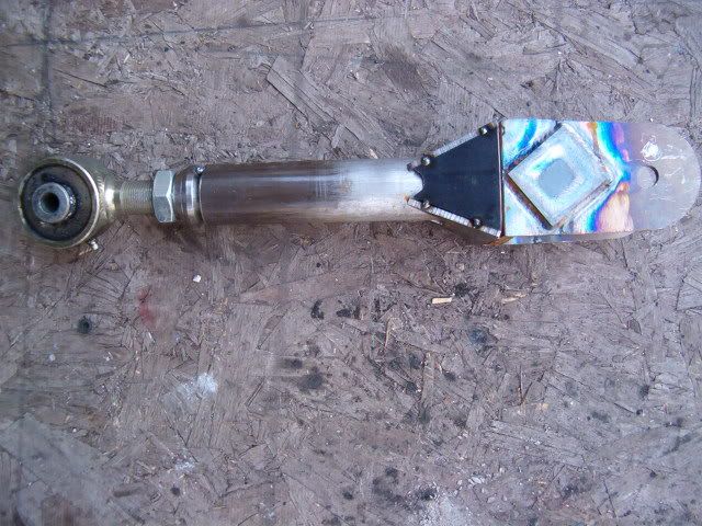

A different friend helped me with the 4 link arms.
Somehow or another today, I cut them too short before I tacked the tube adapters in!:doh: So will have to weld new tubes on 2 of them. Finally making progress. Let me know what you think so far.

only thing i would be worried about is that cross member but it looks like you probably have it under control

I want it to look stock and rip off some low 11's (hopefully). I think the crossmember is strong enough. It is reinforced underneath as well. Here is with no cutting.

After comparing it looks like your crossmember should be stout enough

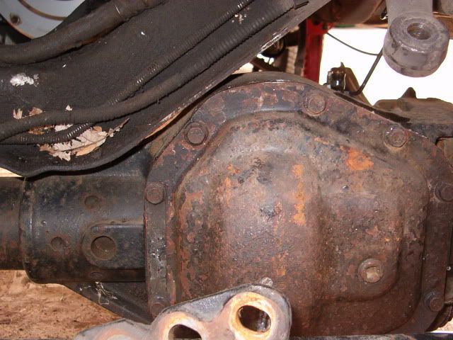

Is it closer to stock height in the front now?
It's about 3/4" higher than my other van. This pic is with the bottom arms all the way out and the axle needing to go another inch forward which is why I need to lengthen them.

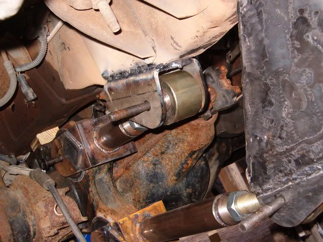

Got the tracbar and draglink half ass mocked up.
I am 99% sure that the pitman arm taper is 1.5" per foot and I was sold the wrong reamer.
This is why the draglink won't drop all the way in. When I do get the pitman arm tapered correctly, you can see there may be some clearance issues to the tracbar. It has to drop in about another quarter inch, but the pitman arm also has to go onto the shaft about another quarter. I didn't want to torque it on only to have to take it off again.
What is the pitman arm material? Just cast iron? If I can't get enough clearance cutting some of the threads off, can I heat it and bend it straight? Don't know if that would affect strength or not. It has a slight drop to it.

I think they're forged. Did you run this past Arne? Maybe he has some ideas, or knows someone..

How about a slight bend the the track bar to gain some clearance?
rpm-inc
988
That sounds hard...:axe:
Looks like people have successfully heated to a dull cherry red, smashed flat in a press, then cool slowly in kitty litter or sand. May give that a shot.
Anybody have dimensions for a stock superduty pitman arm? Drop, center to center, and splined hole size? If the picture is accurate on napas site, it looks like it may have a little less drop.
It may very well work the way it is, though.
Tom S
3,365
That track bar would bend easy in a hydraulic bender. I used one to put a slight bend in my traction bars and that was .25 DOM tube. The trick I used was to have them tightly packed with wet sand so that is did get the idea to kink. Just a couple degrees would give you some clearance.
