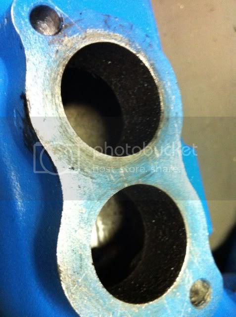

My order was a stage 3 which includes the throat modifcation cleared out runners and opened up head chambers "velocity stacks".

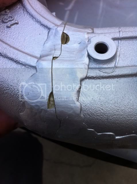

Now when I noticed the epoxy holding together it was pretty shocking. I felt this was a joke especially when I saw how it wasn't even cured or hard when flaking it off to get it welded at a buddies shop. After trying to get ahold of soot to see how I can go abouts getting this fixed I said screw it and took it to a buddies welding shop and had him tig it up I paid him 140$ for 3 hrs of his time

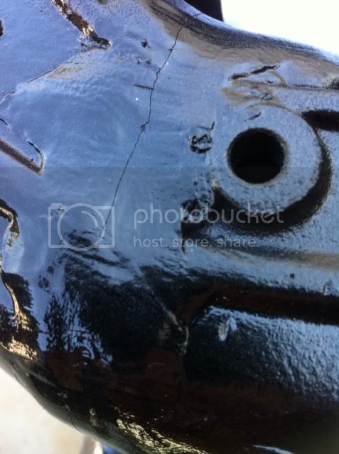

Well we got our intake manifolds last week both together in a small radiator box nice and banged up. I found a crack on mine and took it to my buddy and had him weld the small crack up. I also found one of Matt's welds didn't penetrate after install and found it leaking. So I had to fix that while the part was on my truck.!
The intake I received wasn't what I ordered. My order was a stage 3 and what I got was a stage 1. Soot says that he needs epoxy inside to feed the velocity stacks, hmm Bs! Nothing but soot and oil inside the manifold. Looks like someone was in a hurry to get these out instead of sending a good product out. When installing the manifold didn't seal. I had to use silicone to seal the portion under the alternator. After that leak was found I found 3 other leaks on soots welds.
I'm personally out 1400$ on junk basically after fixing some buddy's screw ups and getting text messages saying me fixing his 1in crack warped the manifold. I advise everyone to go a different route to avoid this crap.
