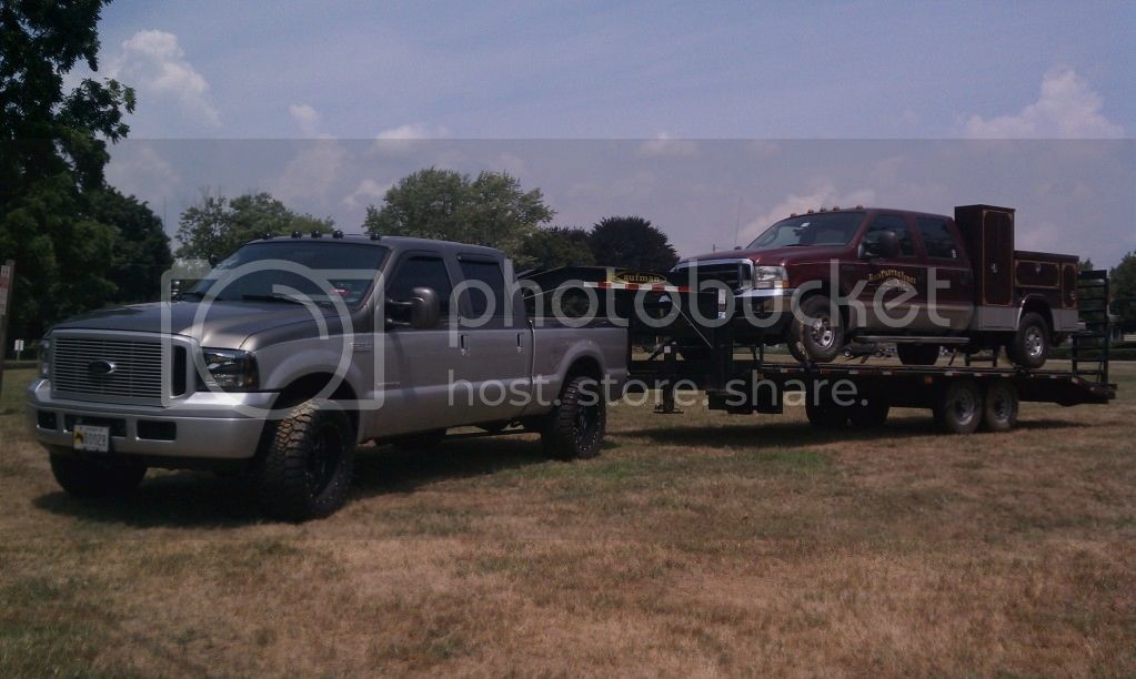

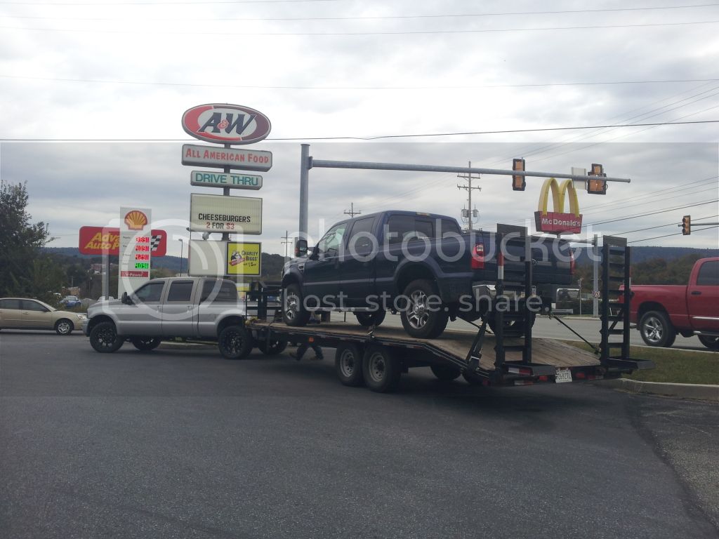

Marty
1,288
Elkton, MD
I own a 24' Kaufman gooseneck. If your tires are in good shape it pulls great.
IMO... 24' is the shortest I would go with a gn, 22' is the shortest I would go with a bumper pull if pulling a pickup truck is in your plans at all.
Just remember, a deck over will not load cars very well. I only haul trucks so a deckover works great for me.
PS, I've put probably 5,000 miles on this trailer since I bought it. Loving it so far.
8200lbs - 11500lbs trucks in these pics...

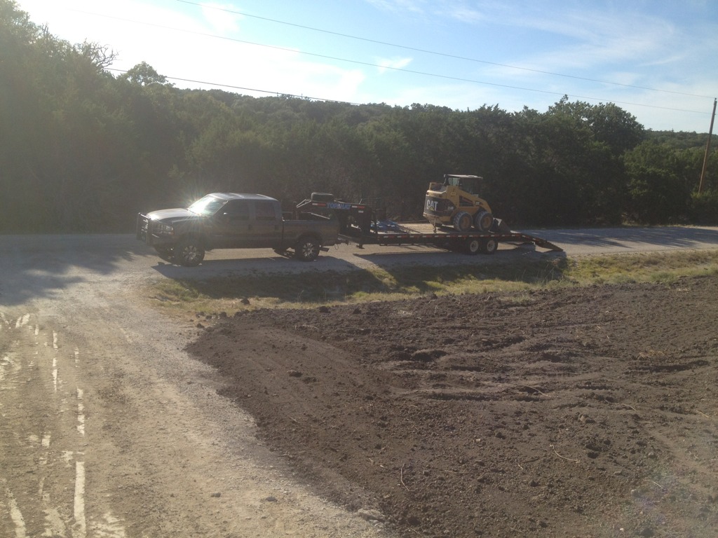

6.0 p-stroke
2,154
North of San Antonio, Tx
We've got a Tophat, the only thing I don't like about it is that it's a high deck. It pulls great and has never had an issue. I've pulled my buddys PJ, it's longer than mine but it's a low deck, I love it, except the brakes don't seem to work to well, they might just need to be serviced though.

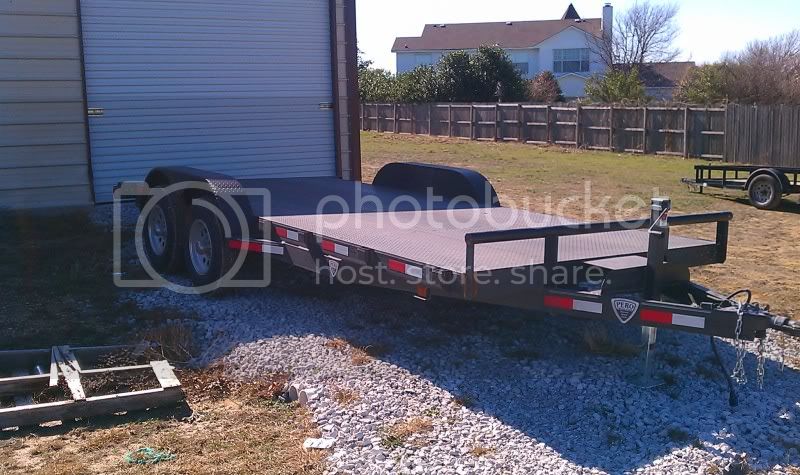

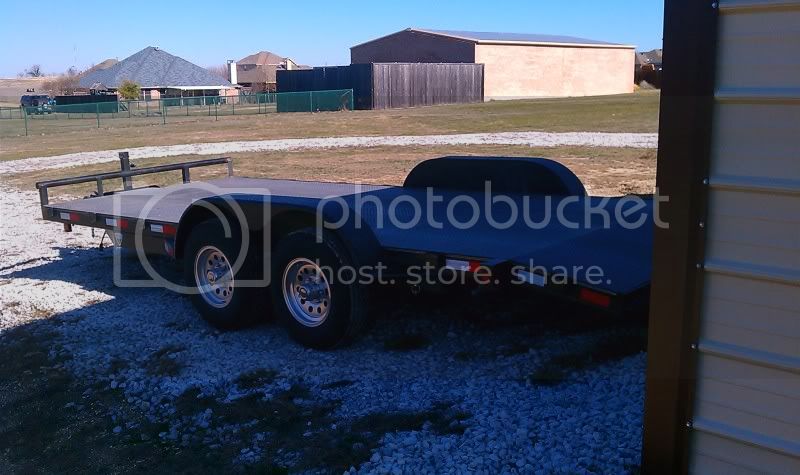

superstroked
1,627
Celina, TX

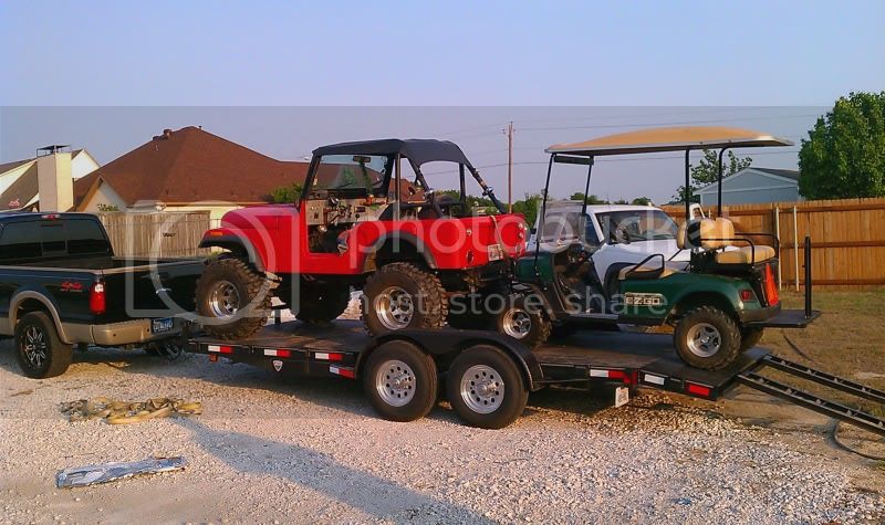

Mine was built by Pero trailers in McKinney TX. 5400lb axles, brakes on both, bulldog hitch and jack with all LED lighting. Pulls like a champ!
