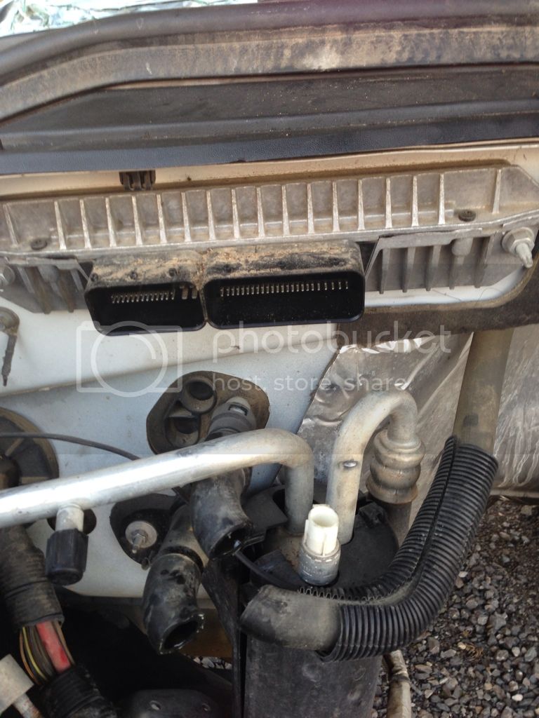

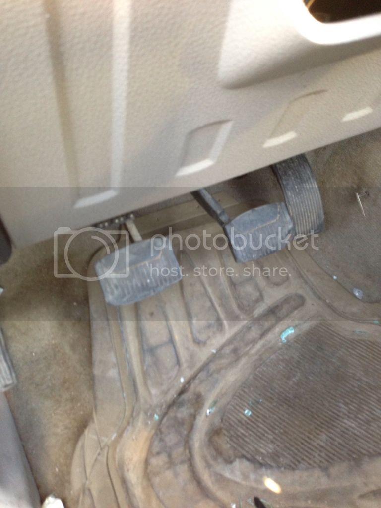

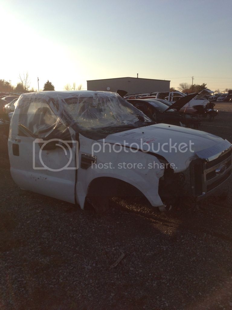

Donor truck is a 2008 F-250 standard that got rolled by the previous owner. I bought the cab, transmission, and related parts for 2k. Heres the pics:
Only parts left to purchase for swap is the rear main seal retainer and a clutch. Any questions, comments, concerns, or advice for the swap are welcome. Definitely have some questions for anyone familiar with the electrical/computer side of this swap.

Haha we will see how it goes, once we figure out how to successfully make the electronics/PCM work I'd be down for doing another one, right now we just don't know what to expect, but that's why I bought the whole cab for the swap
Black_Lightning91
Sep 29, 2011
98
Didn't buy a manual trans ECM? I'm not sure on differences but I do recall there being two separate ECM's IIRC. I believe MPD ran into issues with their 4r swap because factory ECM wasn't communicating with the transmission. Not sure what can be done to get around this but I believe their fix was a ECM for a manual transmission truck.
