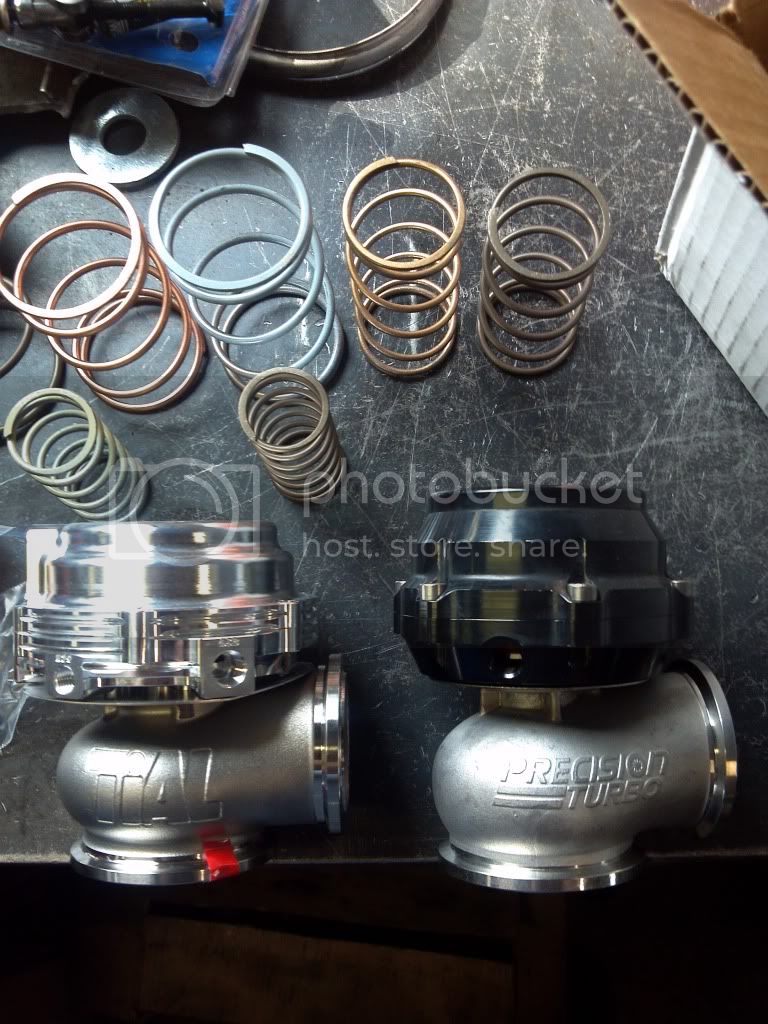

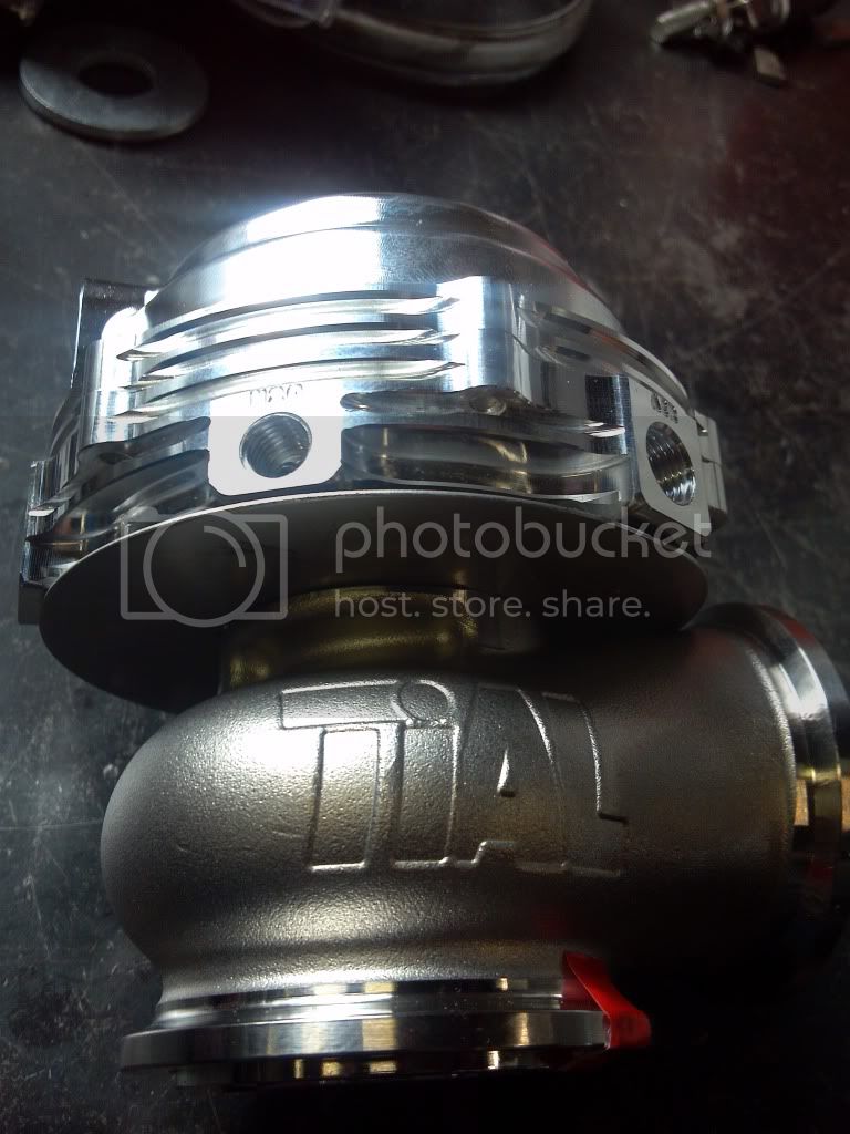

The water cooling is for gate setups in tight areas where there isn't much airflow to keep the diaphram cool, 6.4 is a perfect example. I'm hoping the one I'm putting on takes care of the precision gate failures i've been having. The tial is a pretty nice gate with a thicker diaphram .60 versus .30 on the precision. It also has a big heat shield on it as well. The tial also comes with alot more spring choices to set the gate to the exact pressure you want.

Here is some pics of one.

I used to run Tial wastgates on my EVO and my 96 GSX Eclipse. I never had one fail and they were mounted right on the manifold. Yes a gasser and ricer but 40 psi is 40 psi. I believe the Precision Turbo took Tail's design and made their own. Do not quote me on that but look at the pictures and see for your self. Tial has been around for a many of years.

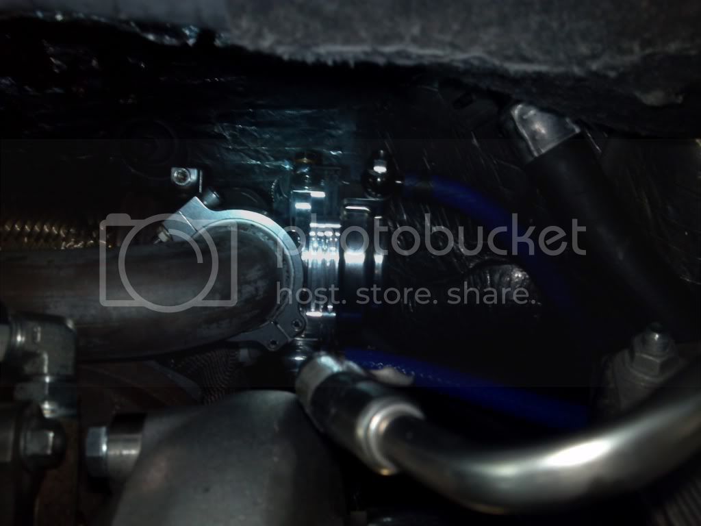

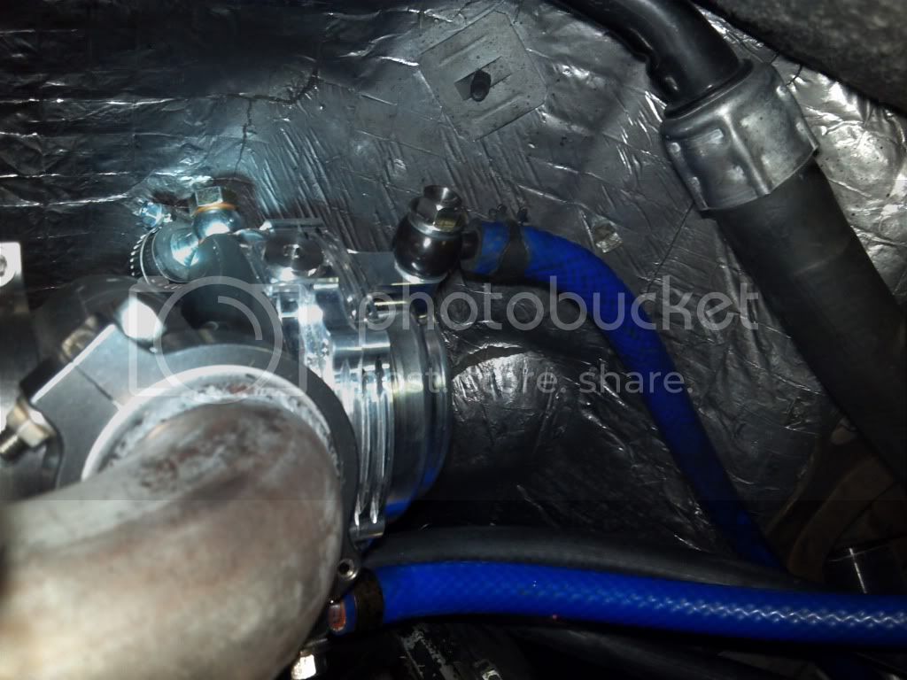

Thats how we found this one was blown charles was the big black stain of soot on the fender. On this truck its not only the heat in it but all the radiant heat around under the cowl where the gate is mounted. Here is some pics of the gate mounted, just about ready to go drive it.
