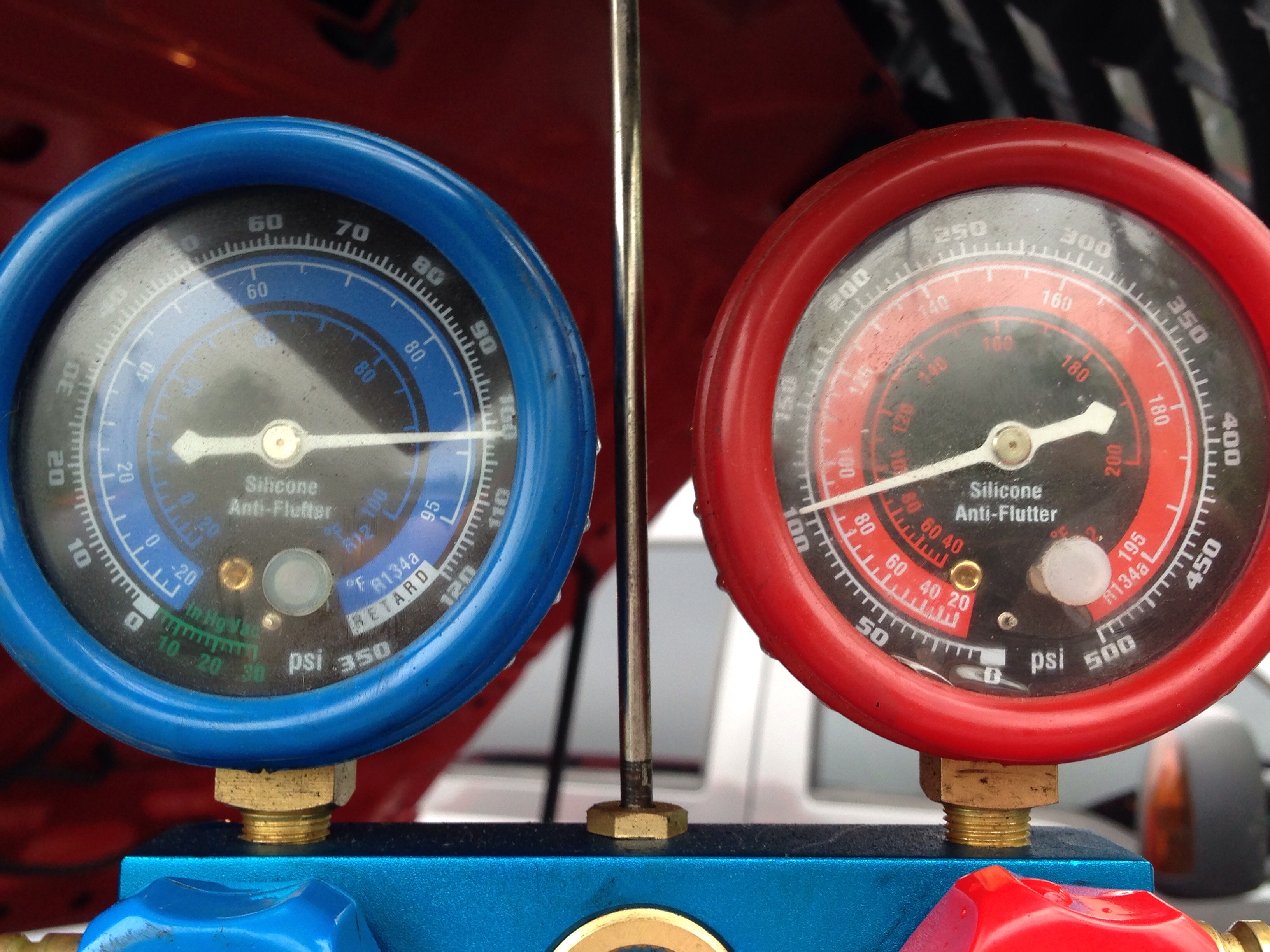

Collected some new info, the pressure after setting all night was around 75. Started the truck, engaged the ac (compressor is running) and the pressure didn't move. I unplugged the sensor (LP sensor?)on top the canister thing next to the firewall(evaporator?) and the compressor turns off, promptly turns back on when I plug it in.

The first picture is with the truck shut off after being a 1/2hr.
Second pic is with the truck and compressor running.
