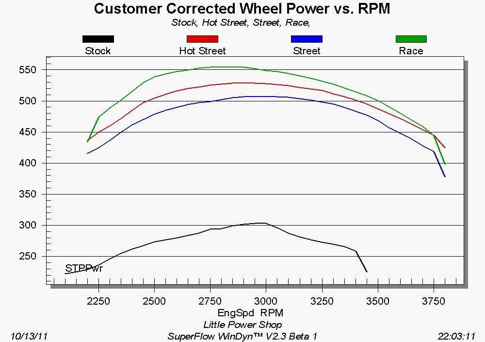

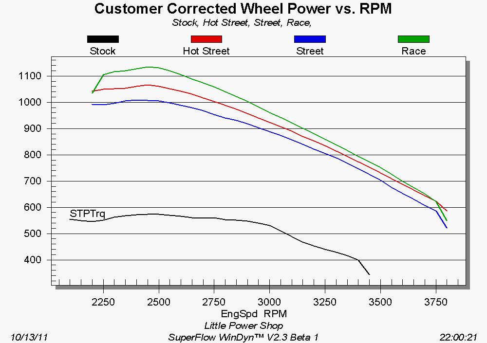

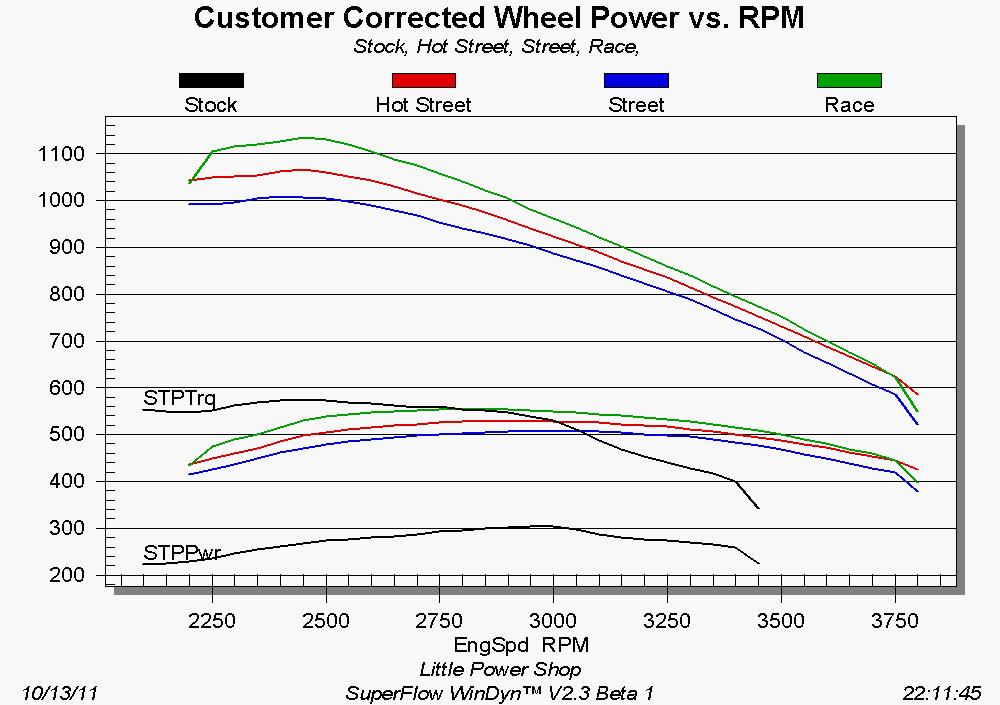

Stock truck with intake and exhaust only (stock run was with exhaust and intake already). I'm sure backpressure was getting out of hand and thus a wastegate would have done a lot of good up in the higher RPMs.
I could have pushed the race tune with more timing, but i erred to the side of safety instead of that last 5hp i was looking for....
I have all my beta customers lined up so i will be getting those out this weekend. General release will be Nov 1st.
