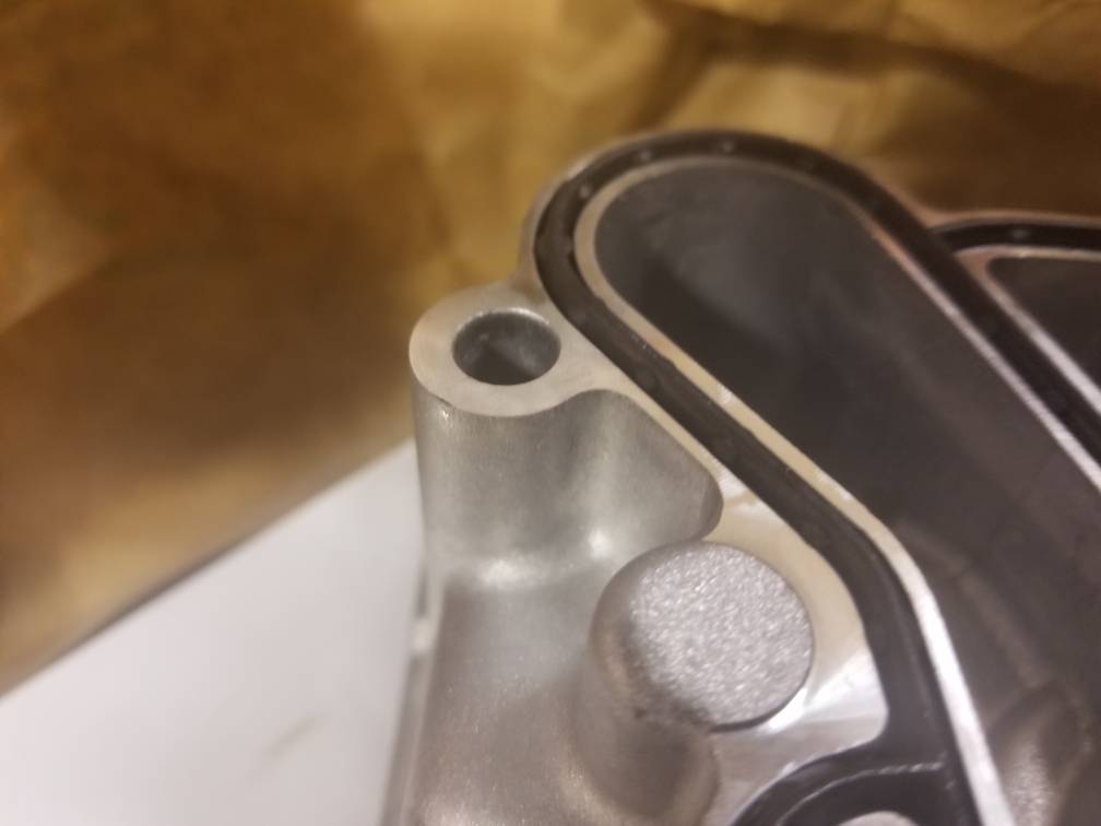

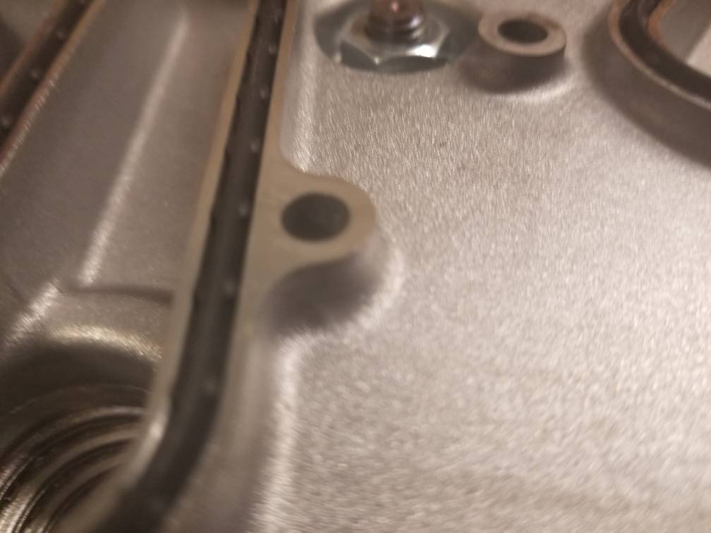

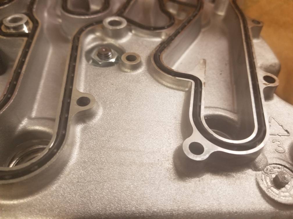

Did I get the Friday edition or do the bolts make threads on the way in?
Sent from my SM-G950U using Tapatalk
White_monster
3,177
The great white north
The threads cut as you put them in. The holes are supposed to be that way. If you read the tech section in the library on this site you will find the torque procedure in the coffee table book.
