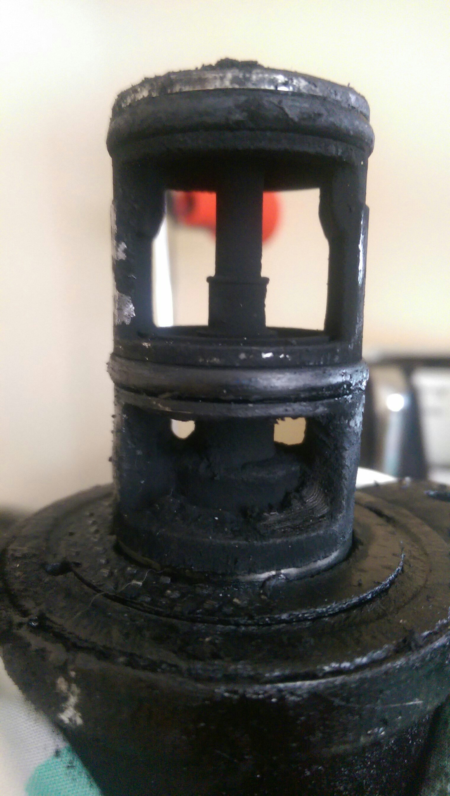

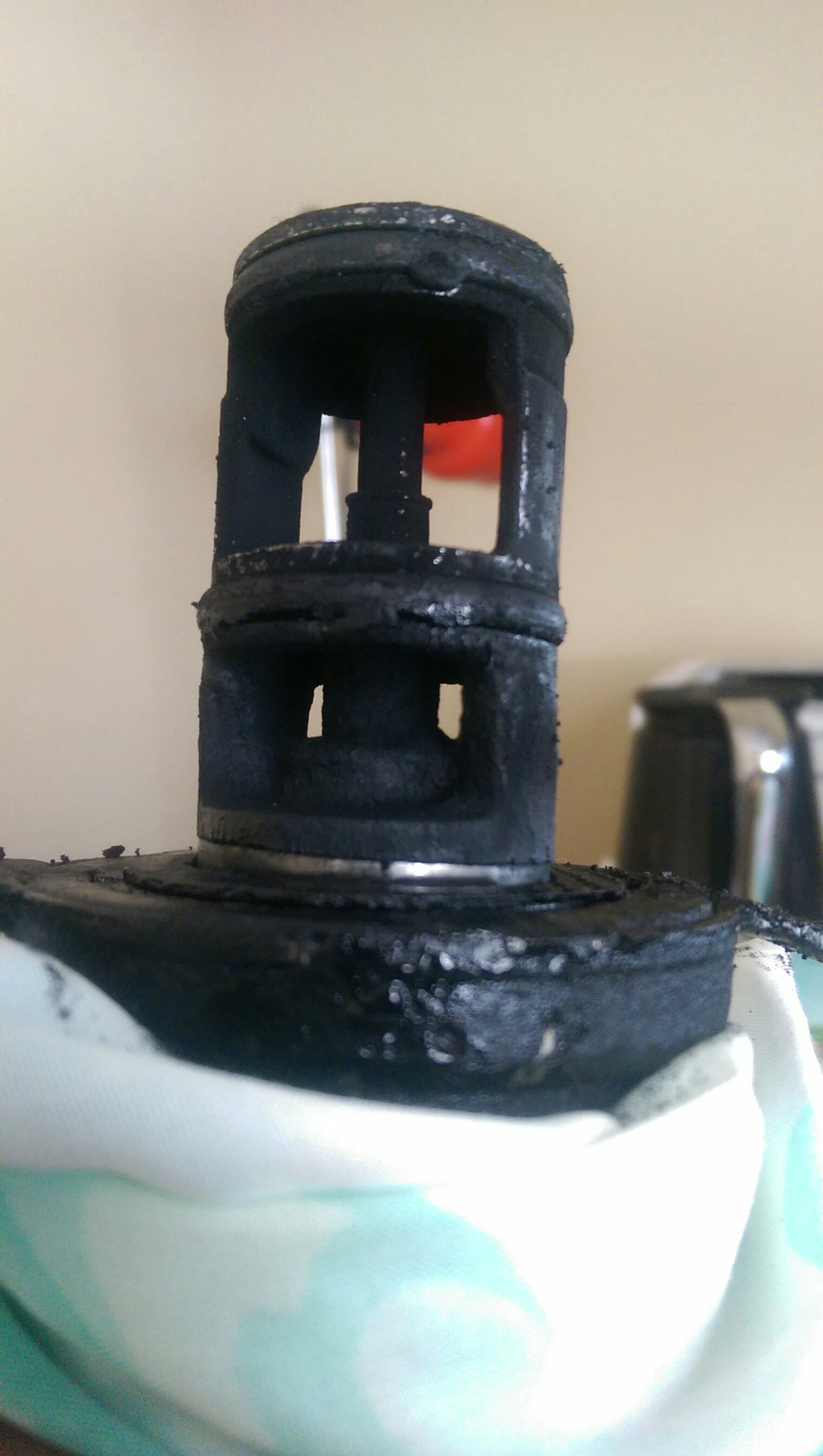

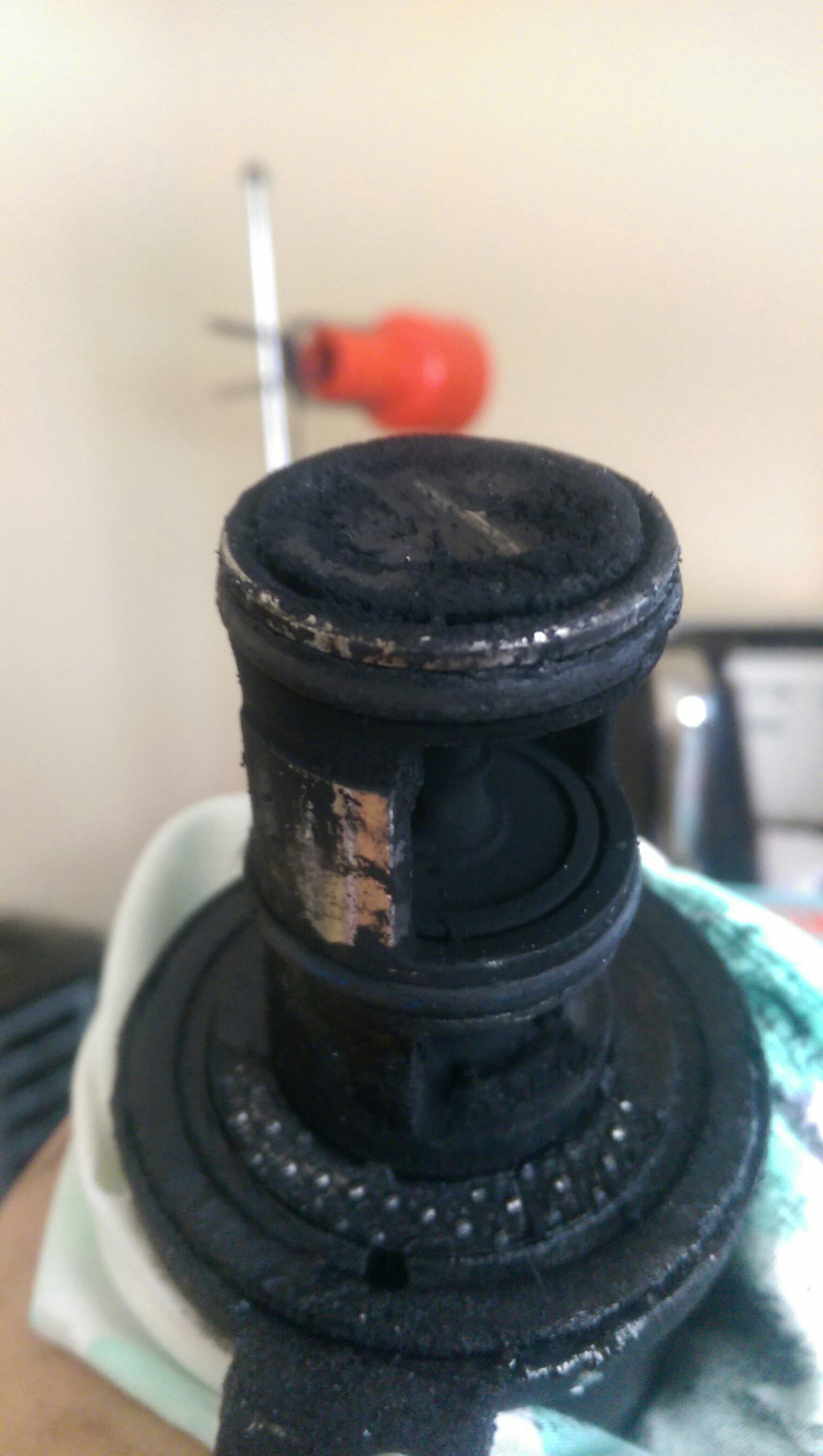

Don't think its that bad, but i'll clean it and see what happens

No doesn't look terrible. Did it run any better with it unplugged? Could be ***ked electrically or somethin too.

ran the same, i clean it anyways replaced the gaskets and same thing happened, i let it warm up more and when i reved it the black that came out was intense and it stalled out when it came back down from the rev and it was banging bad
