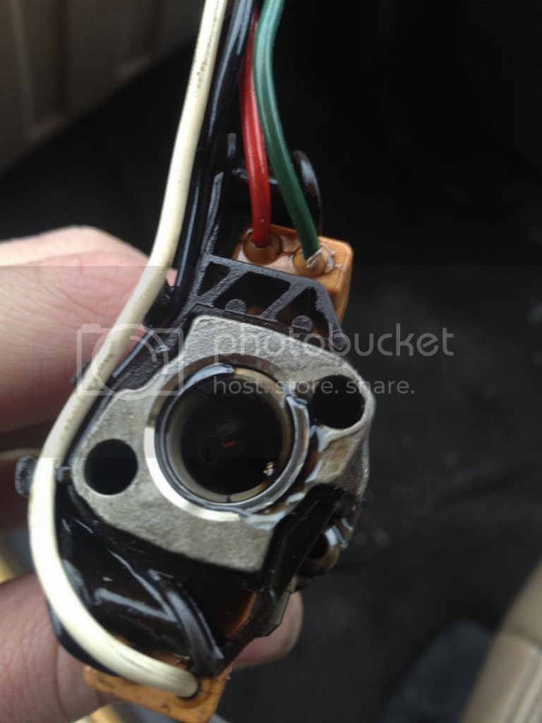

Well put all new injector seals, o rail nipple cup seals in it and it started. One injector was really toasted and I'll post a picture of it here in a minute. So I had to buy one new injector but the others I was able to replace the seals and get it to build enough pressure. After I started it and it ran. It would smoke thick white smoke for awhile but do it less and less each day then about a week after I got the new seals it died on my again and now is doing the same thing and only building about 40 ICPs when cranking. Going to air test the system and am looking for any advice on air testing. I know about 140 should be able to find a big enough leak to keep it from starting but I am not sure which is the best location to do the air test at. Either the ICP Sensor on the passenger side rail or the IPR Valve. I saw the IPR Valve air test tool but couldn't tell what you used to connect your hose to the tool. Was it barbed or quick connect?

Update. I pulled the oil filter and held the drain plug down. The housing seemed to fill pretty quick. The oil pressure on the gauge seems to fluctuate between the top of the L and bottom of the L when cranking though it never builds to normal oil pressure while cranking. Even though the pump is good. Could the regulator still be bad and that's whats causing a no start
