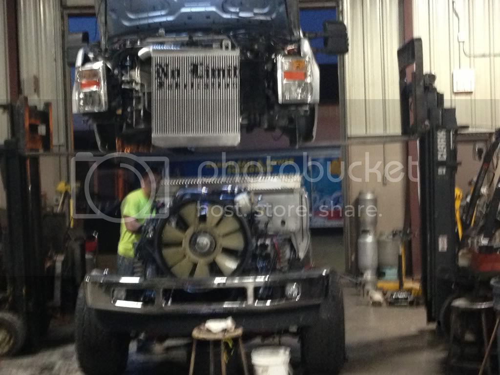

Well took it for a drive today. Seams good few small issues. Mainly the downpipe hitting the cab. So tomorrow I will finish butting it all up and drive it more and play with the gates more. The big charger is LOUD I love it. Runs good so far.

It pulled so hard. Till 43 pounds then it would just stay there since backpresure = out. The big turbo sounds amazing. We found the passenger up pipe moved a ton. The looked sealed but 2/3 of it was not and had a .015" gap. So we fixed that. The cab is down and ill get it running again tomorrow.
