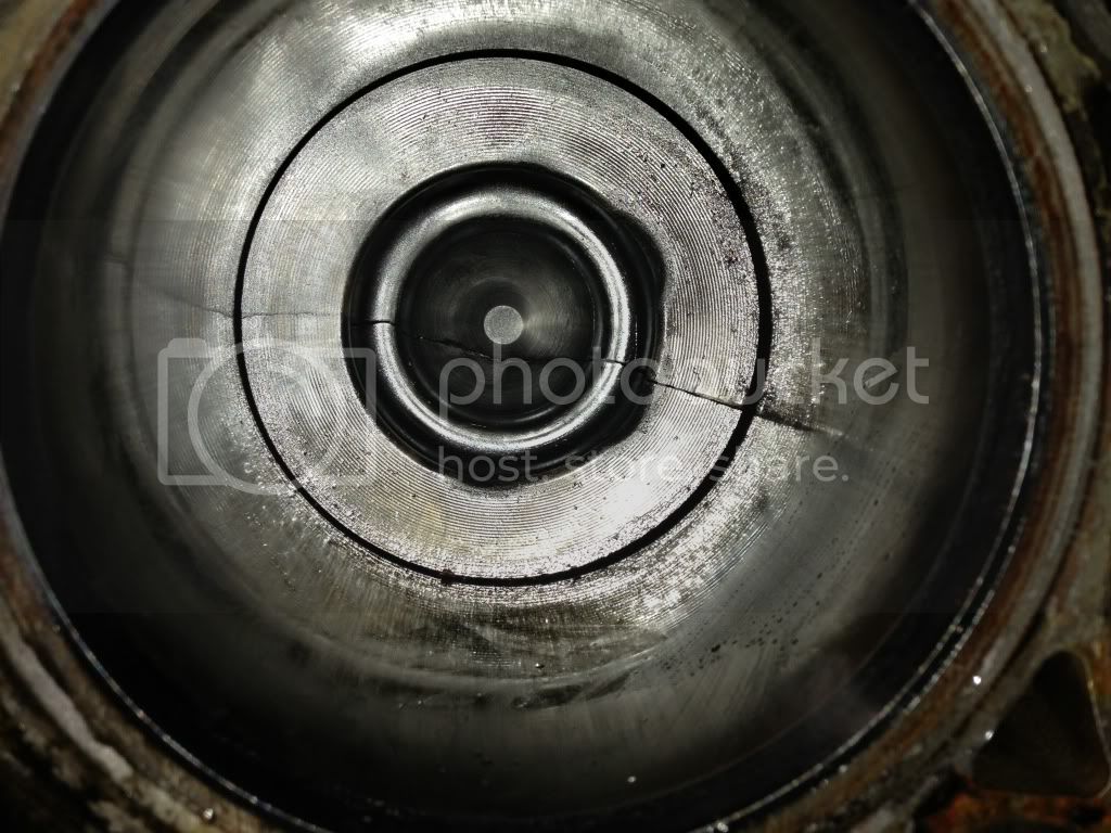

saw on facebook you cracked most pistons in the truck. whats the plan for the engine? fully built?

I only have a pic of this one #4 it's cracked trough to the wrist pin. There is one melted pretty good and all the rest have small cracks in the bowl lip.

That sucks. But I guess you can't complain, they have held up to some pretty good abuse. What are you plans going to be for it now? Small build with some HD ones, or still up in the air?

O yea the heads are cracked also. I'm doing Rudy's ultimate HD pistons coated. With Oem rods and arp bolts and I have a set of good heads. It should be back together in a week or so.
