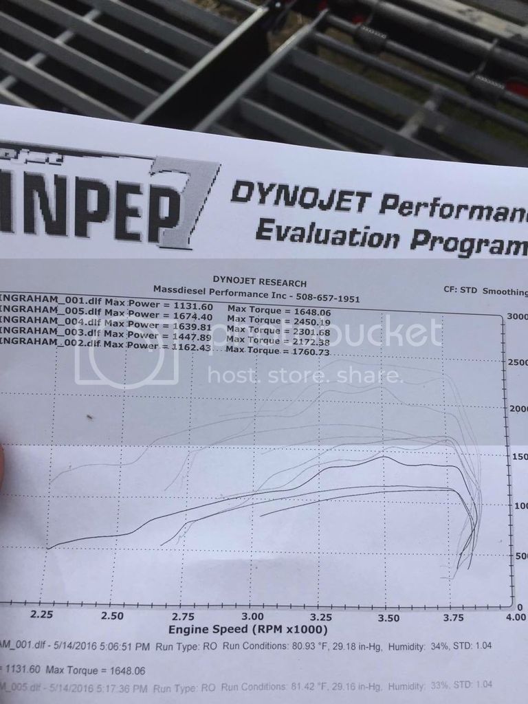

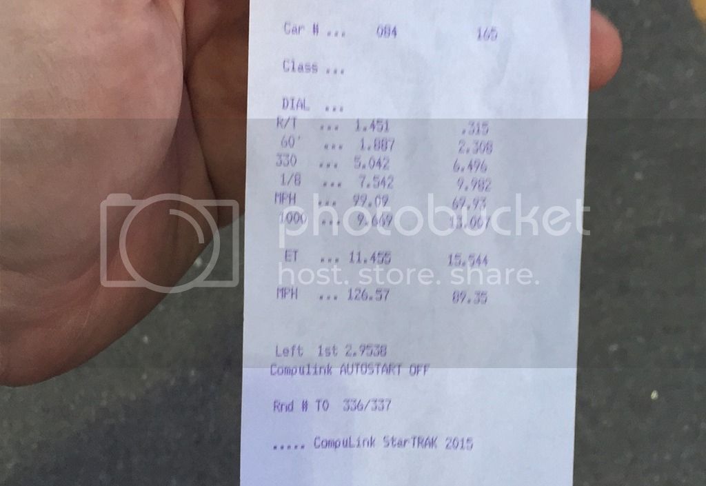

Well I should update this a bit. During my last trip home I changed all the fluids in the truck and finally installed the trutrack in the rear. Also installed a set of 325 Hoosiers in hopes of bringing the 60 foot down to to a 1.4-1.5. Got it to the track and blew a brake hose at the line on my first run so only achieved a 11.99 at 126. Got it home, changed the brake line and took it to a Dyno day where it put down 1674hp with the help of Tyler from sdp ghetto fogging it. Overall I'm happy with the trucks performance, and look forward to getting some weight off of it and hopefully get it deep into the 10's. Before another run at the track it will need the heads removed to see what is causing it to push so much coolant out of the degas tank, i was told it got o-ringed heads but we will see. It will also get a progressive controller for the nitrous Along with a bottle heater.

Nice numbers! We're any of the numbers fuel only, or just different amounts of spray?
I think that dyno was a wee bit on the high side. Congrats man !

well aware of that dyno's reputation. I will be focusing on track times in the coming months. Breaking into the 9's is the goal but a lot of weight needs to come off for that to happen. seats will be coming out for race seats and a 8.5 cage and eventually the rear will be back halved with a 4 link set up with either steel or fiberglass bedsides.
