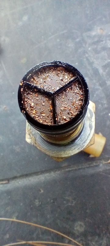

I only use oem parts. So finally got around to looking at it. Been sitting a month and took 25 seconds to build enough pressure to move gauge on dash and then finally fired. I pulled the ipr, had some ferrous metal shavings, not much, but a lot of brass material on screen. Any ideas? Thinking i need to look at hpop and lpop and check them.
Ipr was at 64% when cranking.
Ipr was at 64% when cranking. View attachment 187281
Sent from my SM-S134DL using Tapatalk
Well that don’t look good. Get a manual oil pressure gauge on it, it may be taking too long to build base pressure before it fires.

Where else could the material come from being brass?
At this point i am gonna swap out the hpop cause i got a spare. Ill pull cover and probably replace the lpop since its building slow as well as change oil cooler and check that screen too. Do an air check on the system.
Was running good, but forever cranking, worse cold than hot, just doesnt seem like it has as much power as it did and the motor just doesnt sound right. It stumbled towing up a mountain and then ive had trouble ever since.
Any advice would be helpful far as what it could be.
Powerstroke Cowboy
4,393
157
Montana
There is a brass plunger in the oil system for the oil cooler bypass valve. Could be the oil cooler.
Also the HPOP does have brass internal components.
There's also the bearings in the turbo. But, you can rule that out.
Check your hpop reservoir screen to see if it has brass shavings on it as well.
