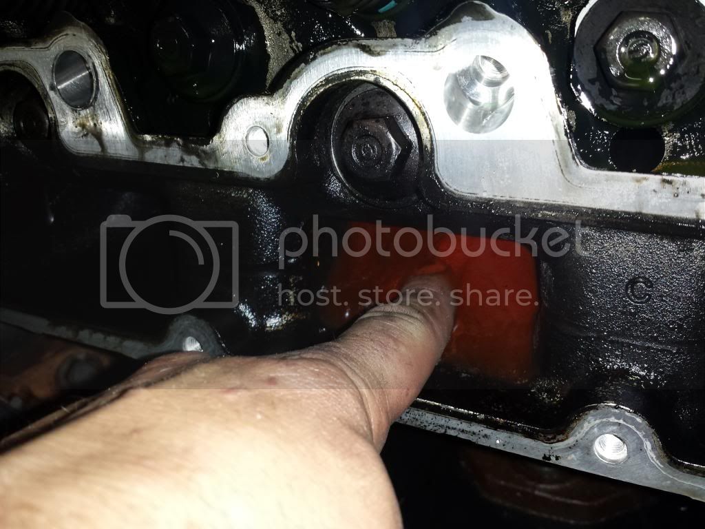

Then found this and initially thought it was oil, didn't taste sweet. Time to pull the charger to see if it is pre or post turbo.

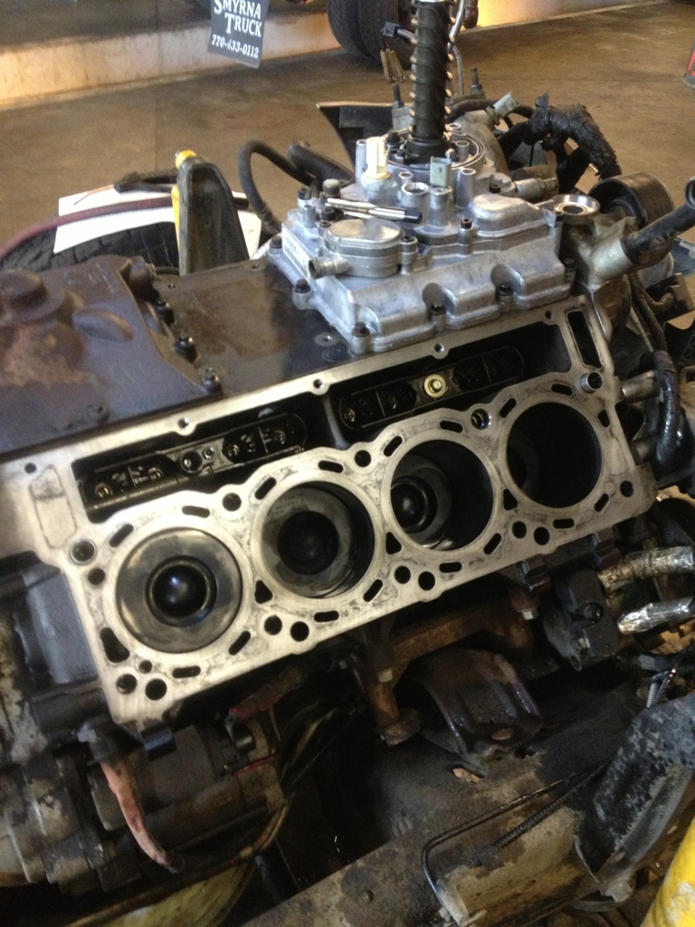

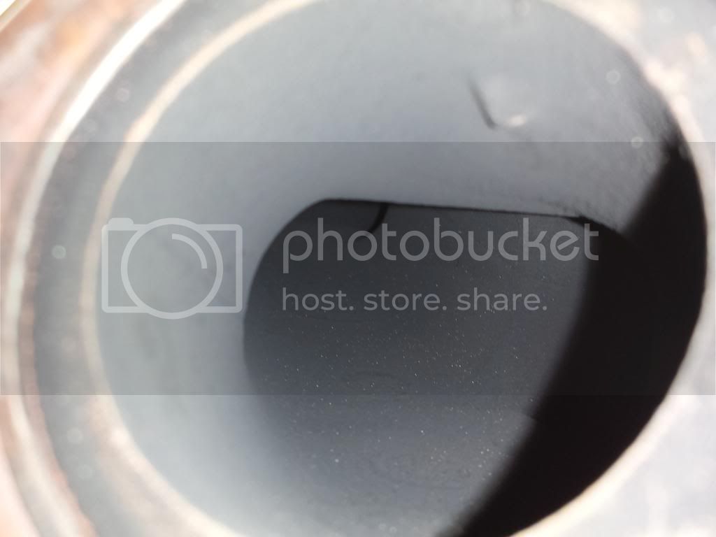

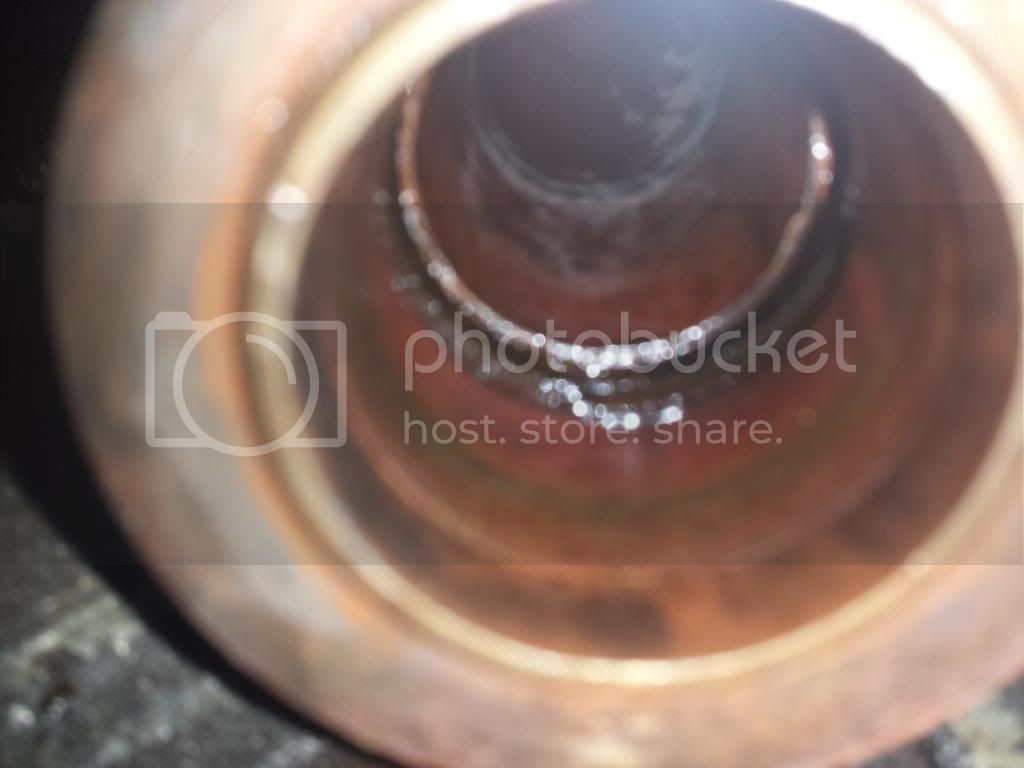

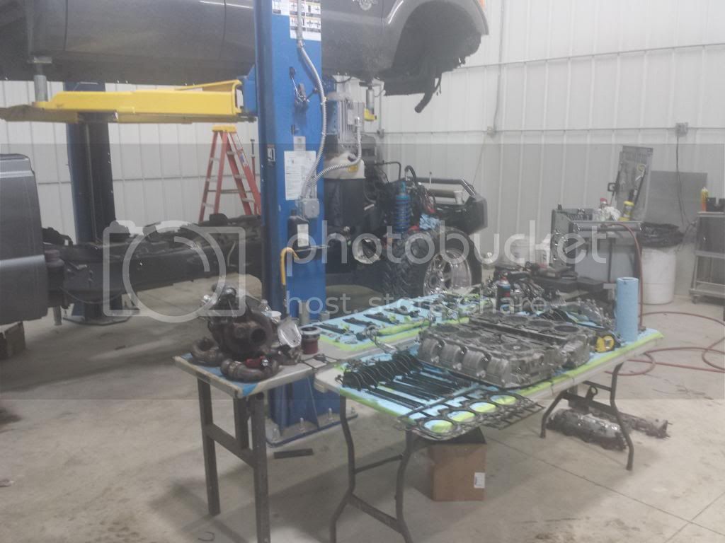

Found my answer. Wet inlet with coolant on the drivers side turbo inlet. Moving into a pre turbo problem. Got the approval to pull the cab and begin getting the heads off.
At this point it was either a cracked wall, or head.

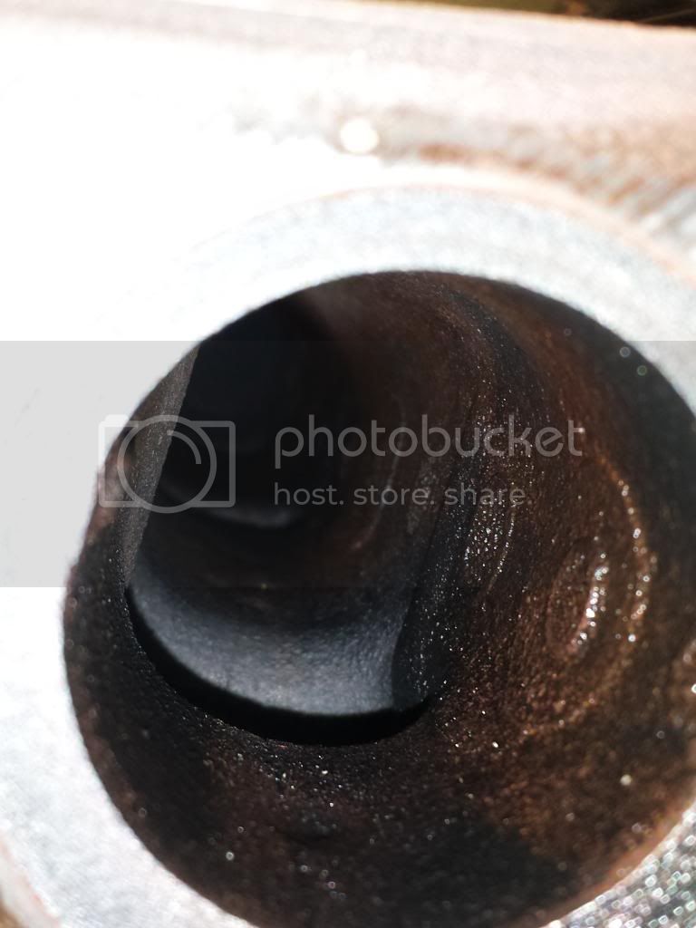

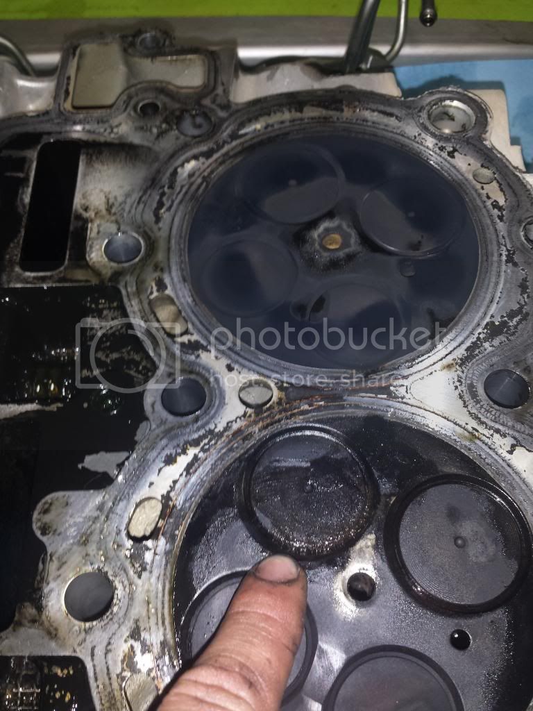

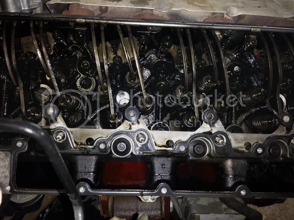

Drivers side. Coolant sitting in the intake port explaining the intermittent startup with steam. Depending on the valve position of that cylinder after the engine was turned off.

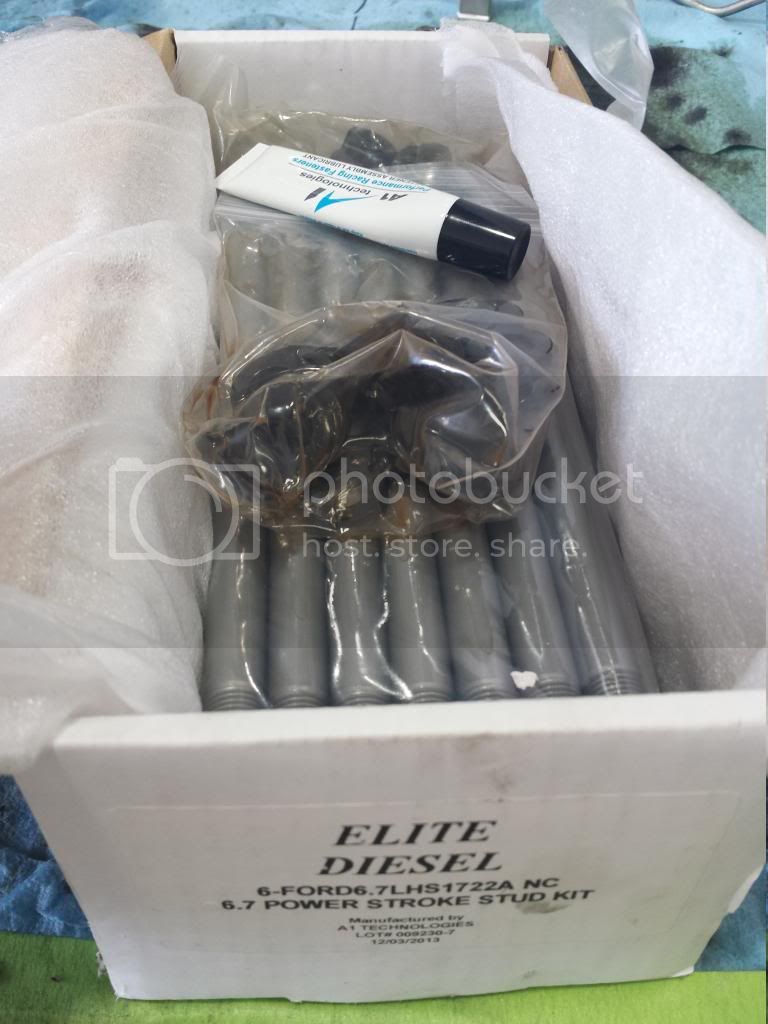

Elite shipped out a set of studs immediately as well.

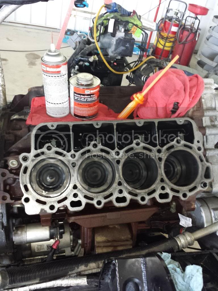

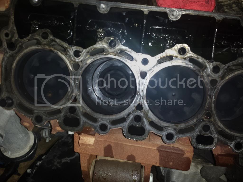

Properly cleaned deck. Note you do not remove the block stains.

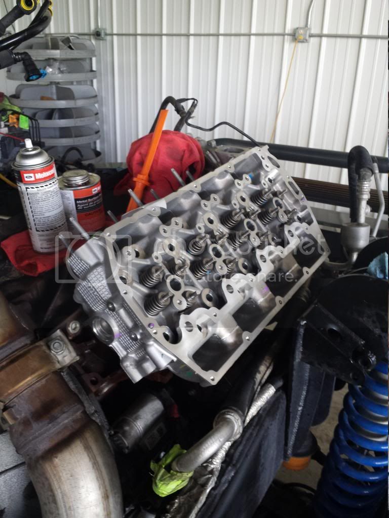

New heads going on.
Torquing the studs once to 50ft/lbs, loosen, another time to 50ft/lbs, loosen, and again to 50 ft/lbs, then 85ft/lbs, then 125ft/lbs. Freshly calibrated Snap On TW.
Checking the valve train after install. This video does a good job of showing how the spray bars work, and their oil path.

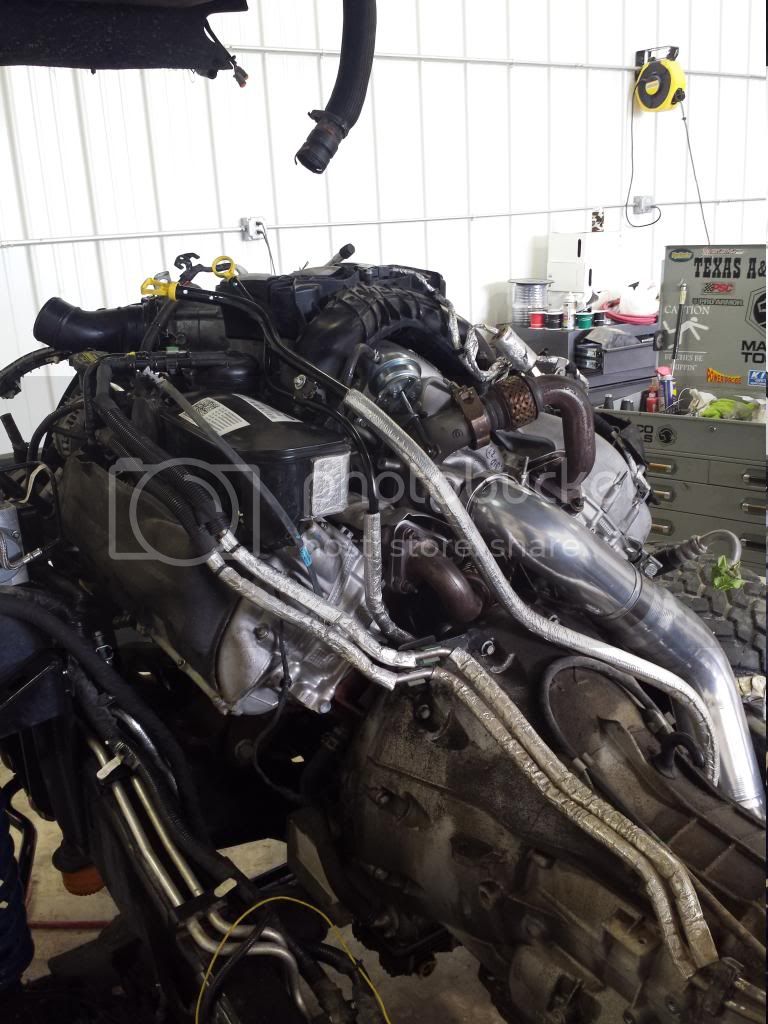

All back together, problem solved.

New heads going on.
