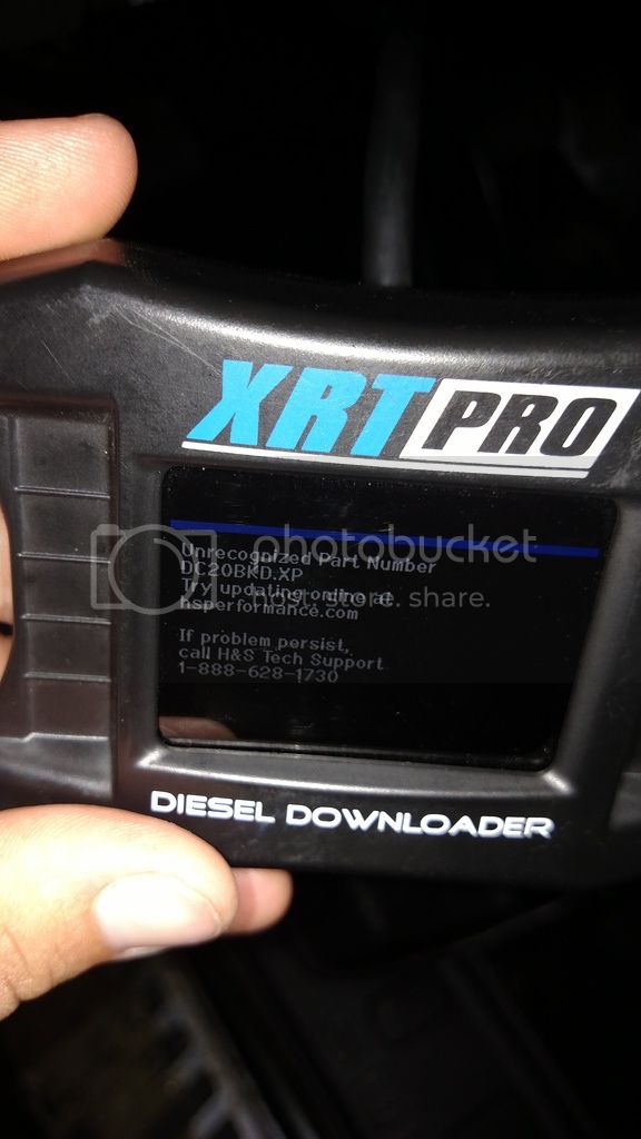

I have a used XRT Pro that came off of a customers truckthat was a 2013 and selling it to another customer that has a 2013. It won't recognize the new truck even though it shows support for 2013-2014 6.7 Ford. Here is what it says. Is there any way I can update it for it to work on the new truck?

Yea I would if I had ever run into this problem before. Also wouldn't be a problem if it wasn't Christmas so I could make a phone call to some friend but didn't want to disturb them during the holidays so I figured I'd post here to see if anyone knew why it won't go on this 2013 when it came off another 2013.
the XRT is missing that file, what is your email address? I have the file I can send you.

Yes, you can update via the H&S website.
Ford has released a TON of tunes just in 2015 alone. If the truck has seen the Ford house this year, your update files from 2014 are probably out of date.
