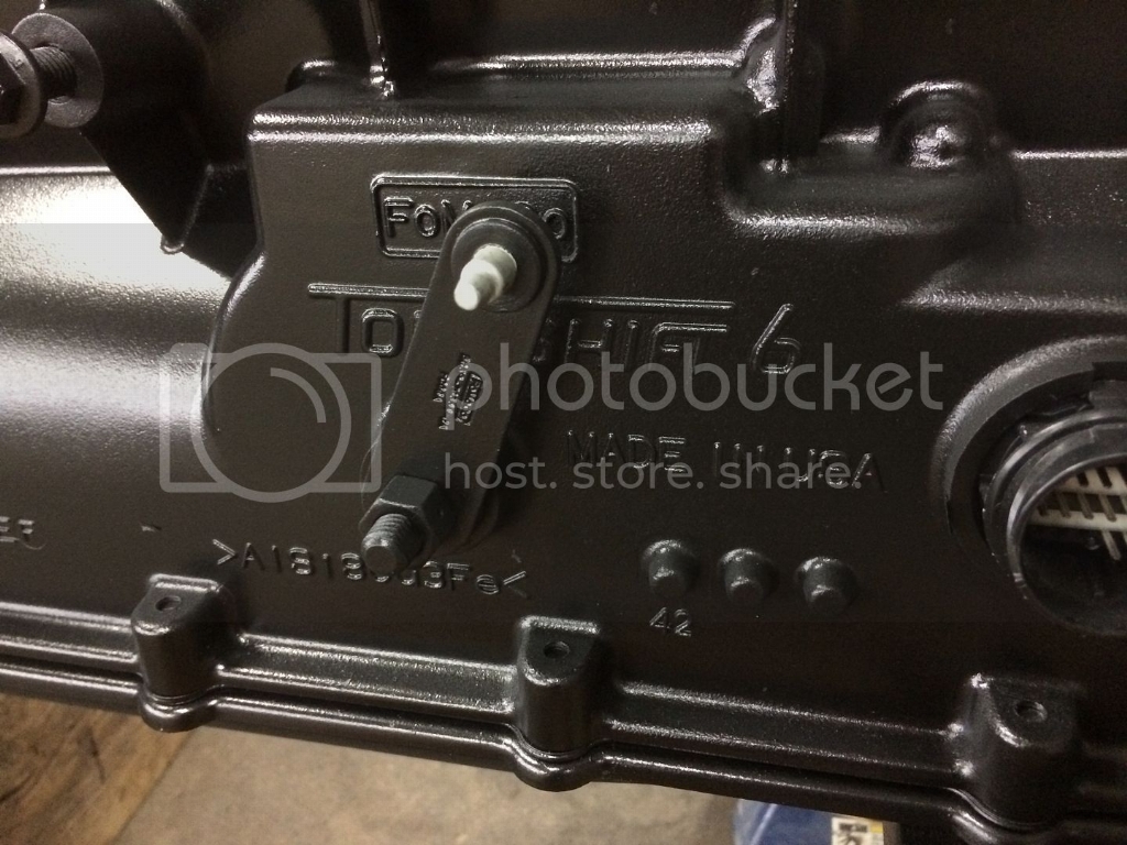

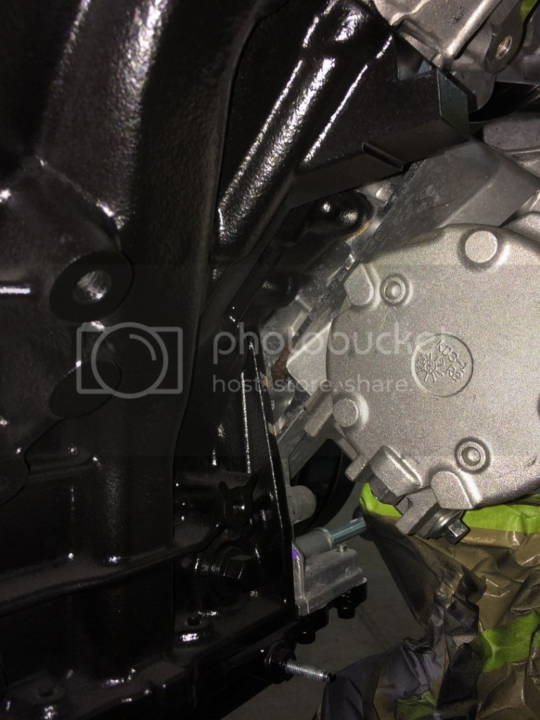

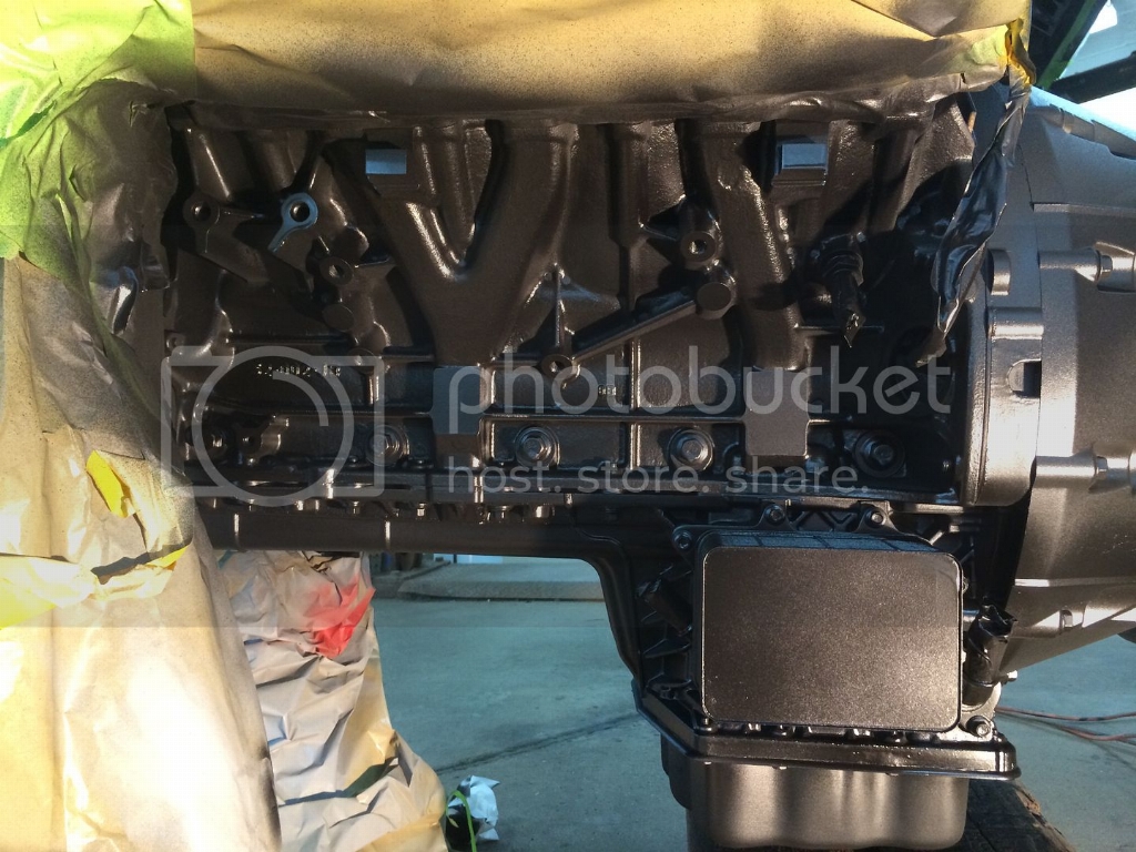

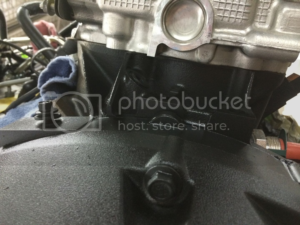

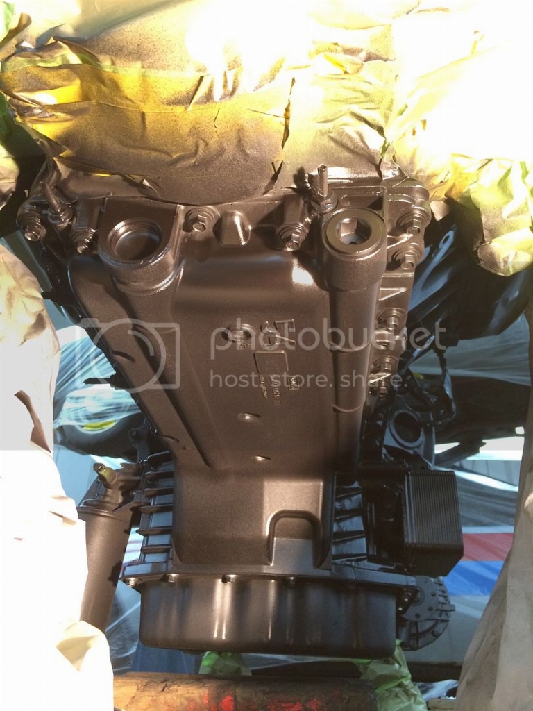

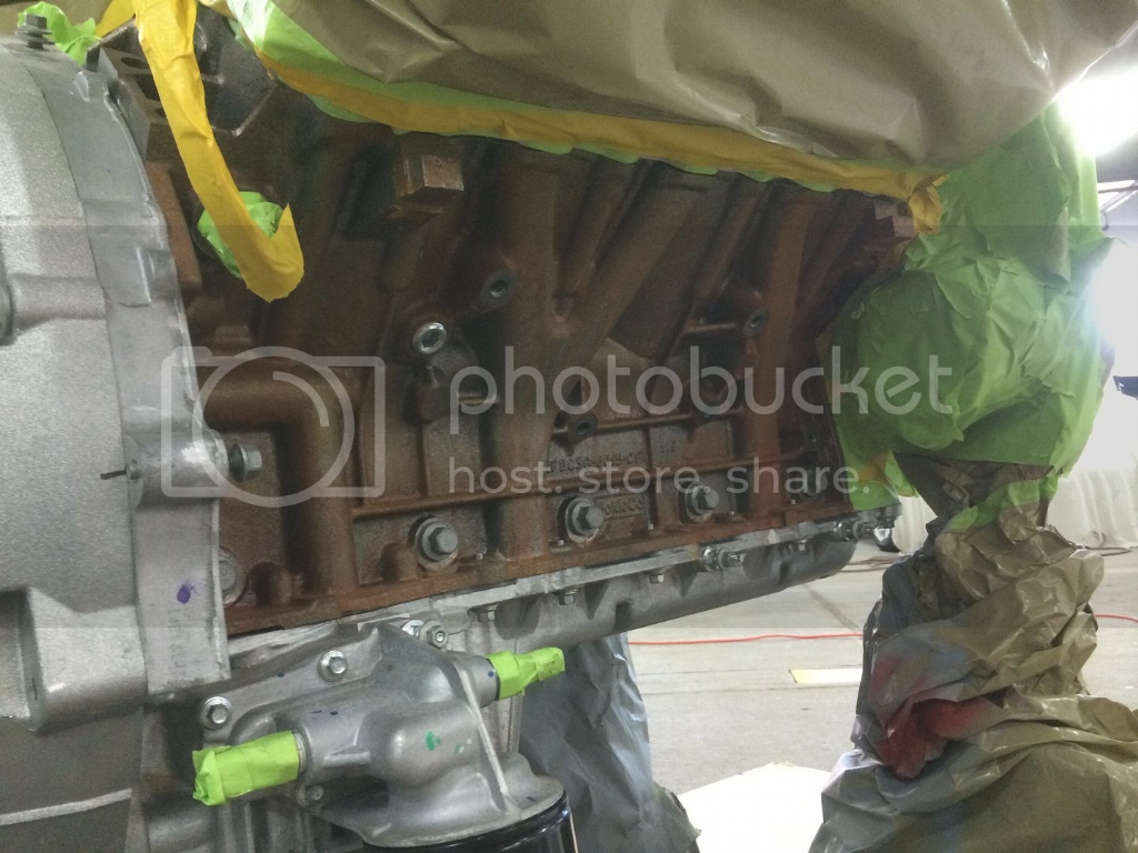

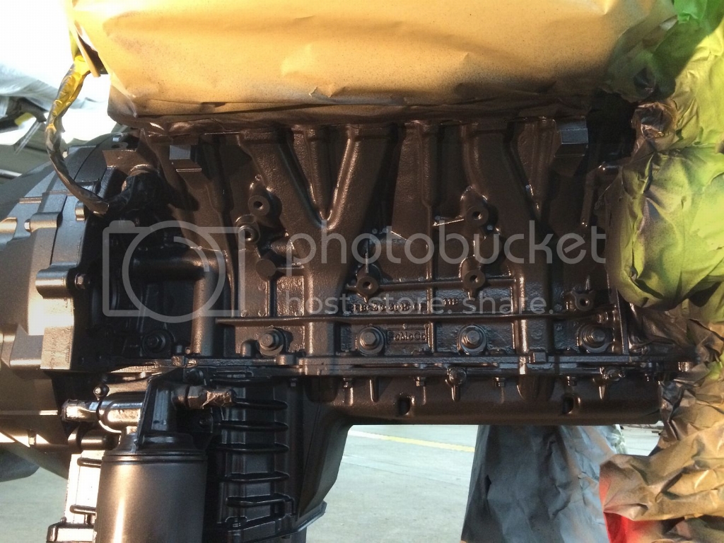

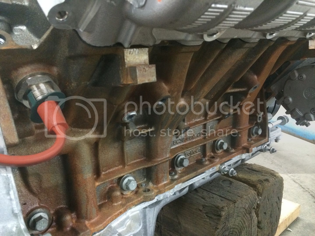

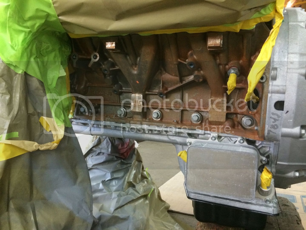

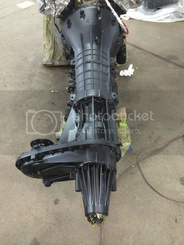

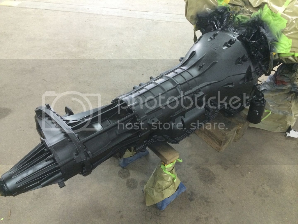

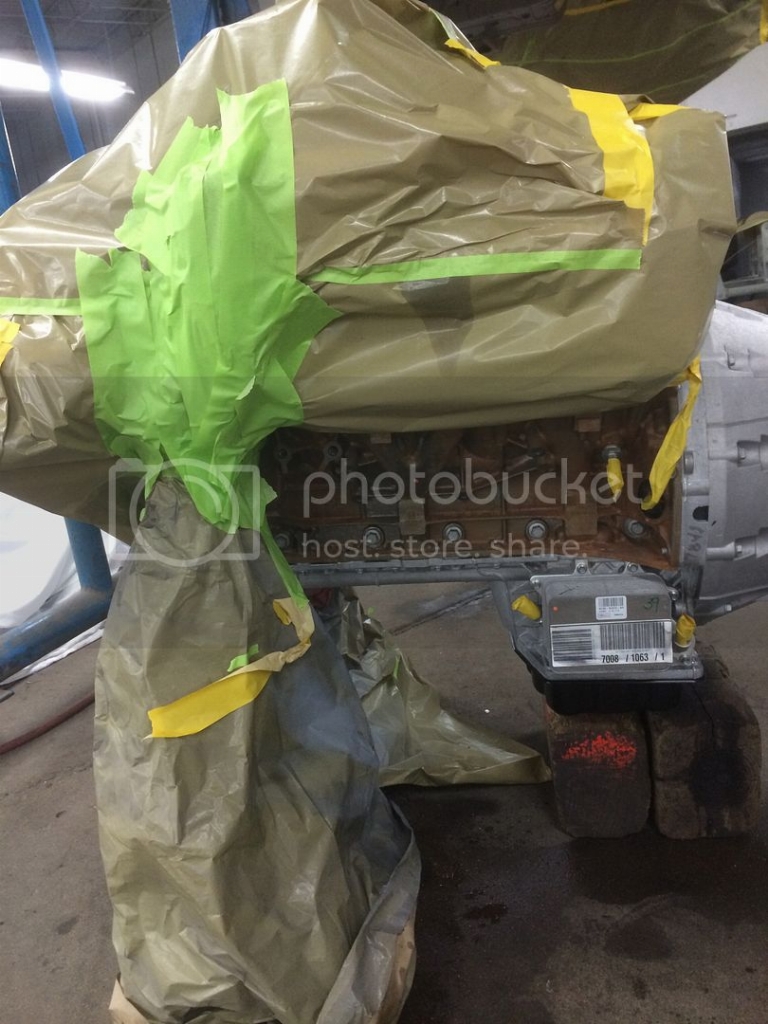

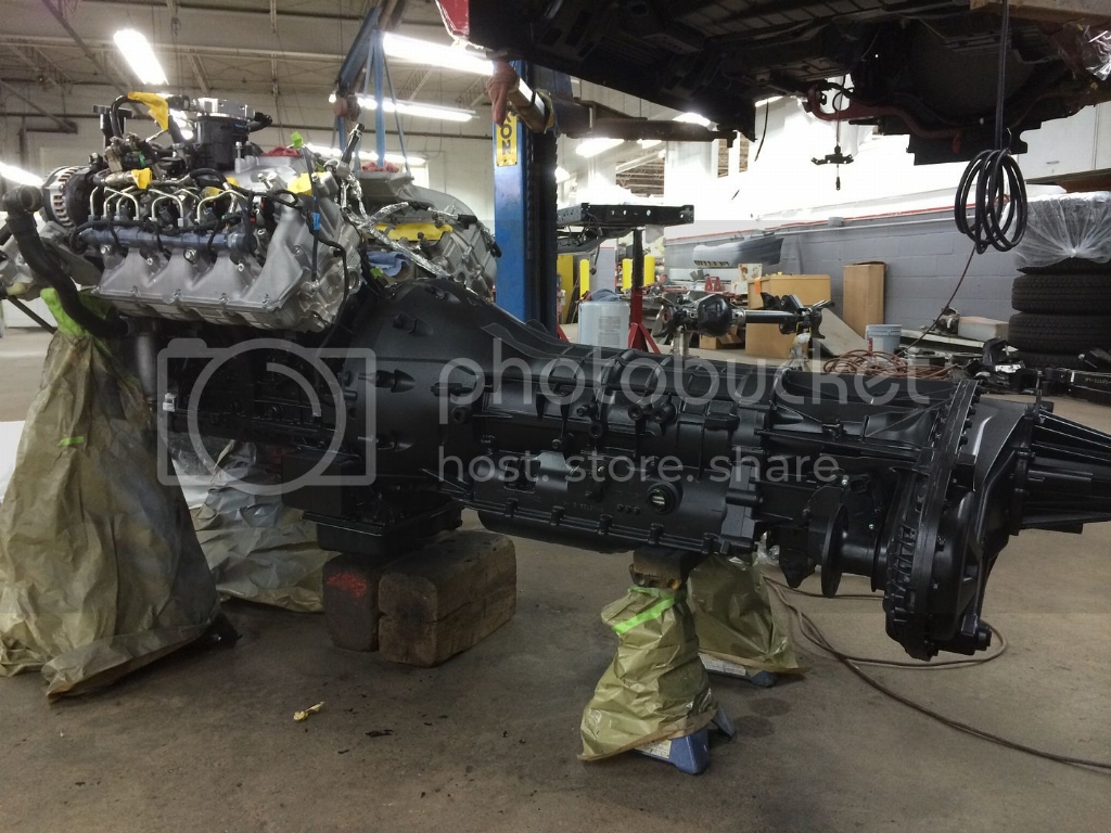

It was time to clean up the ugly looking engine block, figured for good measure we best spray the trans/tcase. Didn't go real crazy on this. After all, 90% of this work you won't be able to see.

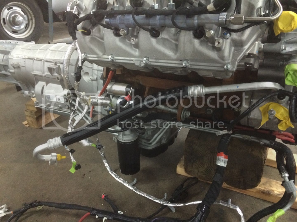

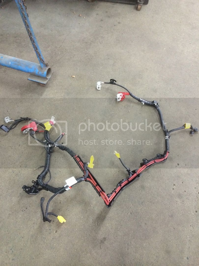

Main power/ground distribution harness, this getting stripped and remade with 1/0 wire in the appropriate areas.

I vote Ruby Red valve covers :poke:
:lame:
I had to stop myself at this point, see that frame in the background? Doesn't look anywhere near done to me, lol. So much work, so little time. I do feel like I sold myself short, shoulda pulled the heads, rails, covers. Smoothed them all and sprayed them red.

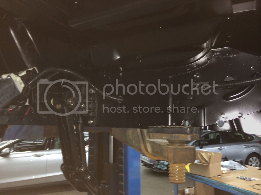

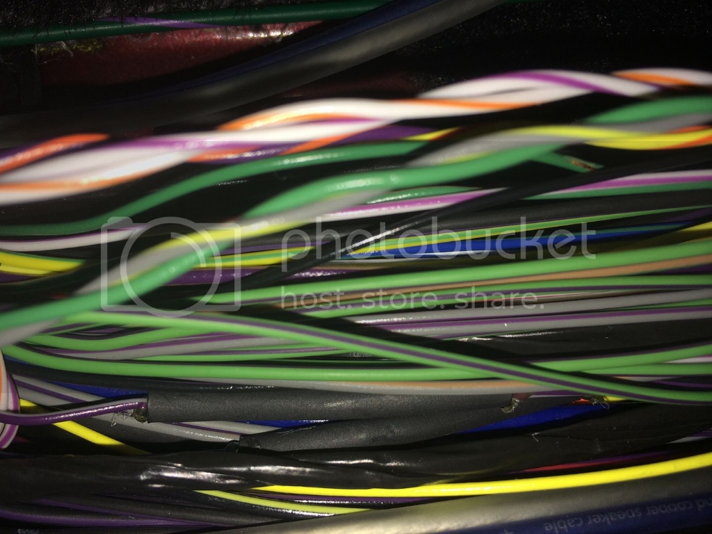

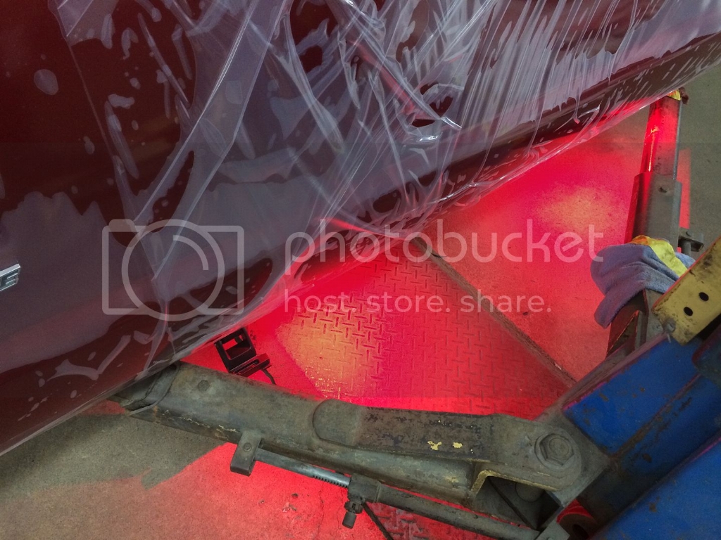

I had a little time between projects so I decided to wire and install the Amp Powersteps as far as I could. I hid the wires and control module as much as I could, wiring is over the top time consuming. Since I relocated the control module as I refuse to zip tie it to the battery area like the instructions say, I had to lengthen and shorten the harness in spots. Wiring the trigger wires into the door ajar wires proved to be a task. I think I counted 11 green with purple striped wires in the bundle. Needless to say after much frustration and a multimeter all the correct connections were made.

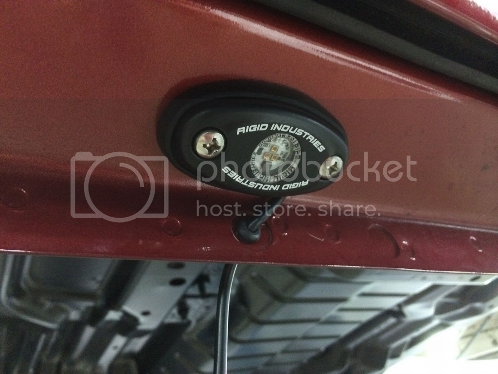

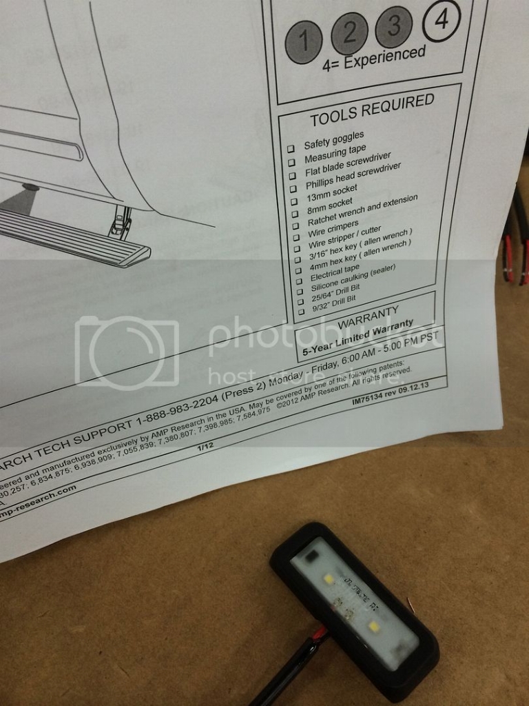

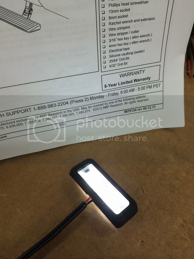

No offense to anyone but the included lights for the power steps are rather pathetic. They probably work well for normal use but I threw normal out the window long ago,
Like Josh says, rigidsoneverythning. These should work a lot better than those weak included lights.
