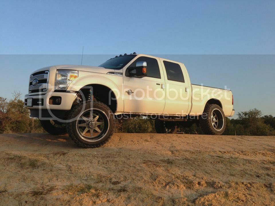

sno-x139
Jun 24, 2012
39
Does no one remember coltons platinum? 24x12s/37s on 4.5" lift IIRC? Yeah he had to do some cutting but it's ****ing sick.
