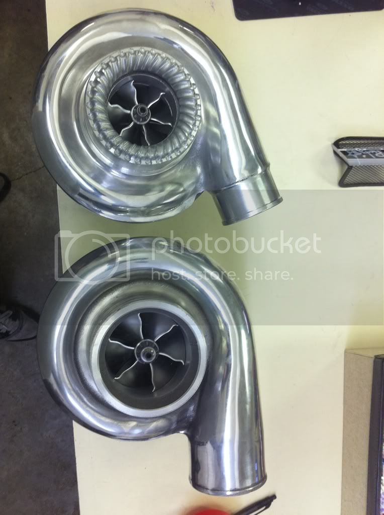

Just pictures for now, should be done in a few weeks. We will keep everyone posted as we progress. These will both be in the valley.

I would say the 75mm is an s400 frame. It appears to have a vbanded exhaust housing, rather than bolts like the s300s, and as far as I know, they don't make an s300 with a 75mm compresser. Supposedly a 66mm is about maxing out the s300 frame.

I know I have seen S372's.
And going by Rudy's above post they are both S300's.

No they keep going into the 70's, S372 S375 and so on. They are both 300 frames but there are also larger bearing sizes and shaft sizes in that series as well. A 400 series is much larger over all.
to fit in the valley ... im sure they have to based on 300's.
